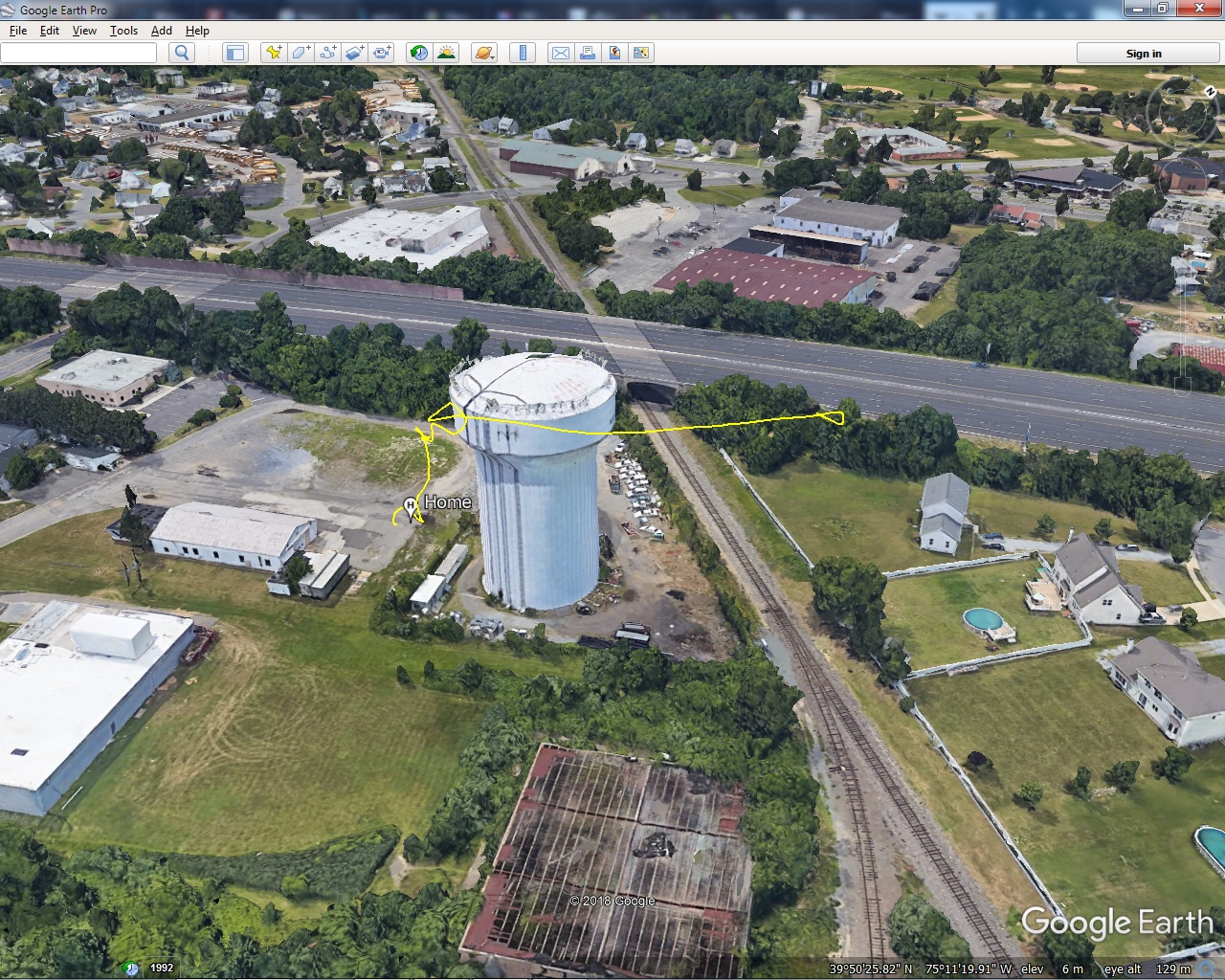

Put a mark on the picture and post it back on the forum, where have you found the battery. The searching circle for the drone cannot be very large if the bird has lost its powering.
That's a very terrible picture, because it makes it look like the drone was last over the trees near the highway. When in reality, the drone was last over the power Box just to the right of the water tower next to the train tracks

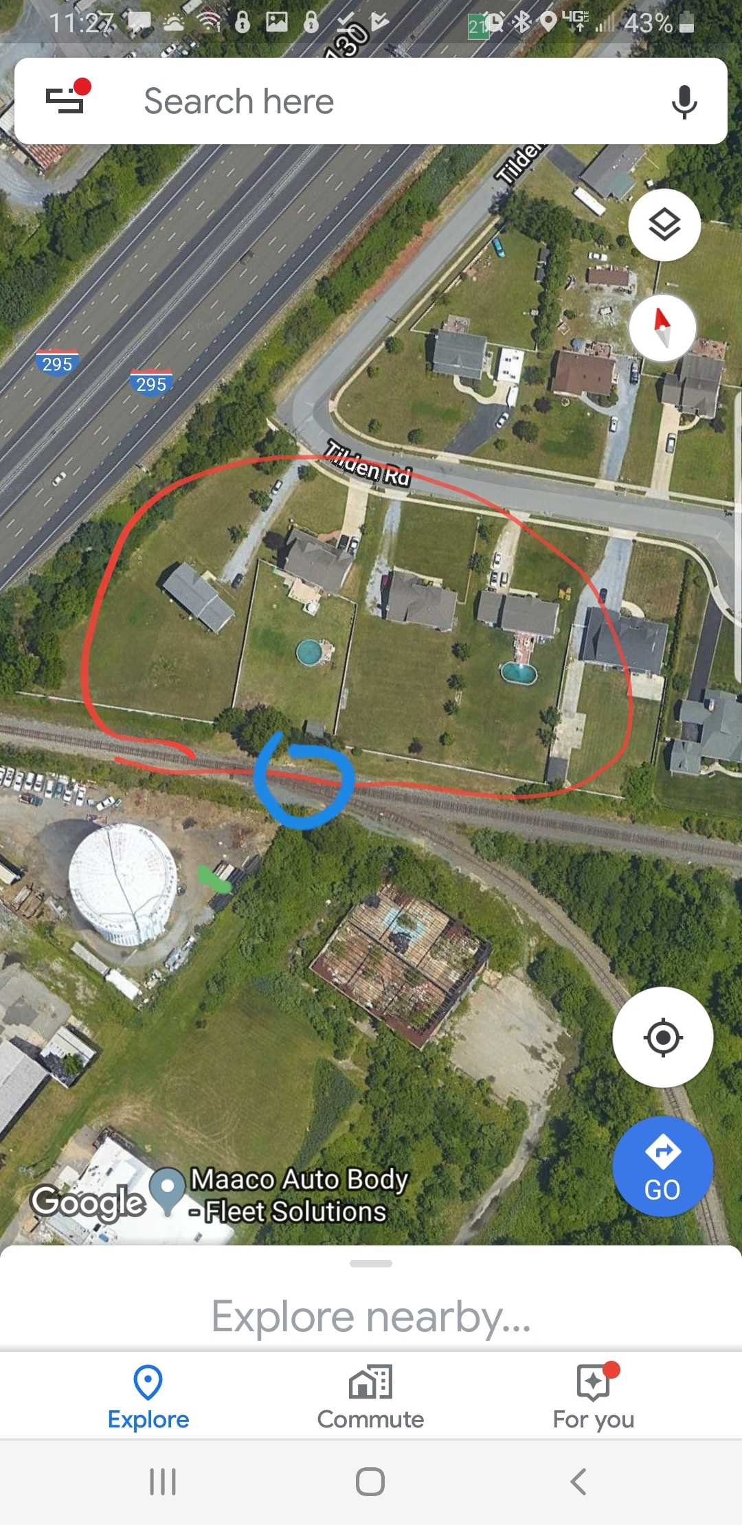

The blue circle is the last GPS coordinate. The green.is where I found the battery. I have searched the entire water department fenced in area, the abandoned building just to the South East, all 4 yards, Up-and-down the train tracks, and the last 2 wooded areas. The only place I have not been able to really take a good look, is the top of a tower
