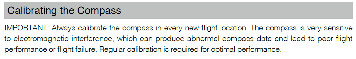

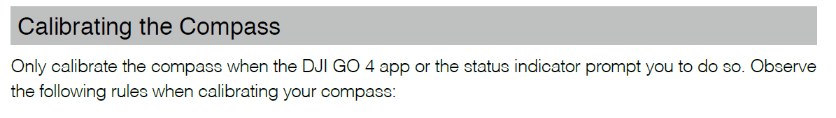

I'll have to hunt down a copy of the updated manual.
Save you a step or two.....;)
Reactions: smackc4

REALLY? - I didn't know that... I'll have to hunt down a copy of the updated manual.
I just figured it safest, so it knows exactly where to return to home! (& not the last location it was calibrated at, which in my case can be 100 kilometres away!)...or where I live a few miles away.
From your post, it seems you think that RTH needs an accurate compass reading to return home. This is wrong and right at the same time: it's wrong because RTH is a GPS-based functionality, with the AC knowing where it is (current position) and where it needs to go (Home Point). It is right because the AC needs to know which direction it is facing, in order to properly navigate back to the Home Point.
Minor compass errors won't affect RTH, as the flight controller would compensate for them exactly as it does if there is some wind.
Reactions: RodPad and smackc4
