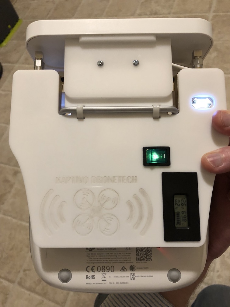

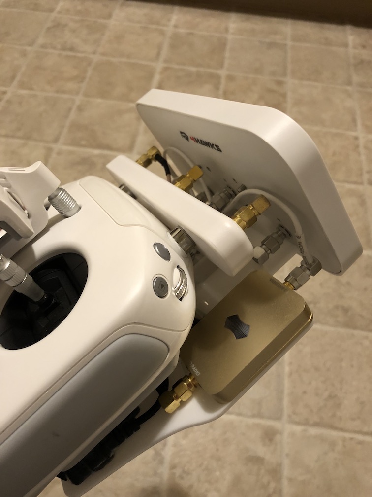

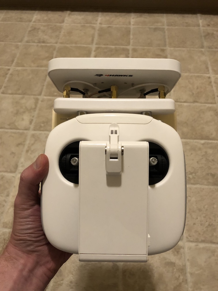

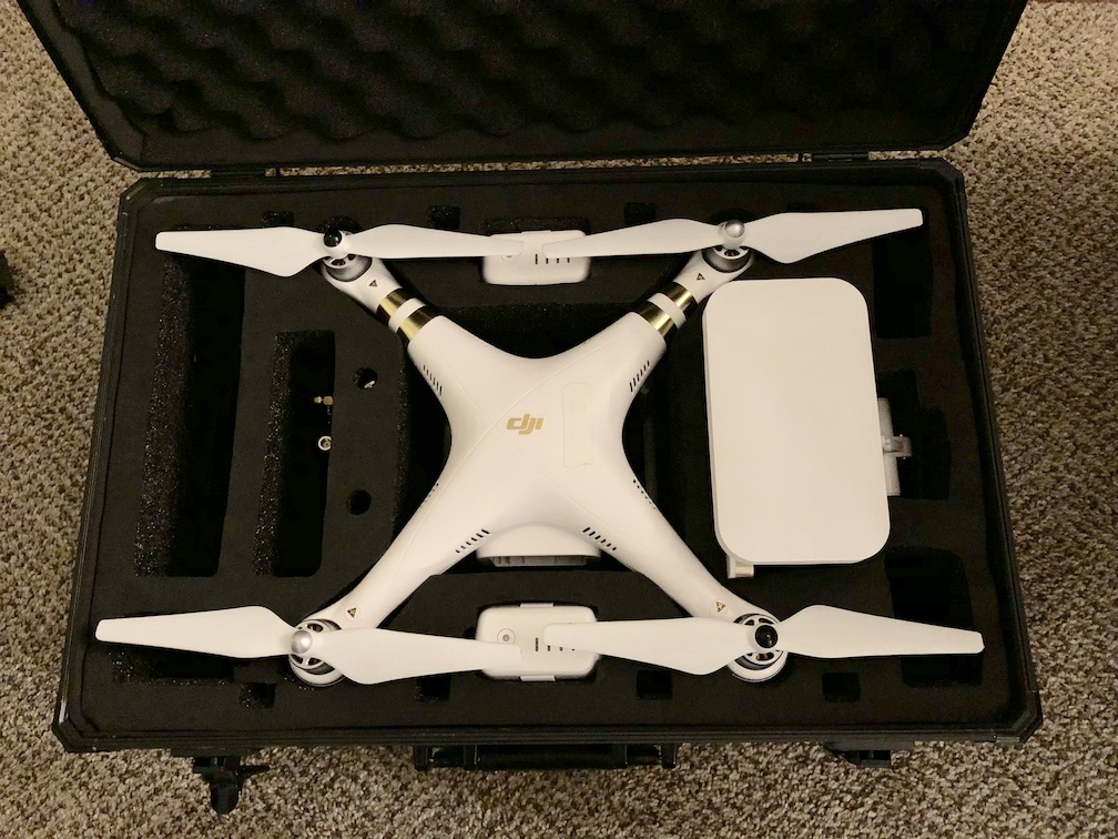

Since people are talking about their amplified set-up I thought I would share mine for the Phantom 3 4K (although a basically identical set-up would also work just as well for the Standard). My objective was to get the longest range possible (rural and urban) in a minimal envelope - specifically, the RC needed to fit in my hard drone case which was designed to fit the stock RC only. Also, I wanted to make the RC modifications completely reversible, i.e. no drilling. And, the RC needed to be comfortable to hold while flying.
Starting point was the ARGtek three-SMA breakout mount, to which I added a 4Hawks Raptor SR antenna, which offers improved performance (9 dBi gain for 2.4 GHz, 14 dBi gain for 5.8 GHz vs. 7 dBi/10 dBi for the ARGtek antennas). Amplifiers are 2x 2.4GHz 3W Sunhans (measured output 32 dBm) plus 1x 5.8GHz 4W REXUAV (measured output 35.5 dBm). Battery is a 3S 3000mAh lithium ion pack from REXUAV which powers the whole set-up for around 2+ hours or 5 flights. I also included a battery monitor to give me voltage/current and % charge remaining read-outs continuously while powered up. Mounts are my own acrylic laser-cut design, made at a local shop.
Set-up runs both 2.4GHz downlink and 5.8GHz uplink in FCC mode, on channel 13.
Achieved range is to the limits of the battery in an open environment (20,000ft out, 20,000ft back) with no measurable signal degradation, and around 12,000ft each way in an urban environment. I have excellent eyesight.

WOW! That is, as an old fellow worker used to say; "FULL-ON!" :-)

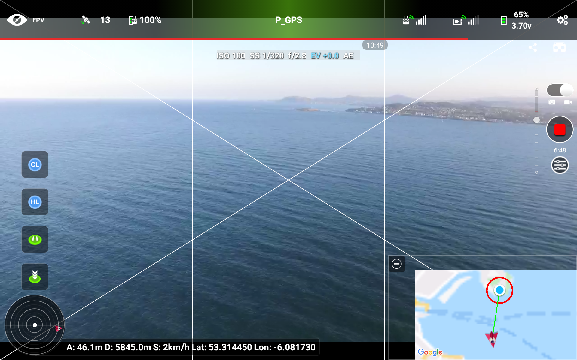

5,845 metres or 19,176 feet distance one way with return distance of 11,690 metres / 38,353 feet. Phantom 3 Standard gets better all the time. Landed with 25% battery. Covered distance with an attached payload dropper device

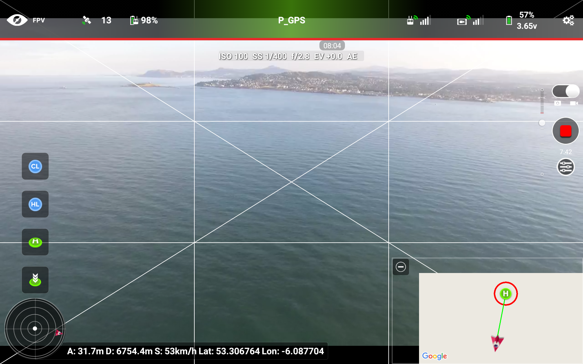

6754.4 metres or 22,160 feet outbound and 13.51 km / 8.39 miles return - landed with 8% - won't seek to best this

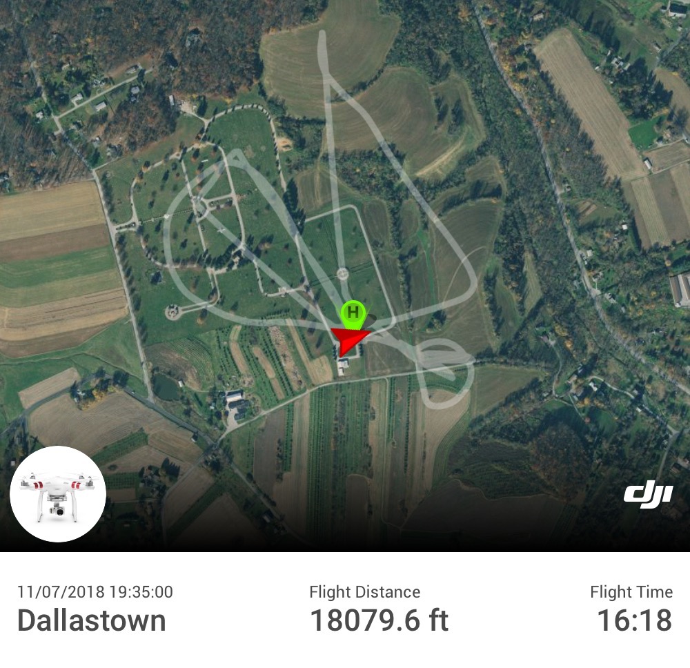

holy crap, my max distance is only like 2270ft before RC signal lost, hence the top line in my flight in this pic below, what program is that your running litchi ? or is that a new fancy DJI go app, RohanM that antenna in your profile pic, what is that thing, and are you a P3S ? if so can you provide a link where i can get that thing?! now my video signal was rock solid all the way, it actually outlasted the RC signal, i swapped back to the tall stick ArgTek one and got better range, but only by a few feet, and being omni, better signal when i lost sight of it over the hill there. my altitude was about 250-300 ft,but it dropped to 150 as that hill at the top of this pic is about 150ft tall from my launch position. as i stated above in my pre posts, i fly in cemetery so i feel safer, and can see more, and less interference signals. i take it my max distance on this pic is the cumulative result of the entire flight, but it was only like 16 mins. low battery warning kicked in at 30% and landed with 18%
