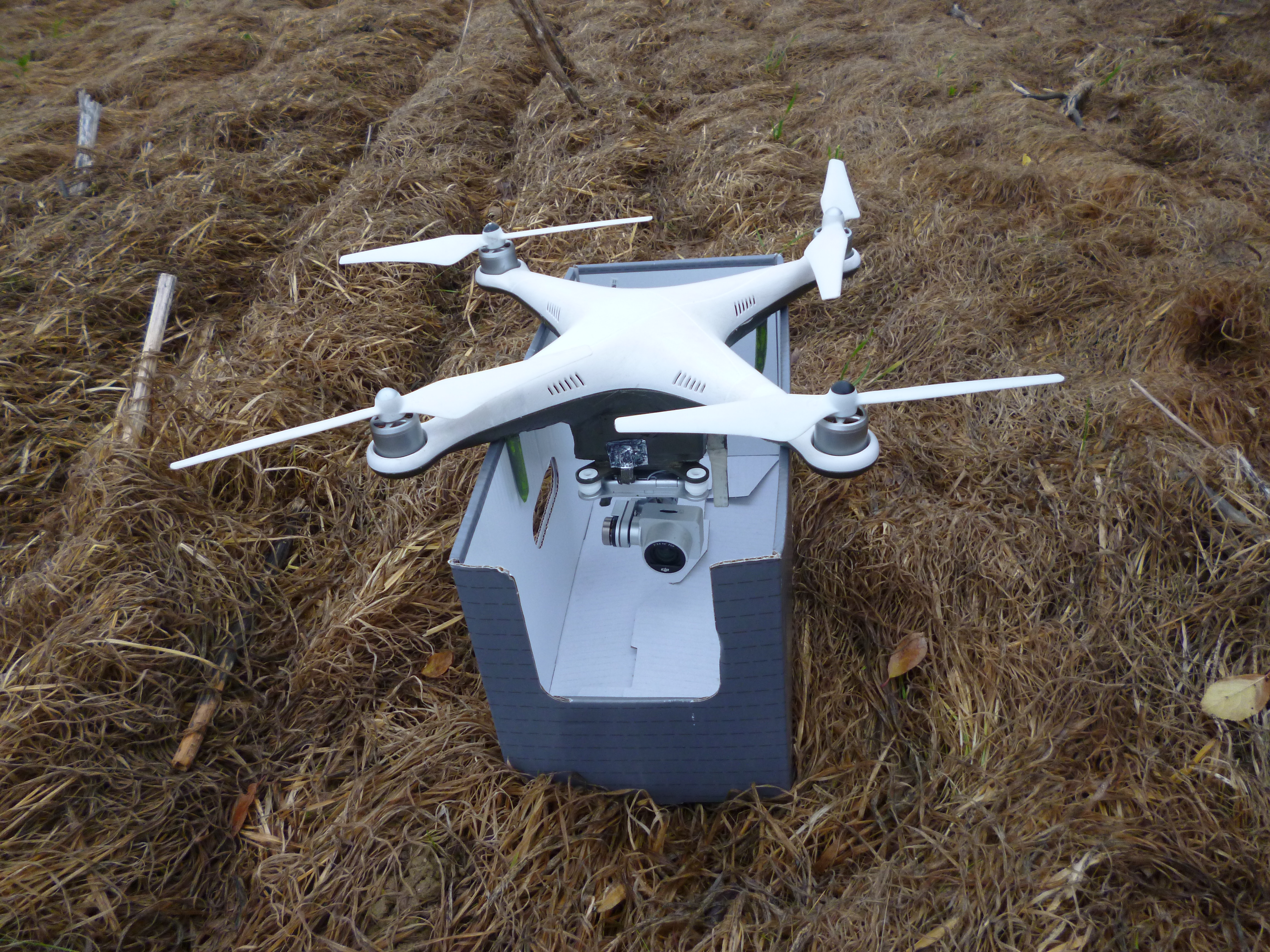

Hi shuggings
Thank you for your interests! I always loved to mod not for the sake of modding but for extra flying time. I fried the ESC's on a P3 pro and my 960 grams Mavic Pro sooner or later would switch to Atti due to magnetic interference triggered by higher magnetic fields caused by high currents. I like the pro, not 2, but could not give me what I want. I want 30 min real world flight time, every time without draining the battery to minimum. The launch of M2 with basically the same flight time as the existing drones is a clear sign that DJI is not going to give me what I want.
Now about my P3S. 30 minutes? Not (yet) ****! ?
My target weight was 1280 g as P3A but doesn't look like I can get that light.
But it will get lighter than 1357g
What it can do? (wintery conditions) 8 degrees C
In a very calm day flew 20.1 km - Litchi.
Speed set close to max, towards next waypoint, back and forth, straight lines (stopping at each waypoint) Battery 16 % on ground, carbon DJI props.
Or manual GPS flight, looking for the best shot around sort of flying, 18 and a half minutes with 65% battery starting down to 14 % landed. Still 7 to 8 degrees Celsius but a bit more wind.
It has no landing gear and the core is the battery pack. 2 p3 batteries from where the 8960 mah is assumed, one battery has no smart board and the other one has the plastic case removed
I want to make a YouTube video but had no time yet. I have been too busy with the "development" plus that my wife doesn't like if I spend to much time in the garage.
