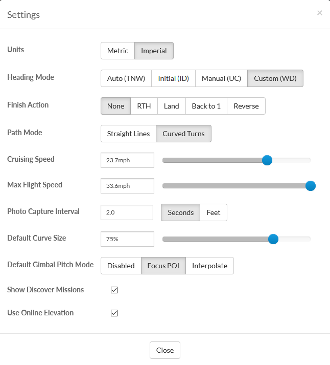

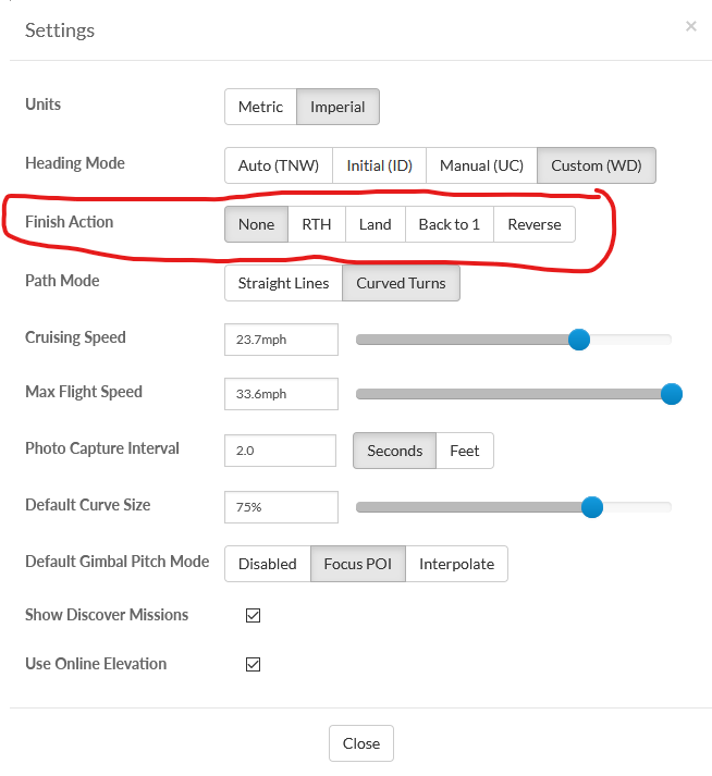

I have not observed this - I select "do nothing" on the Litchi mission hub, my drone gets to the final waypoint and just hovers there. Perhaps your battery was too low after the mission and had to land? If you check your mission log (on Airdata), you can find out why the drone tried to autoland. If you make your mission public, and provide a link, perhaps we can review your mission to make sure something else isn't up. Also, what model aircraft are you flying?
When I checked the settings, Jim, I had indeed selected RTH, instead of "None", as the concluding action for the drone to take on arrival at the final waypoint. I clean forgot that Return To Home, entails returning to the launch point GPS coordinates, but then also descending for a landing, so my getting caught unawares indoors with the sound of my arriving Phantom 3 S in full throttle-down descent mode, was a near-debacle entirely of my own making, and not due to any flaw in Litchi.
Before I discovered this basic error I'd been making, I readied myself to toggle the controller switch to GPS mode the instant the drone was close enough to the launch point, to be within earshot, so as to stop the craft in a stable hover while I scrambled outdoors to take control for the landing. That said, by simply ensuring that the "None" option is selected as the last waypoint action for every flight, I don't expect to see any un-commanded descents to land anymore.
I'm glad you found the cause!
And technically, it isn't the last waypoint that selects the Finish Action, it is the "Finish Action" selected in the Settings window that decides what your aircraft will do.
Don't forget that, if something goes wrong during the flight, you can always hit the "Pause" button on the RC during the flight (like if the aircraft is about to fly into a tree branch, building, or whatever). The bonus thing about this is you can hit it again to resume your mission where it left off if you like. Happy flying!
