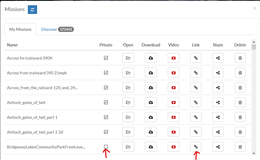

@Billie Nelson : how about sharing one of your hub missions - then we can have a look at your settings and make sure you have not missed anything. Make sure the "Private" box is un-checked, then click the "Link" symbol in the mission hub, which will open a new browser page with the mission loaded. Then just cut and paste the URL here so we can see your mission.

@Billie Nelson : just confirming, you are using the same Litchi login on both your mission hub computer, and on the app on your phone, correct? Litchi associates all missions with the login you use.
Yes this is correct, Jim. The same login password is used to access Litchi both on the iPad, and on the desktop.
