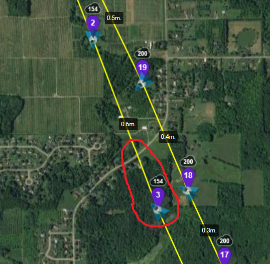

You didn't account for the surface elevation gain and flew straight into the woods. When you plan these missions you need to add 150ft to the elevation at each waypoint in order to stay 150ft above the surface. When you plan your mission on the computer(vs the app) the elevation difference will be displayed everytime you drop a new waypoint. See the box for the NEW waypoint 5 I set and notice the ground elevation reading below Altitude.
You also need to keep in account a rise in terrain, just adding alt. wont help if the curve upwards is not quick enough. Need to add waypoints BEFORE rise, not after. A gradual rise in altitude isn't enough to clear trees in between waypoints.
It looks like in google earth pro that after the road is crossed going from 2 to 3, there it starts uphill. A good place to start. Also it's a possibility it hit a tree before crossing the road but my guess is after the road was crossed and not far into the woods.
I think it's at just before point 3 to point 4....
That was very rudimentary advice given at the beginning of this thread when the OP didn't even understand that you had to add any altitude changes at all. Later I go on to explain that, where there is terrain change, I add waypoints in between other waypoints and adjust accordingly. Again, the comment you quoted was a simple explanation to someone who didn't understand at all.

I did understand just not completely. The terrain between my brothers and my house is relatively flat. I thought that 150 foot would clear everything. I was very wrong. I now see when planning a mission in hub that it tells you the elevation change from your starting point as you add waypoints. It was there and I just didn't pay any attention to it. $400 mistake, my fault.
