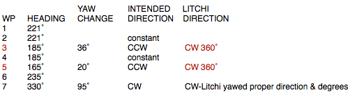

Thanks MapMaker53 for your response. From my chart below it doesn't seem that the camera angle change is the problem; but perhaps the lack of curvature is? I'll have to look at my other flight that day which had the same 360˚ Yaw problem.
Litchi Yaws 360˚ on Some WPs?
YAW INTENDED LITCHI
WP HEADING CHANGE DIRECTION DIRECTION
1 221˚
2 221˚
3 185˚ 36˚ CCW CW 360˚
4 185˚
5 165˚ 20˚ CCW CW 360˚
6 235˚
7 330˚ 95˚ CW Litchi yawed proper direction
WPs 1 thru 5 are virtually no curve but the camera angle Yaw change does not seem dramatic between 2 & 3, nor between 4 & 5. Whereas, 6 to 7 changes 95 degrees with the intended Yaw/camera angle response; but the path does curve.

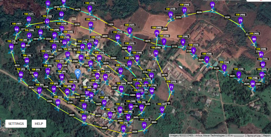

Veering back to Litchi Mission Hub, I have copied here one of the more complex flight paths I created out here in the boonies for my trusty old Phantom3 Standard, entailing multiple orbits to view points of interest from every conceivable perspective. After a fair bit of practice I was able to fine-tune the curves and camera orientations so as to eliminate all abrupt and jarring camera pans during the flight.

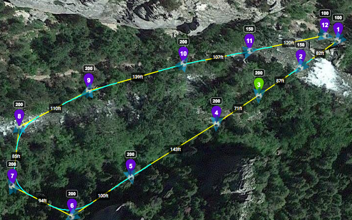

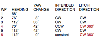

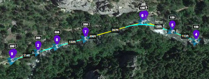

Here are two images with (hopefully formatted columns) WPs, headings, Yaw Changes, Intended Direction (CW/CCW), and Litchi Direction.
After looking at the NE Fwd-Rvs WP data (WP 5 to 6 has no intended Yaw change, yet, Litchi still rotated the AC 360˚), it may be a Rotation Direction setting in the Mobile App; I've been using Manual but I should test these two missions with the Managed setting?
