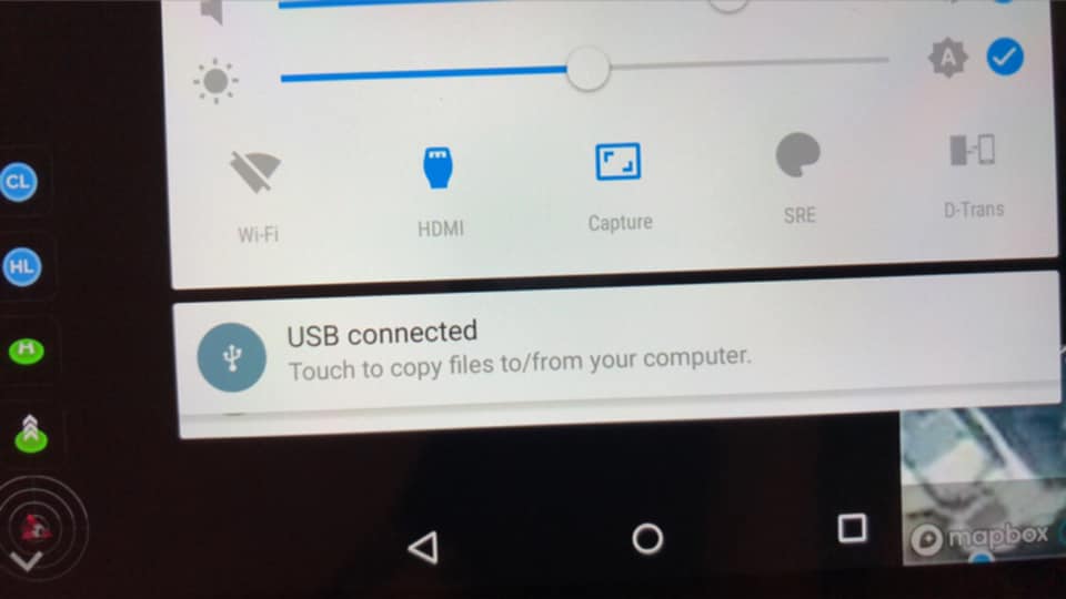

Hi folks,
I have a little problem and I hope that you, more experienced than me, can help me.
I have the latest firmware on a brand new GL300K and I can't figure out how to get Litchi "connected" to the P4Pv2+
I do this steps:
- I boot the controller, install from browser Amazon Store
- installed from the store Litchi
- Connected the USB Cable
... nothing happens, no window asking me which default app to use...
I reboot leaving the cable connected... the same... no windows asking me which default app to use.
I tried multiple usb cables and enabling and disabling USB Debugging... nothing...
Litchi starts but does not connect to the drone.
It looks like that recognizes the usb connection like a pen drive, the only thing I see it's the message "USB connected, tap to copy files from/to your computer"
Any help will be strongly appreciated...
Thank you in advance
Federico
