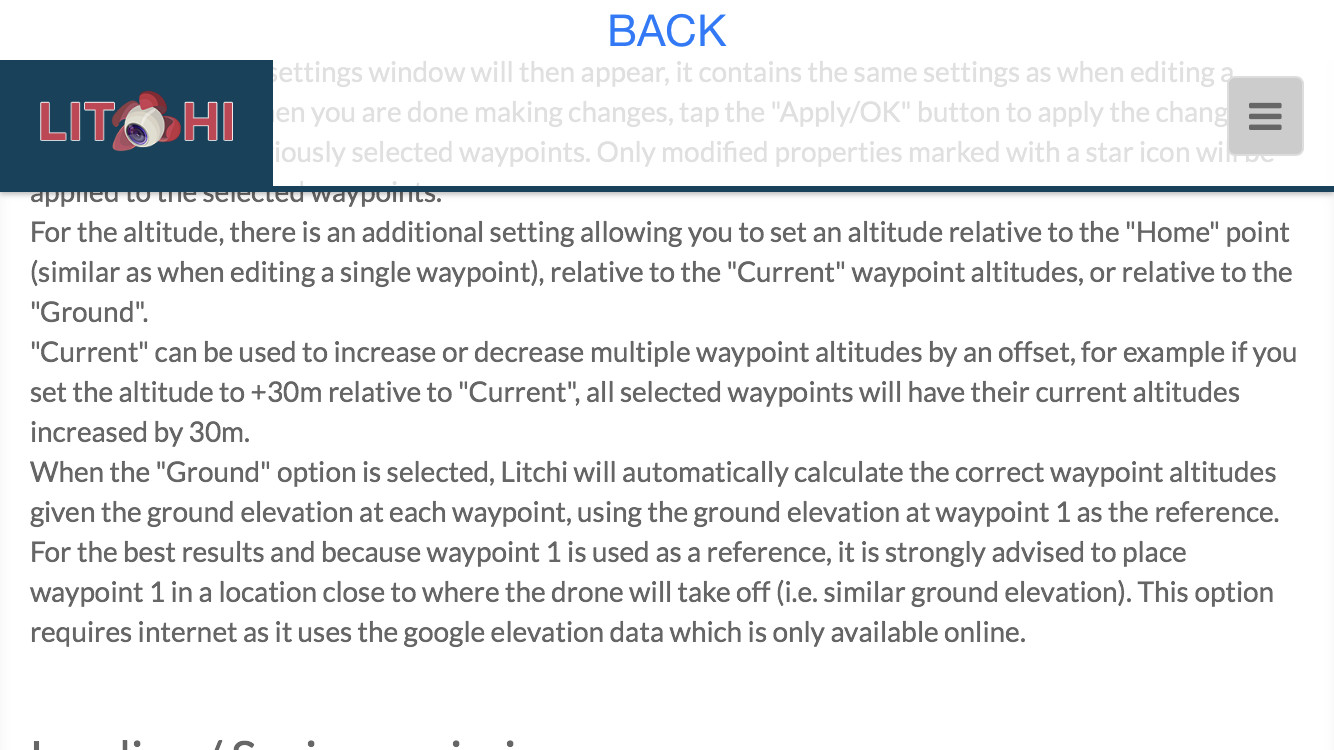

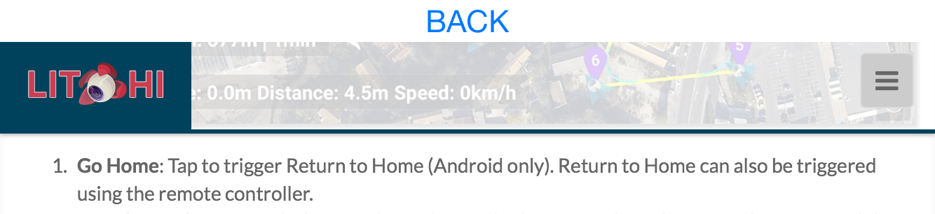

It’s possible you are missing the alternative way to do it in the app. I know it’s awkward and inconsistent with the hub. But it may just be there. You need to use batch mode. I checked their docs. They are usually pretty good at saying “(iOS only)” or “(android only)” my attached screenshot showing how to do this in batch mode does not have such a disclaimer. My second screenshot shows how they do that. If you try this avenue rather than looking for the check box you may be pleasantly surprised. I have no android so I can’t test.

Agreed, however look at the last sentence. In Litchi you can plan a mission with cached maps, however Batch edit is not available unless you are connected to the internet which is basically the same as using the hub to plan the mission which is much easier anyway if you are connected in the first place. So why even bother with the alternative.
Ok. That’s you’re opinion that you would rather use the hub unless forced to use the app due to no connection. But others may disagree including myself. So I guess we can agree that the feature IS in the android app for those who MAY wish to use it. At least it offers choice to those who have differing use cases.

Actually it seems you are misreading my posts. The functionality appears to be in both iOS and Android. I think you need to read my posts and attachments more carefully. Unless I am totally missing something. But I don’t think I am. But I’ll be open to you pointing out where the android app lacks this functionality. I even pointed to a post from someone who exercised it. I don’t know why you wouldn’t just try what I’m explaining. Would you rather be right then find out that you can do something you thought you couldn’t? I don’t think so because I’ve read many of your posts. So I’m puzzled as to why you resist what I’m showing multiple ways. I’m sure it’s some misunderstanding. Either I’m not being clear enough. Or I’m missing something you are saying.

Ok. That’s May very well be a fair point. I’m referencing a P4P at the moment. But I think I’ve also done this on my P3S
