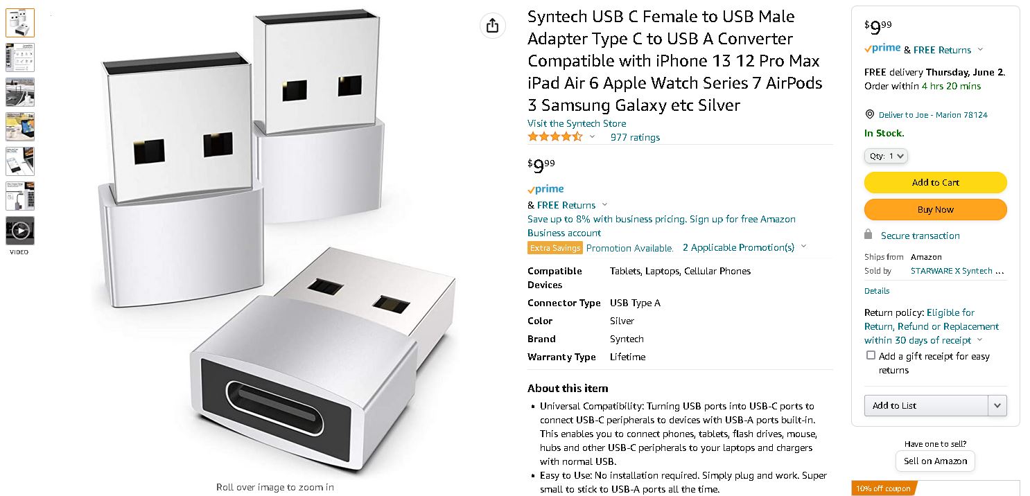

The issue is the USB-C of iPad Mini 6. In fact I understand from others, Apple devices with USB-C operating with iOS15 does not connect to the RC of P4P V1. It does not connect to the RC of P4P V1 when using DJIGO4 App. iPad Mini 6 connects to all other drones. DJI has acknowledged this issue but does not assure a date for an update to resolve the connection issue. That is why, I want to know if Litchi works with iPad Mini 6 to fly P4P V1.
Phantom 4 Pro V1 RC GL300F does not connect with the Apple iPad mini 6 using the DJI GO4 App. Any one tried using Litchi App on iPad Mini 6 to connect with the RC GL300F ?
