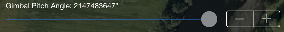

When I save and re-open a mission in the just updated Litchi 2.1.2 (iOS 11.3), negative gimbal pitches are displayed wrong (positive numbers are OK). Do others see this error?
Yes. I'm experiencing the same error. This value is on every waypoint and every mission I created. I've tried uninstalling/reinstalling, updating the gimbal value (the mission saves but when reopening the mission the same errant value loads), etc. Running iPad Air 2 and iPhone 6s.
At present time I cannot with any kind of trust fly a Litchi mission.
Looks like all gimbal pitches that were set to POI are now set to interpolate with that odd value.
Check that. I looked at another mission and it didn’t happen. Not sure what the difference is.
Litchi iOS version 2.1.3 is released. I spot checked a few missions. Waypoint gimbal issue appears resolved.
