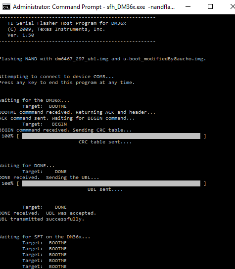

I will get something typed up but it's a matter of connecting a TTL USB serial module to the UART0 pads and then shorting BSEL and 3.3V together then power up (pads are clearly marked which is a bonus). You will then use the same instructions that have been posted here by Gaucho for the LB units - You will see the same wording scrolling accross the serial console (BOOT ME) and then run the EXE with:
sfh_DM36x.exe -nandflash -v -p "COMXX" dm6467_297_ubl.img u-boot_modifiedByGaucho.img
You should then see the update happening (see screenshot in my above post).
After that, reboot device without BSEL/3.3V shorted and you should be good!

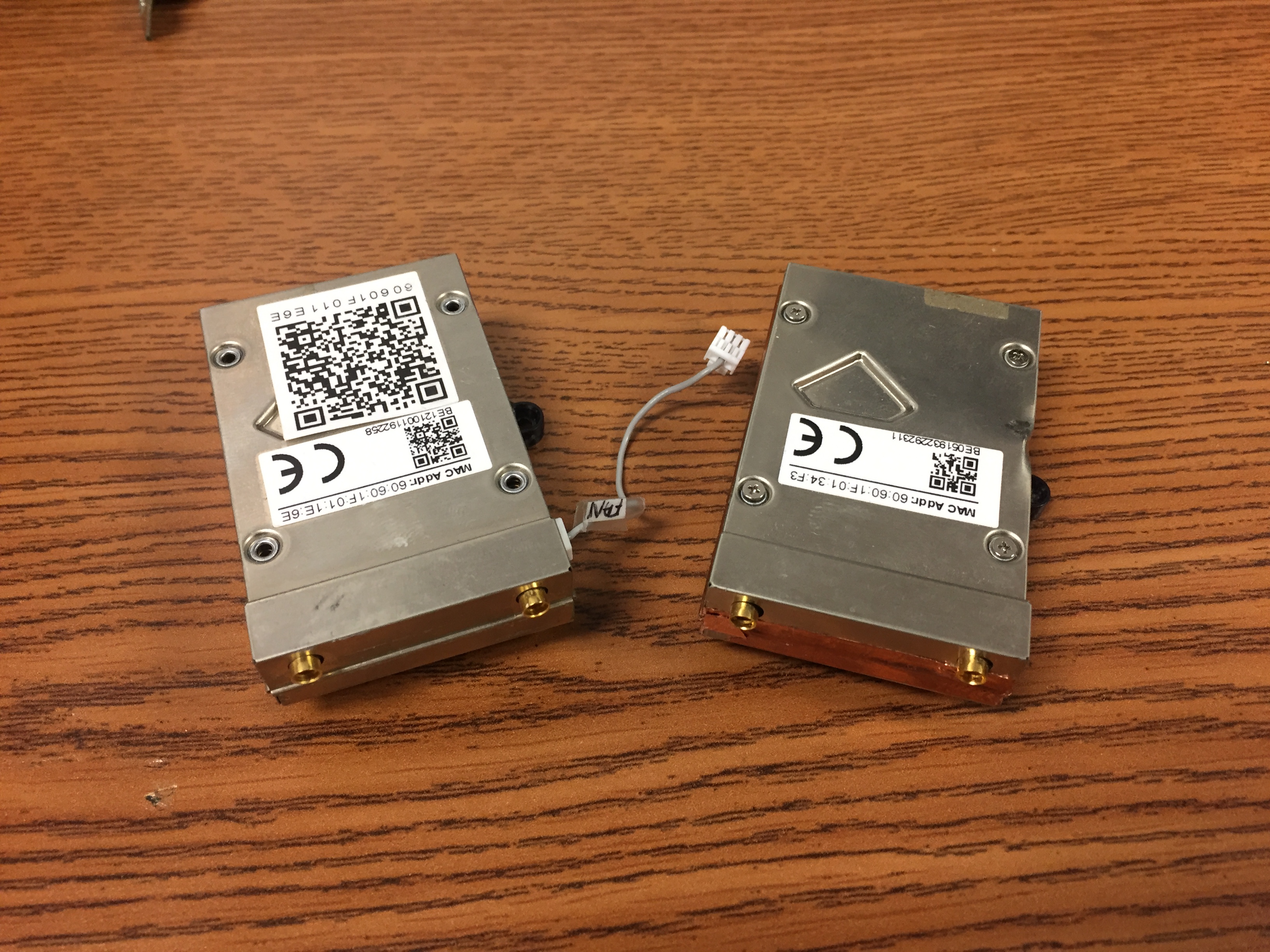

Hi Shomci,
This is not the module the flash gets pushed to. It goes to the wifi module inside the phantom. On your picture ending in 119, it looks like some components have burned out.
I will try to post pics of what the internal module looks like.

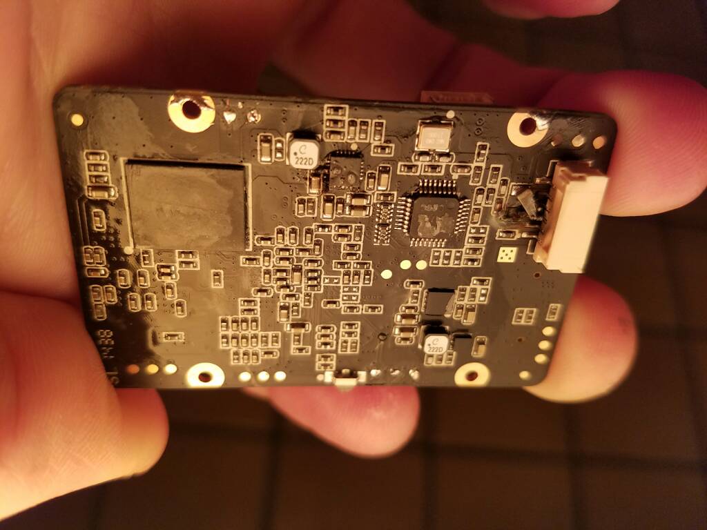

Hi @rmhome , it sounds like your P2VP flash refresh worked well. Unfortunately the WM301 wifi module in my P2VP doesn't have labels on its pads :-( I've uploaded a pic of the board.
If anyone can upload a pic of their board with labeled pads, I'll be well on my way to trying to reflash life back into this thing!

Hi okstuv,
There is a pic on page 14 by RmHome. His has the labels on it. I opened one of mine, and like yours, has no markings. On his, you will notice 3v3 and boot next to it. The boot is the bsel or boot select we need to short.
I will open the second one tomorrow.
Hi okstuv,

Update: I wired everything up and then I followed Gaucho's steps with the Rmhome revised img file to flash. COM terminal showed a bad boot pre flash, the "BOOT ME" message when bsel was high. And the new flash loaded super smooth.
When I went to reboot the board with bsel unshorted, my board fried... I'm certain the fault is not in the instructions or flash files (they flashed fine after all).
Wondering if a functioning boot without the sister board can stress the wifi board? Or if I shouldn't have powered the board with 12v. Or if just something slipped and touched a contact it shouldn't?
Ah well. It wasnt like it was tip-top to start. :-) gonna buy another failed wifi module cheap on eBay and see if I can revive it. So close!

Sorry I didn't understood: now your board is fried? What do you mean? The log seems to tell that the flash was not complete. Can you compare your screenshot with the screenshot of someone else here on this thread? Did you tried to stop and relaunch the command? To power it on and off as described on first post?
But I'm not sure.
Anyway if your board is fried and you are lucky, may be you can replace just the power regulator.
Follow the track and identify the power regulator, check the output voltage and if needed replace it.
Gaucho is right. Looking at the logs for successful air unit flashes, I jumped the gun and didn't flash all of the packages.
  • The first two items flashed fine
    • CRC and UBL loaded fine
  • Then at the SFT step the unit started giving me the "Boot Me" messages
  • At that point I:
    • powered down the module
    • quit the DM36x tool,
    • unshorted the BSEL/3VDC
    • Switched into teraterm to watch the port
    • Powered on the module
    • and POP! Sparks and smoke :-(
Attached pic notes where I had power connected and the parts that fried.
I get it that I had only done a partial job, but it's odd the module has the ability to short itself so dramatically...Any hypotheses why it would fry at that stage?
Because after you solder the wires the pcb becomes unprotected and any contact with the chassis causes a short circuit. You should put some tap on the soldered point before to remount everything. Big attention must applied also while flashing at "open heart"
