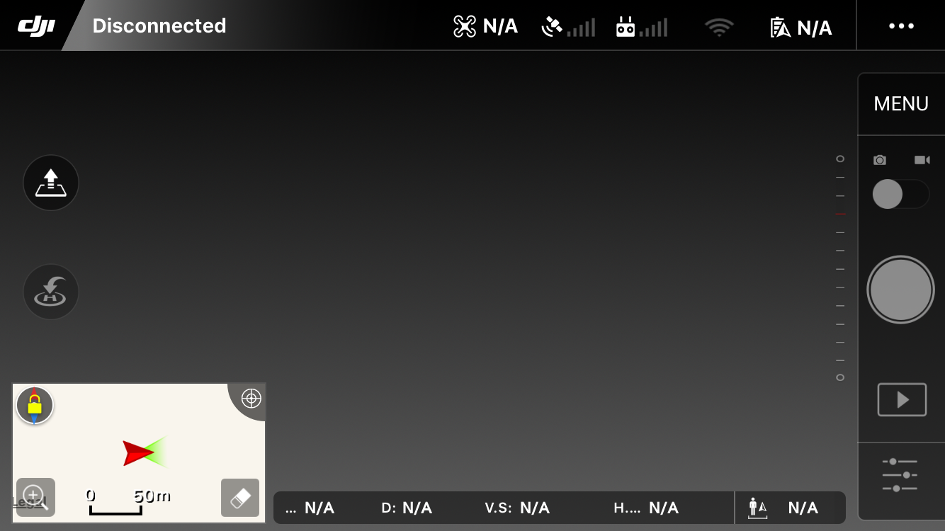

hello I have a severe video lag in liveview.
does anyone has experienced this
i´m running ios 9.3.2 iphone6
dji go 2.8.3
rc is 1.6
the problem is only in live view
if anyone knows how to fix this video lag i would be very thankfull, because i dont feel comfortable with this.
thanks in advance

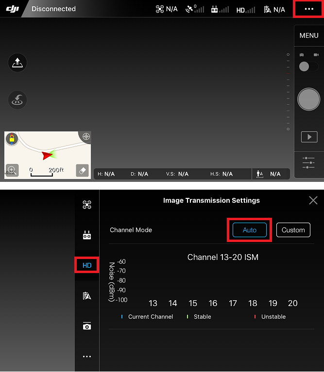

When I experienced lag after a DJI Go update, I realized it was because somehow the video channel settings had gotten switched from auto to manual (i.e. it was stuck on one broadcast channel rather than automatically searching for the best one). Flipped the switch back to auto, and it was good as new.
Hi where do I locate the switch to switch from manual to auto in the dgi go app settings . I think that might be my problem
Try connecting your Phantom to DJI GO.
I have p3 standard drone if that makes any difference
It does matter. This setting is only available if you have Lightbridge. The P3S transmits video via Wi-Fi.
