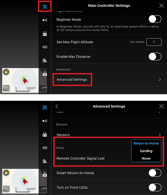

2. I wanted to get a couple of shots from a boat but I'm petrified of losing connection or something. do you set homepoint back on the shore In case it needs to RTH? Do you do ATTI only? What's best practice (outside of not doing it at all)?
That would be a good idea if you're flying near the shore. If you're not near land, you could set the Phantom to hover when the remote controller signal is lost -- like this:
Keep in mind that neither of these things will help if you fly until the battery reaches the critically low level. At that point, you Phantom will auto land at its current location.

Yes!!! Thank you!! That link is priceless too!!
