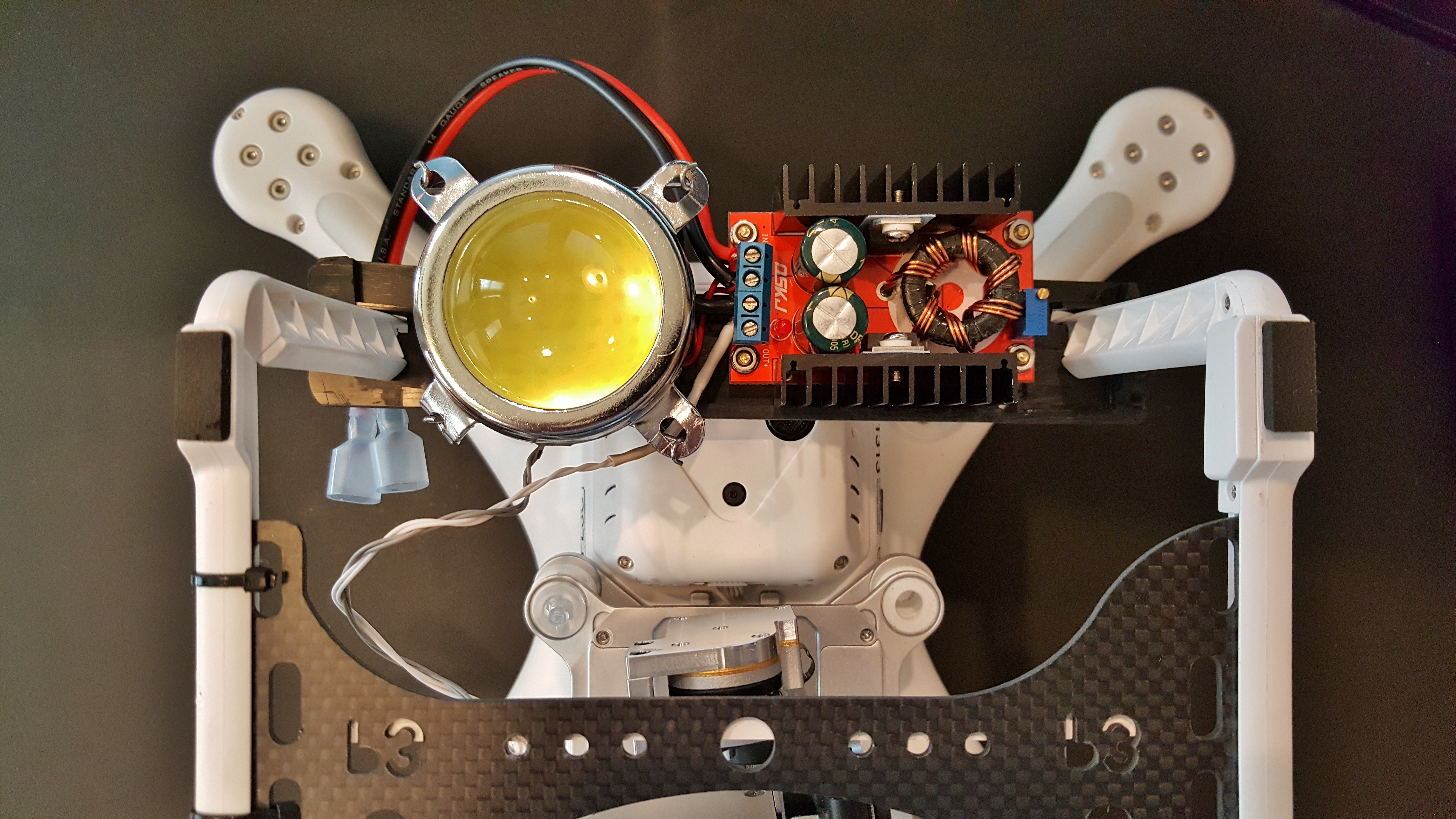

100 watt LED spot light mod sneak peek below.

OMG JonE, 100 watt LED, the village will think the sun is coming up! Gotta share video when you fire up that puppy.
I am posting photos later this morning.
