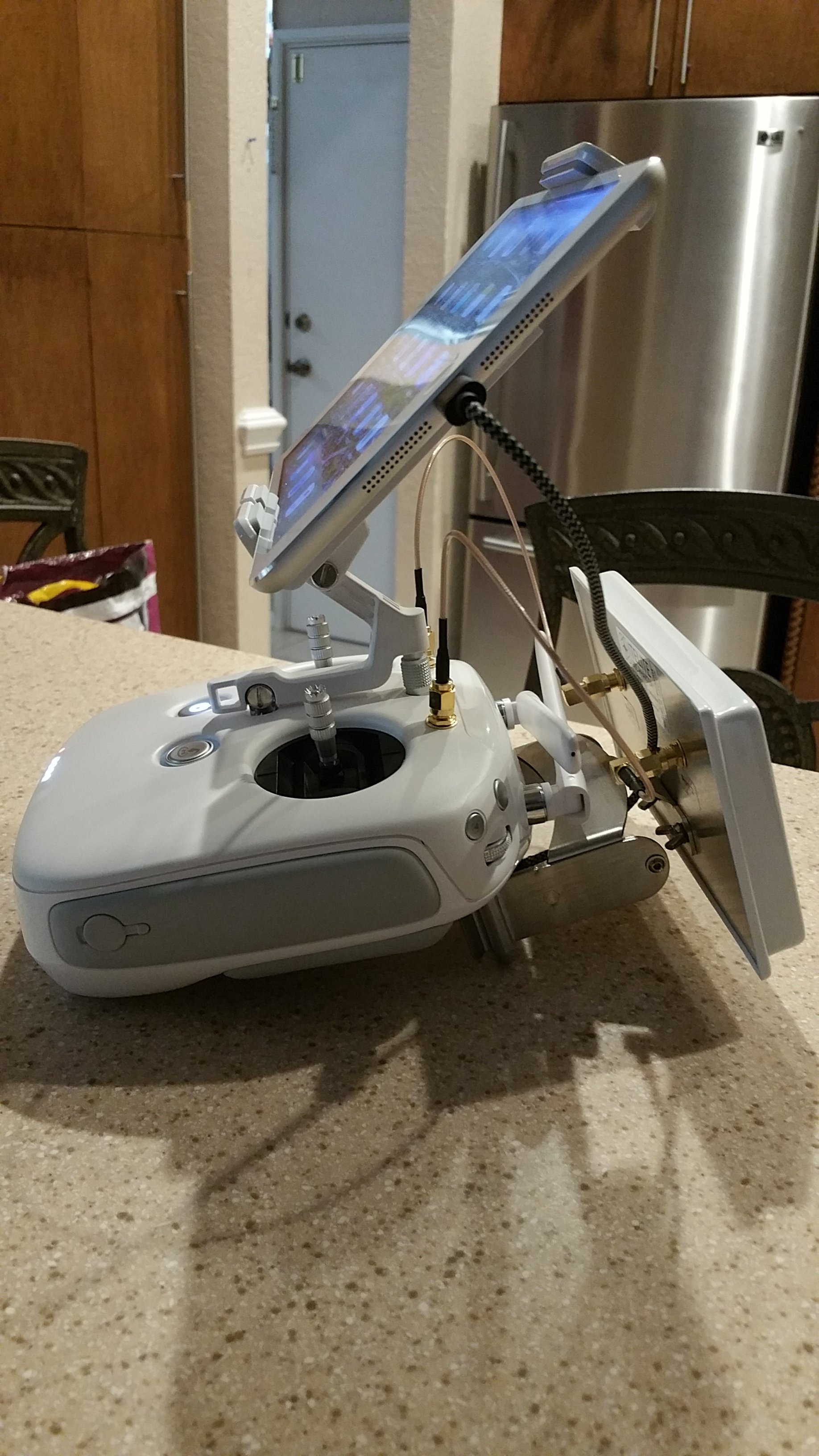

Does anyone know where to find shorter rp-sma cables? I purchased my ITELITE Antenna the moment to was released and the cable connecting from the RC to the antenna panel are too long that they sent with the kit. I installed the same antenna for a friend of mine and his ITELITE Antenna kit came with shorter rp-sma cables...
Does anyone know where to find shorter rp-sma cables? I purchased my ITELITE Antenna the moment to was released and the cable connecting from the RC to the antenna panel are too long that they sent with the kit. I installed the same antenna for a friend of mine and his ITELITE Antenna kit came with shorter rp-sma cables... View attachment 31377
There's several sellers on eBay.
Do not buy shorter cables. I got them on top of my Itelite dbs antenna purchase and they where silver plated my range was almost the same as the factory antennas then I switched to the originals and I got a very long range.
I'm using the shorter blue rg 402 cables and they work amazingly . Nikolas.C you might have just got a bad cable. They are mass produced out of China and there's a good chance that quality inspections do not exist.
I bought them from Horizons in the UK they are supposed to be top quality I heard others had issues with the blue cables but ok i take your point
But absolutely go with what works best for you. Its crazy how 2 exact setups can get 2 totally different results. Environmental conditions are such a huge factor. Good luck !!
