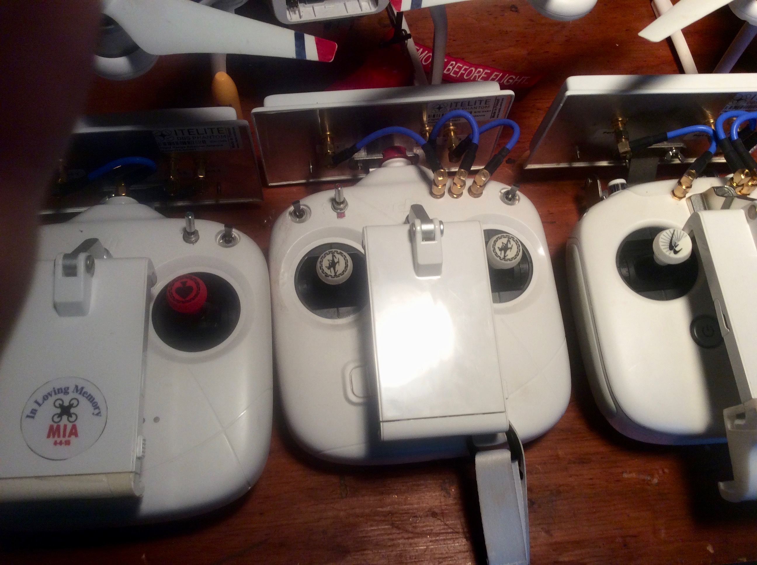

Sorry for late reply and havn't found where I got the thicker cables that are on the inside of the TX as this was a good ways back I was doing these and didn't get them off eBay. I did get the blue ones and they have been discontinued but found these and really the same thinghttp://www.ebay.com/itm/SMA-male-to-RP-SMA-male-both-right-angle-RF-lot-RG402-Semi-Flexible-blue-Cable-/262510420095?var=&hash=item3d1ed7207f
Now When this started I did try with the cables that came with the panel then kept modding till I hit as far as my battery would let me go and I do have a no noise out in the country place to test .It's all in this section but is back in it . I have my P2V,Standard and 4K all the same .
Awesome. I love the custom knobs too.
