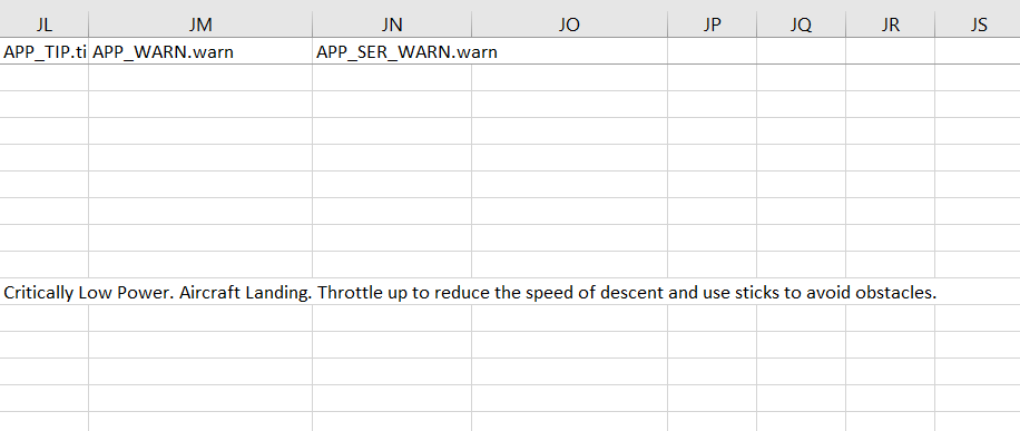

I confess I too thought this worked as Fly Dawg outlined, but my respect for your experience Mike has got me too scratching my head now. I firmly believed (though I guess never pushed to experience in person) that the AC would commence autoland upon reaching the critical battery level I set in the app (which I have set at 10% like most folk I think), not land based on a calculated critical battery level. Delighted to be educated if this is true, but want to test and verify too (mostly because I thought I knew this). Thanks!
I haven’t tested on my 4”s but I did a test early in with the P3 and the autoland hits when the depicted battery % drops to the critical level set... I used 25% as my test point and it was a brand new battery. Like many I spent the first few days of flying testing the settings and AC behaviour. It was about then I determined critical level is a useless adjustment, set it to the lowest value available. Why anyone might set it higher is beyond me.

Critical battery is related ultimately to voltage. If the voltage drops to something like 13.25 volts, it will land. Cold batteries can do this although appears not to be a factor in this present instance. But I notice from the voltage chart that the battery had reached 13.25 volts. I had my P3 Pro land unexpectedly a couple of times because the battery wasn't warmed enough for sustained flight. Now I check battery temp while hovering a few feed off the ground and also watch voltage. Below battery temp of 25 C a P3 won't sustain flight, but I can fly at -10 C provided the battery is above 25 C at takeoff.

The battery screen shows the voltage of each CELL in the pack; it takes only one cell to become critical to land the drone with plenty of percentage left.
