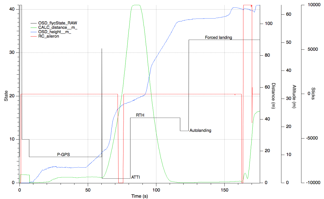

Here's what your flight data looks like:
DJI Flight Log Viewer - PhantomHelp.com
It's pretty cleasr that something's not right with that flight lig.
There are no ESC errors showing in the data but it clearly shows the Phantom ascending when you had the left stick pulled down.
It also says RTH: Preascending at 1:56 when the drone was at 188 ft even though the RTH height is set at 66 ft.

The cause of some of the behavior is clear, but not all. The uncommanded ascent and lack of altitude control is obvious but the reason is not. It may have been related to the vision system, which did not register any increase in height after takeoff. I've not seen that before and I don't know what effect it would have. Did you have any other equipment on the aircraft, or perhaps forgot to remove the vision sensor protective films?
The horizontal behavior of the aircraft is normal. It appears that you mis-remembered when you switched to ATTI mode - that was at 60 seconds and before you activated RTH. It was in ATTI for 21 seconds and it did drift 100 m NE during that period. At 81 seconds you initiated RTH and it returned to the home point as expected, but did fail to descend. However, the subsequent movement to the NW and then SE occurred because at 162 seconds you applied full left aileron for 1.2 seconds and then full right aileron for 6.5 seconds.
The end of the flight is not apparent because no descent is recorded - presumably the downlink was lost.

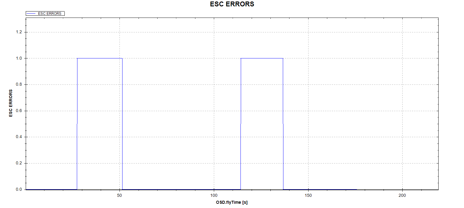

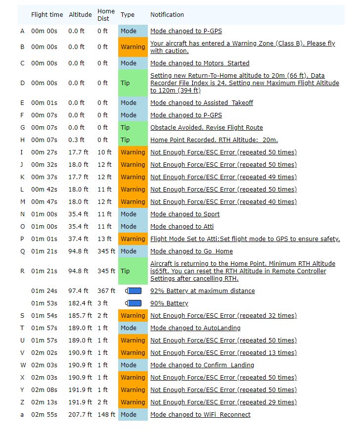

When I plug the flight record in Healthydrones I get a ton of ESC errors.

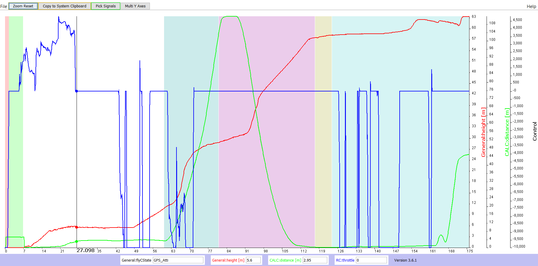

The ESC Errors are shown below. ( You will only see the time they were there in total, as Airdata may say repeated X number of times) In fact immediately after you released the throttle at ~26.9 Seconds, the throttle never responded to your inputs again afterwards. On a note, this is the 3rd one of these types of events I have seen with a P4. Primarily involving a non-responsive throttle. Although the other inputs could be affected as well. To me this is an issue with the RC of some sort. Hopefully you return your RC with the AC.
