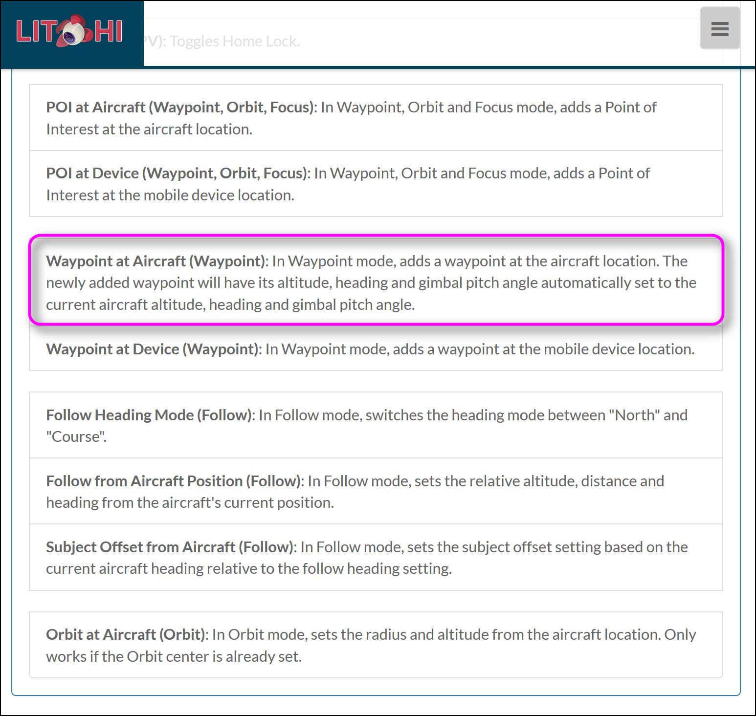

Can I go to a point in the sky and set that point as a way point?
If you have mapped that function to C1 or C2.
