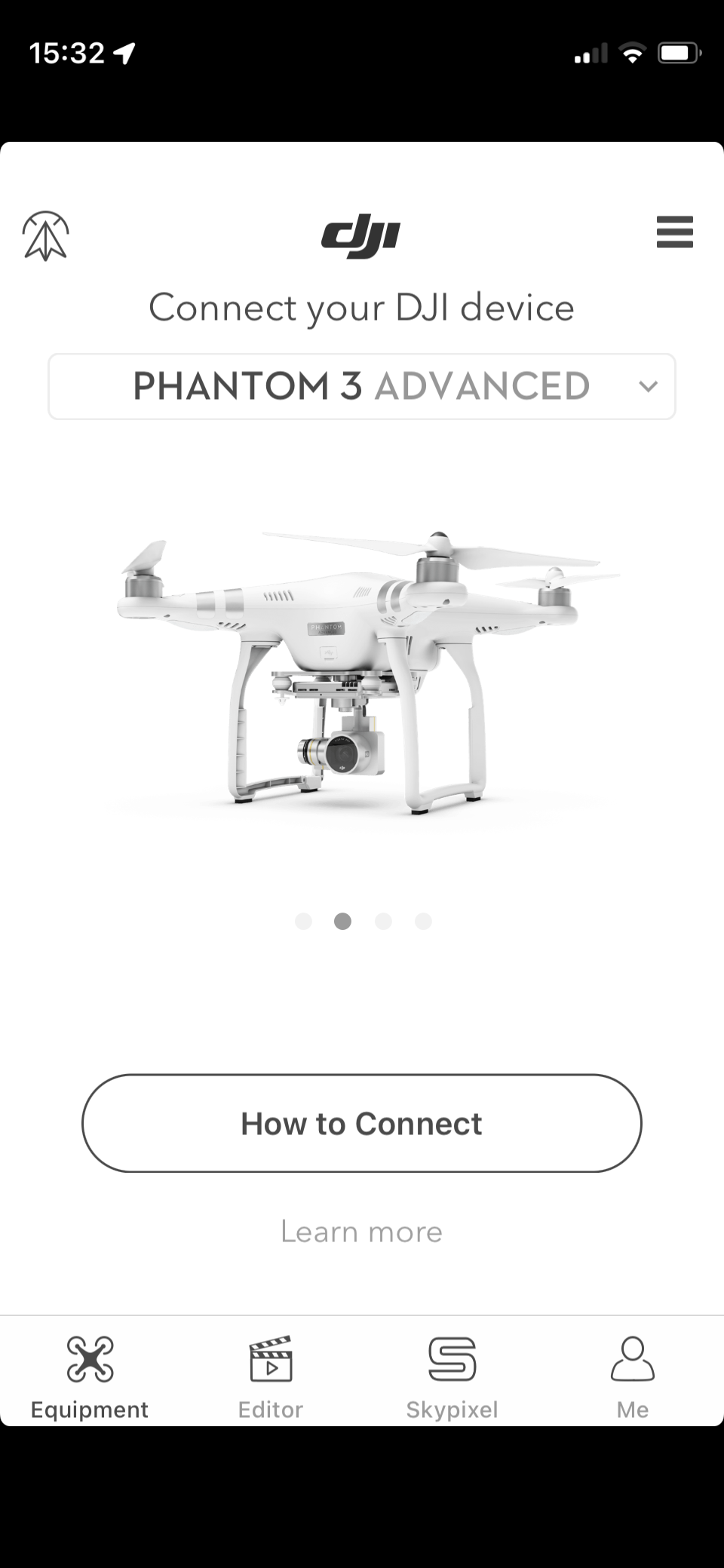

Is the iPhone 12 Mini compatible with the DGI GO app? I can't get it to connect to the RC, just get the "How to connect" message, not the CAMERA one.

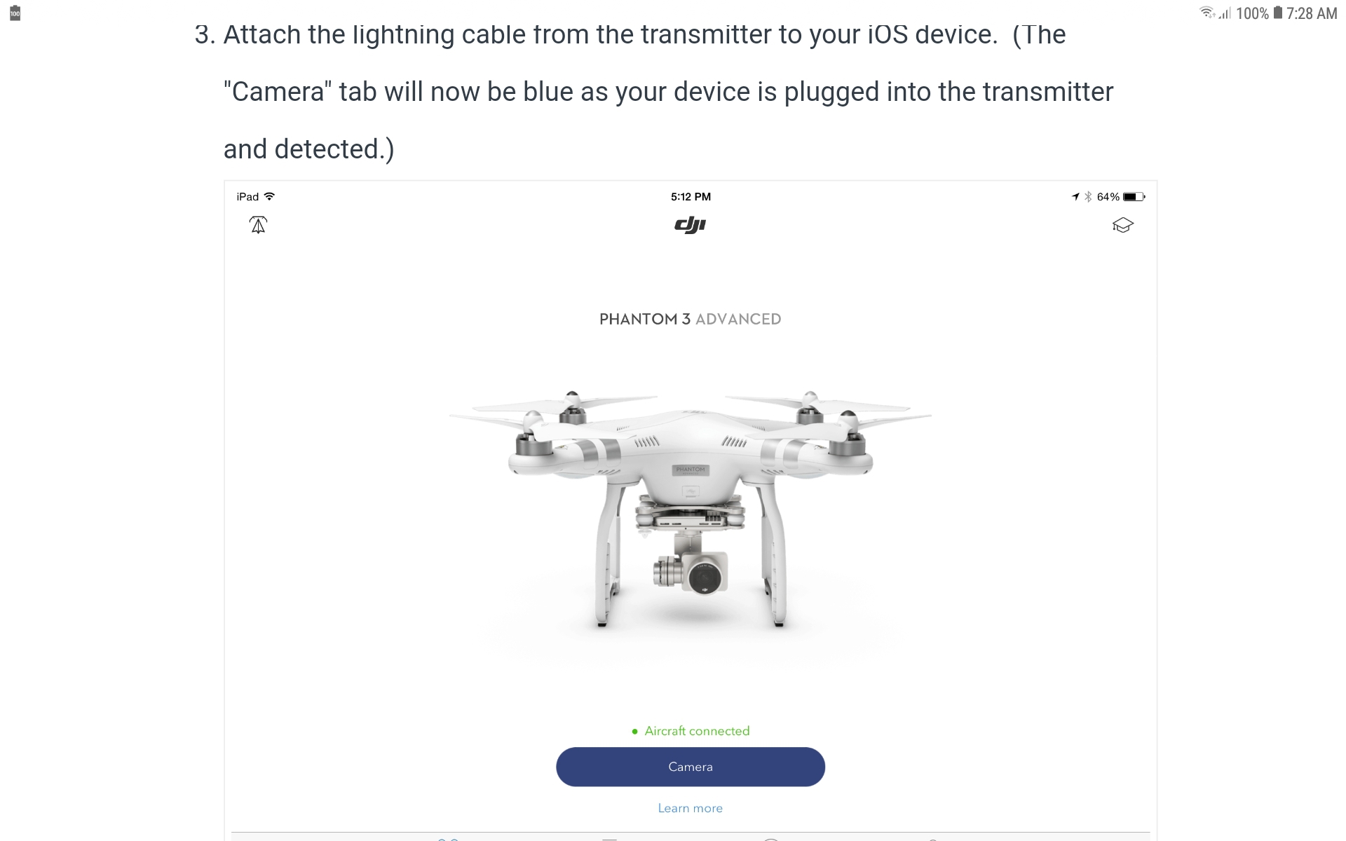

Still no conection,,as far as I know it stays like that till USB is conected ,,once USB is in it should turn blue ready to work,,,,,,,mayby USB port or board in remote has given up since it not conect with your other device either,,,unsure how to test this part,,almost worth trying to find a cheap replacement remote to use or for parts,,good luck that's pretty frustrating,,,,try couple different USB cables to eliminate that part
Thanks. Same issue as before, not connected.
