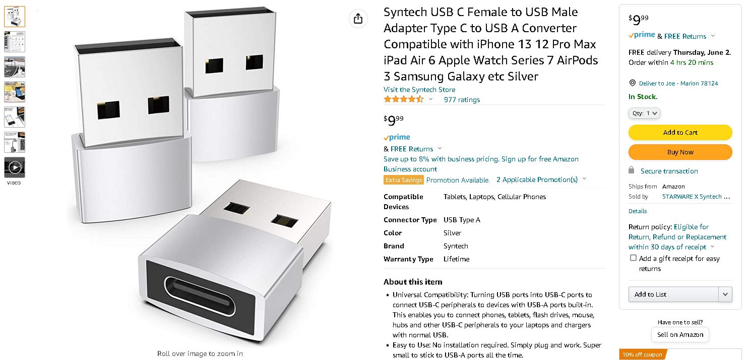

I actually have it working on an ipad pro 12.9" 2018, but I got it all connected while I had iOS 14. Post-15 update on that ipad, all is good. However, I just got an ipad mini 2021 and it will not connect. I was able to connect the mini to my Mavic Air 2 with no problem.
