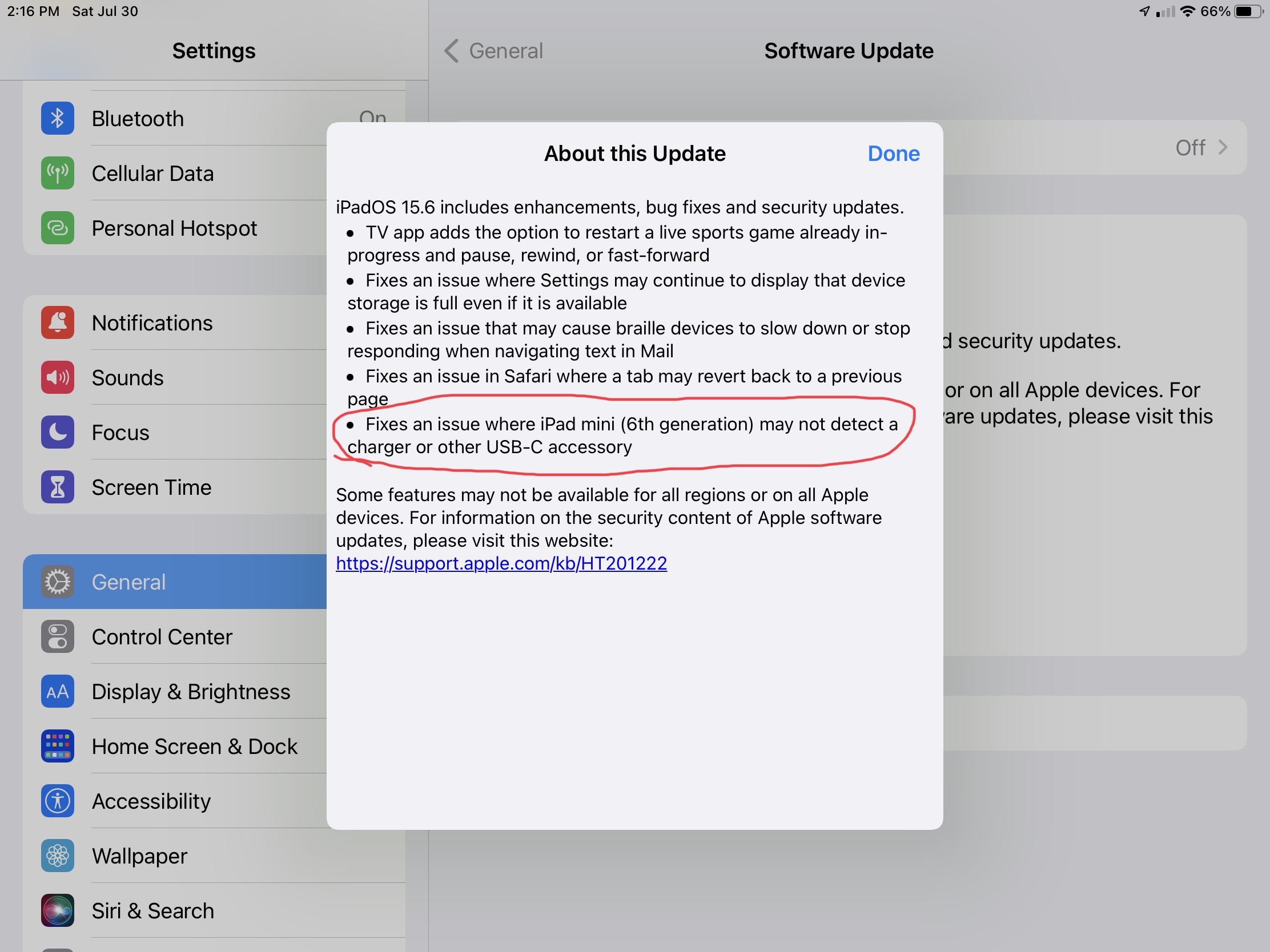

Anybody else see this ???
I've been having a similar issue using my 11" iPad Pro with my P4P V1 since the beginning of last year. It's not the same using an iPhone so I don't even fly anymore. I didn't know about the issue after iOS 14.6 until reading this thread. I'm going to give that adapter a try to see if that works for me.
