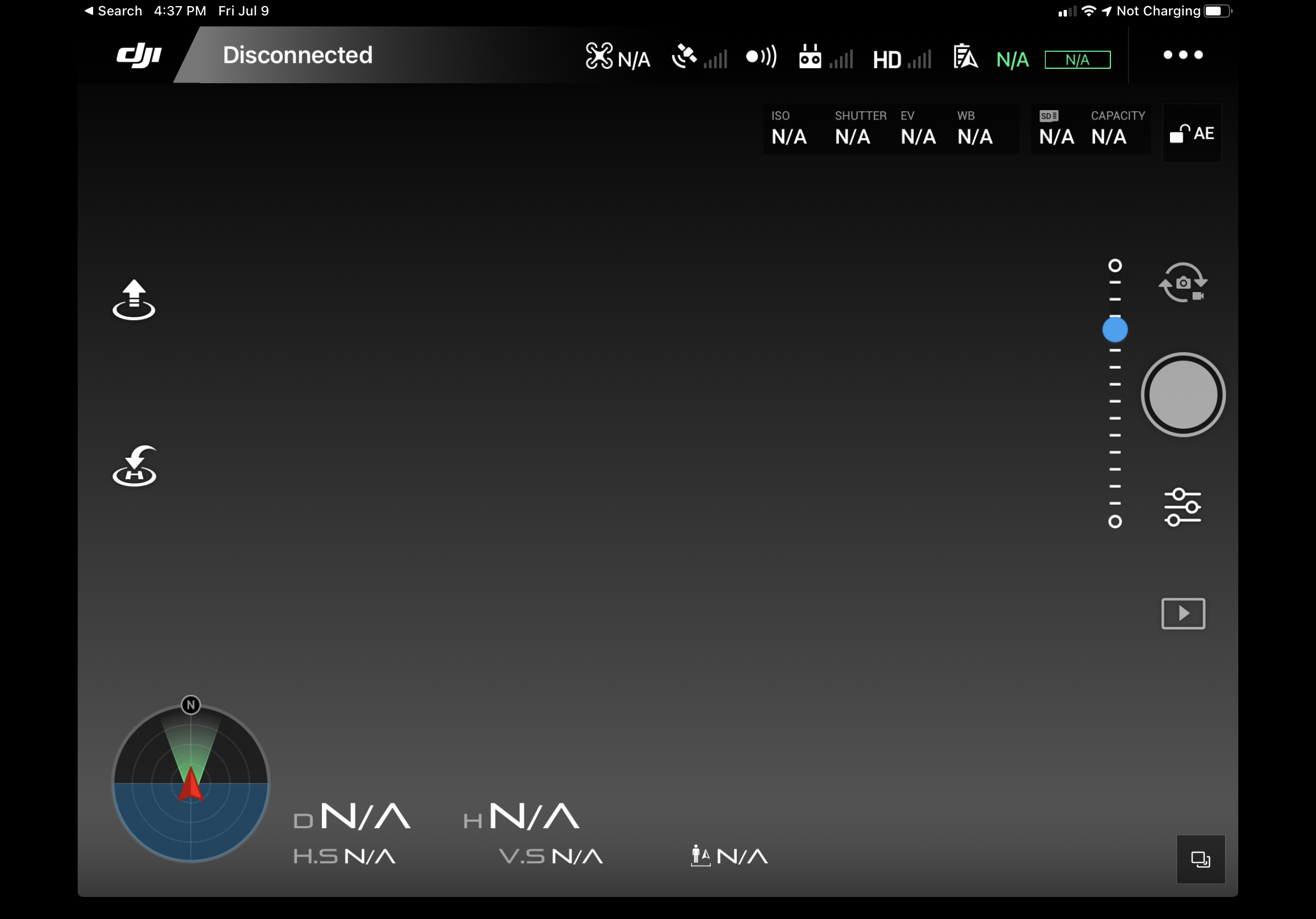

I'm still having this issue. This is what I see on the screen. The map in the lower right hand corner works if I open it.
Still trying to figure this out. I deleted the app off of my iPad then reinstalled. That didn't help. I then connected my iPhone. That works fine.
Sounds like there is a glitch in the IP if it works with your iPhone. I know you have removed the app and put it back, Maybe now would be a good time to restore your Ipad . ...
Back it up and restore it and see what happens.

I think I'll be trying this next. Actually, I'll restore the iPad to factory settings then try it like that before installing the backup.
I just returned the iPad to factory settings then only installed the DJI app. Same problem. I tried a different cable with no luck. After that I downloaded the app onto my daughter's iPad. Same problem. I think connected my iPhone 12 Pro. That works.
I'm lost with this one. The one thing that keeps standing out to me is it says "Not charging" in the upper right hand corner when connected to an iPad. It shows the current battery percentage when connected to my phone.
