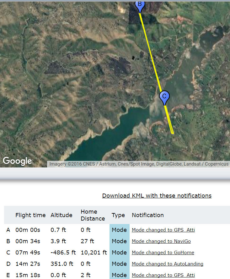

I had an interesting flight with my P4 under Litchi on Wednesday, from the top of a hill, out over a lake to a point on the other side, and then return.
Most distance point was 4.049 kilometres away, and the total flight was 8,175 metres.
The thing I don’t understand was why, at 7:49 mins and on the way back at 3,109 metres out, and with 62% battery, the P4 initiated RTH.
On the way back, cruising at 45 km/h , with only about 3/8th of the mission to complete and heading for home with 62% battery left, it seemed in no danger of not making it back, so why would it initiate RTH?
After that happened it had to climb from -148 metres, to + 108 metres to reach the RTH height, and stopped to do this, right over the middle of the lake. I eventually kicked it up to 35 km/h to get it moving again, and it eventually landed with 35% battery left, a very comfortable position.
The full data log is here http://tinyurl.com/jcze5cn
I'm no expert but my guess is that you had Smart RTH turned on. The Phantom determined that it didn't have enough battery left to complete the entire mission so RTH kicked in. Since you said you increased speed on the return trip and made it back with 35% battery left, it would have been less than 35% had you NOT increased speed. The bird seems to be a bit conservative on its estimates of this.
