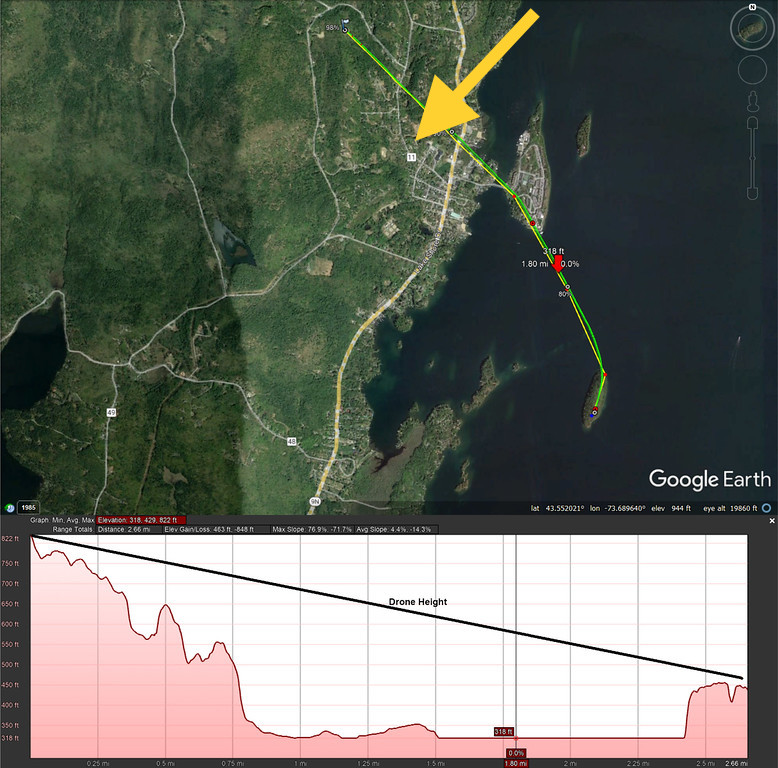

I take it back. I don’t think it’s possible because the altitude was never 65 ft above the takeoff point. Not even later in the flight. And certainly not around the island where connection as lost. It hit the tree significantly lower than the takeoff point. 65 ft above the takeoff point would be over my house which is at the top of the hill.

It's hard to be certain since we have no data for the time in question.
But perhaps we can join some dots?
The Phantomhelp link only lasts a few weeks so I can't re-examine the data.
Can you post it again?
And point out where teh drone was found too.
At some point I’ll try to power up and get the internal flight logs. I can try to repost the controller log to phantomhelp but I’m not sure that’s necessary. Based on local knowledge I can tell by the video that she was well below the launch point (my house) the whole time. I’ll look up in this thread and see if you posted a graph of altitude from the controller log.

@Meta4 I’m attaching an image you posted on this thread back in Dec but I added an arrow to point at where it was found. Also in your comments you did verify that RTH was set at 305 and it should have been enough to clear obstacles on the return path.
Of course I realize that the return path was more direct than the data you had to go on. But the difference was small and with my local knowledge I can say with certainty that your comment still applies.

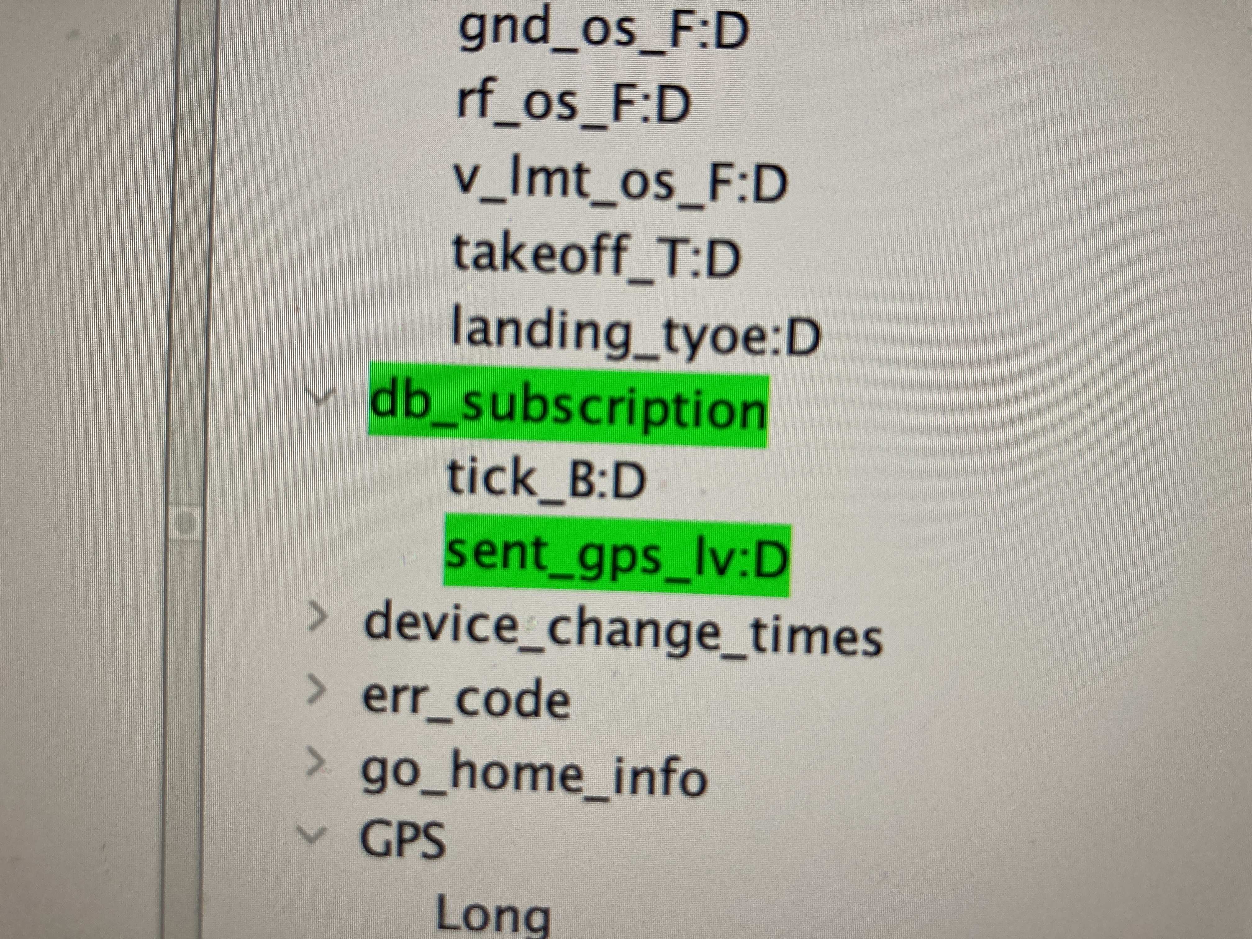

@Meta4 If you would be so kind to take a look I was able to extract the DAT file from the flight off the aircraft. (Link below). I generated a CSV from DatCon and while the data is overwhelming in that format I picked out a few things.
First, I spot checked some coordinates and confirmed that the Gohome spot and the crash site make sense-so it’s the right log. Although the row with the lat Lon of the crash is several rows before the end (at time offset of 703.811.) I guess the other rows are as it was crashing. But the last row is maybe 100 ft or so from where it was found. Lat/Lon at 703.811 sec is where it was found.
Something else which looked maybe out of place. Position error = TRUE shows up at 75.309. Early in the flight so maybe unrelated.
Thanks much. Curious why it didn’t go to RTH height.
Edit: I included the CSV link by mistake. Here is the DAT.

Been messing with CSVviewer. Fun learning experience. Haven’t uncovered anything much being a novice. But per something @Meta4 said about throttle input and height relative to takeoff point cancelling elevating to RTH height I’ve determined, as suspects, that wasn’t the cause. There were no inputs after loss of signal and go home. And height was always lower than -100
Hmm. Interesting parameter.
