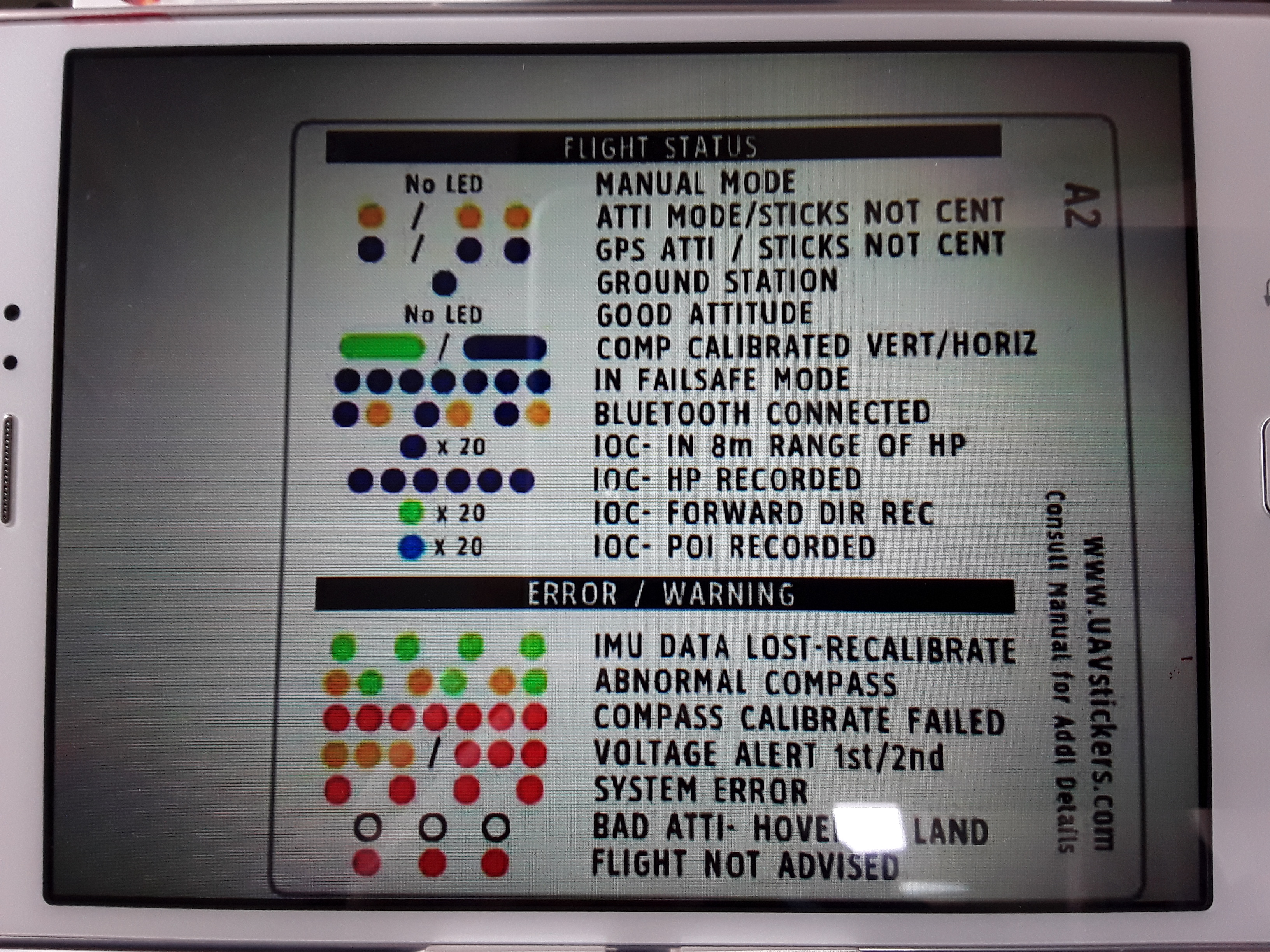

Lights under drone arms coincide with light colour on remote.yellow atti,gps green etc,that why i say download manual o_O
I do have the manual on my pc and haven't re-read it in awhile guess its time to refresh, I know the lights coincide but because I never lost the satellite connections (showed locked on) that's what confused me also when I flew it sideways and released the joystick it should have kept going & it stopped in place like it was locked on GPS. Just wondered what was going on and if anyone had a similar issue. I realize now that it must have been the near by trees or house that interfered. Also possibly that it was on the stronger side of yellow. Guess I should have explained myself more clearer. Thanks for your reply.
