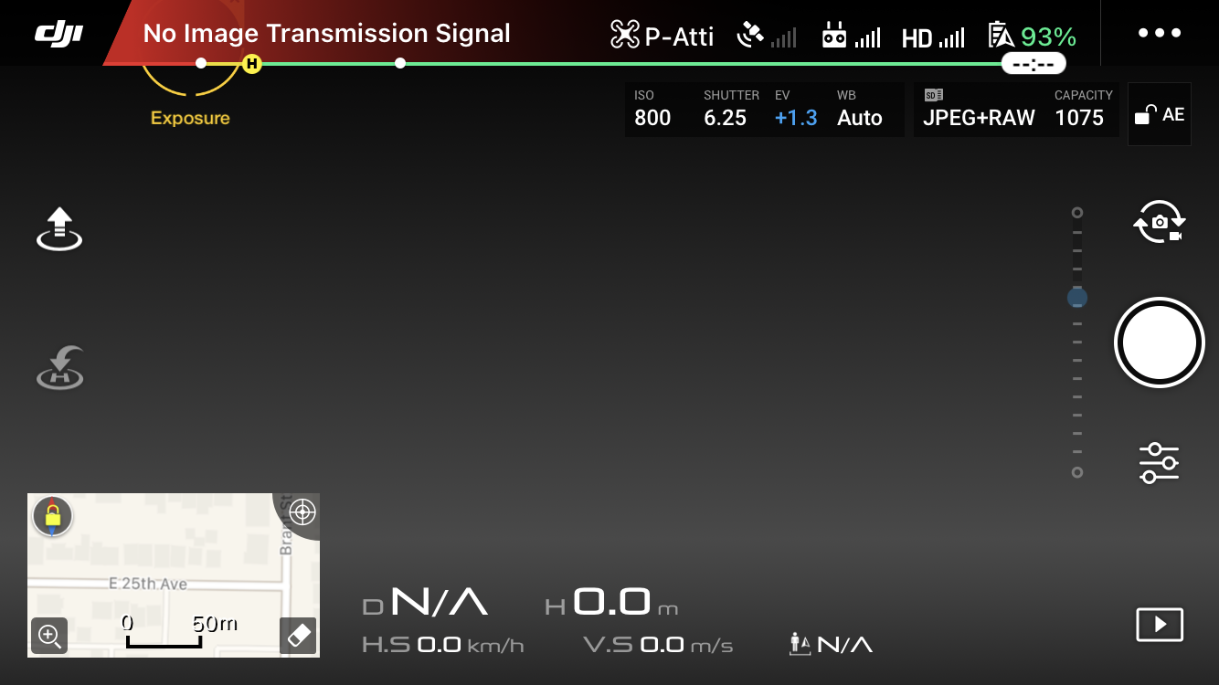

I have a brand new out of the box dji profesional 3.
Everything lights up and and is connected to the controller but no video feed.
It says the IMU needs to be calibrated but wont let me press the calibration button.
Will not let me calibrate the compass either.
It just sits there will all the lights and beeping.
Please Help.
I just tried the stick calibration but it wont end it just says to move sticks rapidly to max in all directions, I did that for about 5 mins but it wont finish.
How long is it supposed to go on for?
Here is the main screen Im looking at.
As was noted, no image transmission is a common problem with P3Ps especially. When it occurs, it is often due to overheating the gimbal main (top) board by having it powered up too long with no airflow. Also, we see it after long periods of inactivity.
My guess is that one or the other has happened to you as well. @ianzone suggested that you search for those posts and I agree. I’d expect that your LOG_AB file will show modules 8/15 as “device not detected.” More general tips can be found here.
We also often suggest the no image transmission troubleshooting chart developed by @quaddamage
