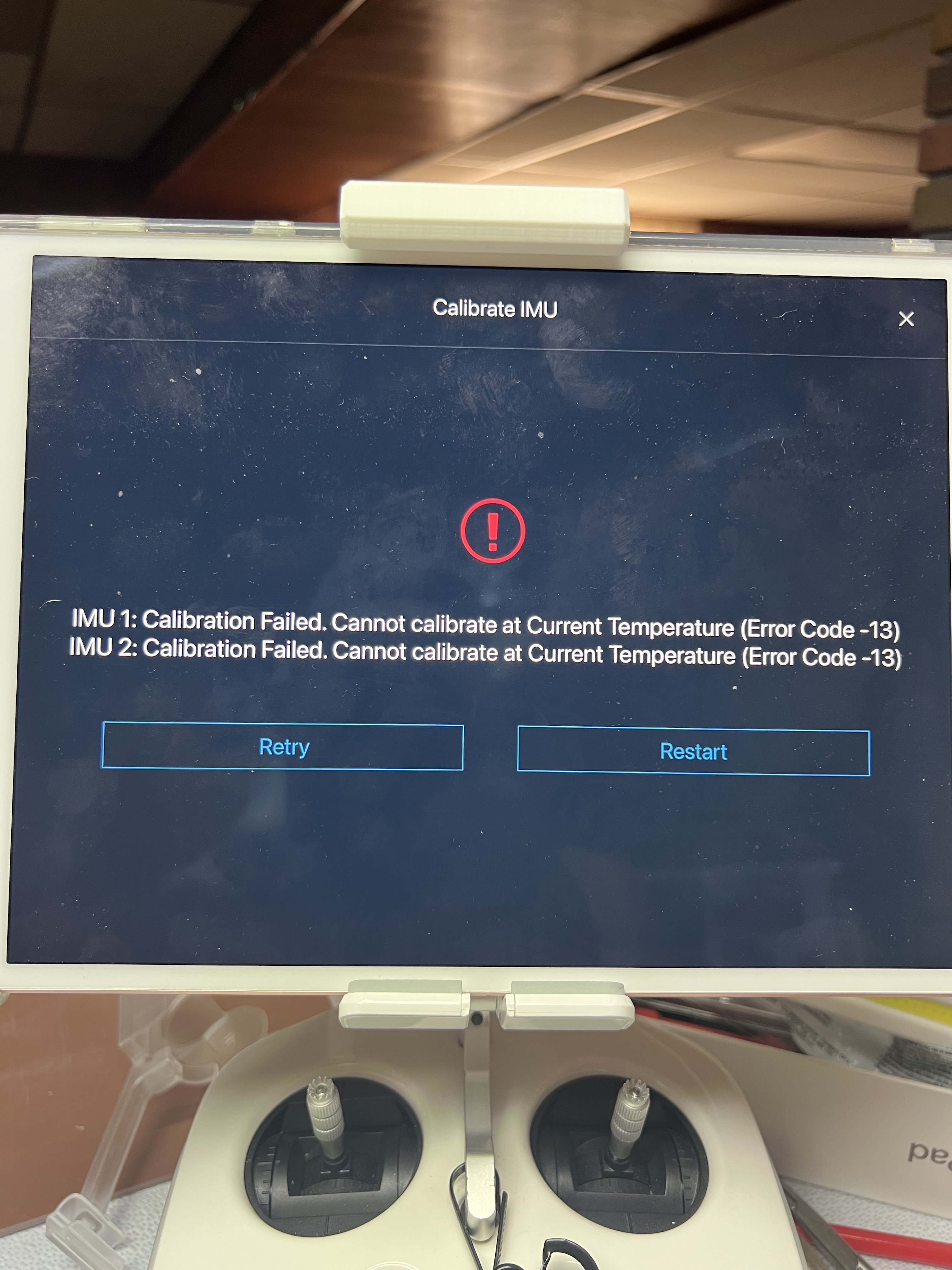

Tried the cold method..failed, tried room temperature..failed. I just cant catch a break. I am almost at the point of giving up on this freaking thing. Its been consuming all my energy for the last month and a half im going nuts.

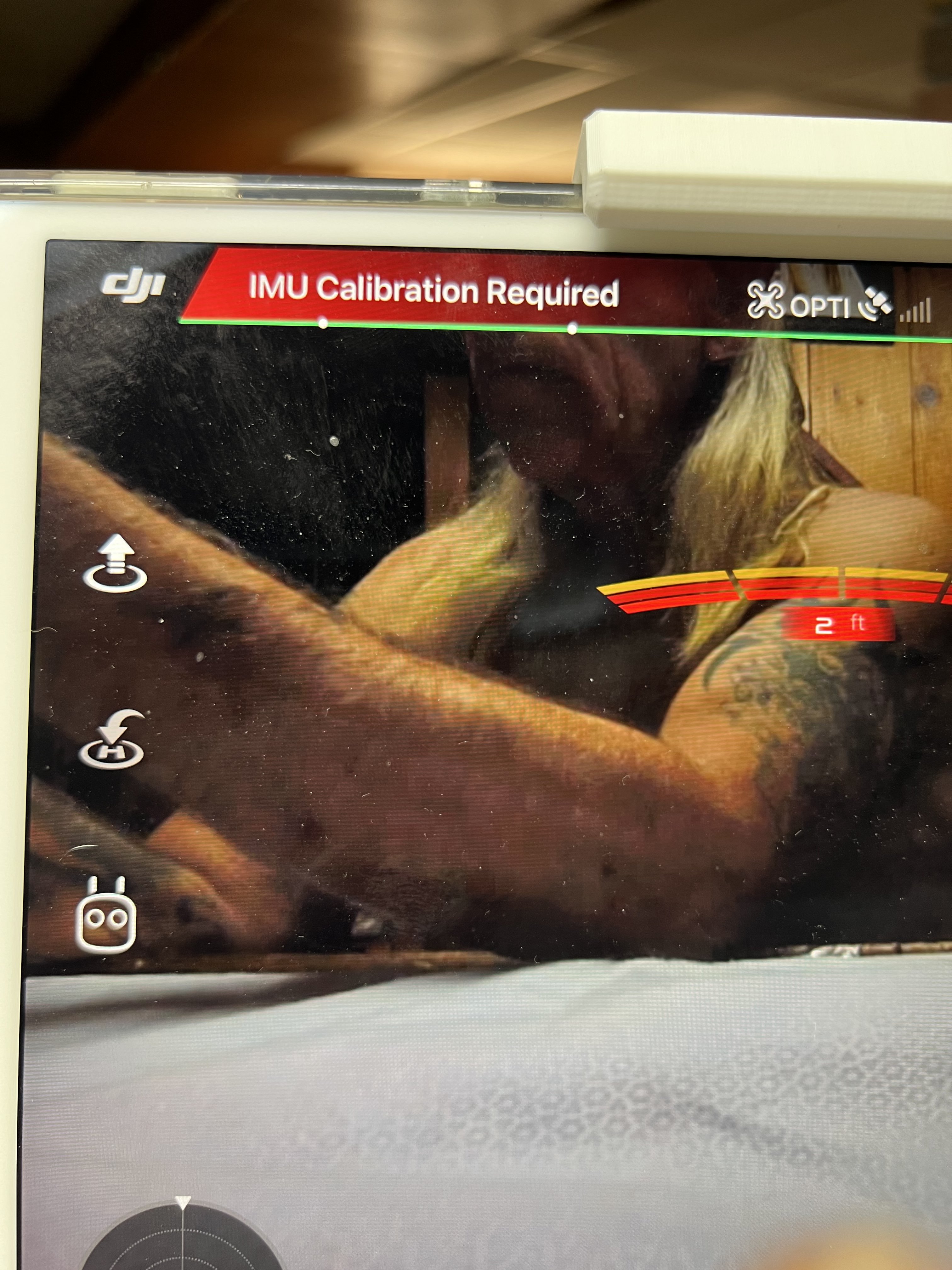

Now im back to square one, now its telling me that IMU calibration needed just like where i was before swapping FC board. This is freaking crazy.

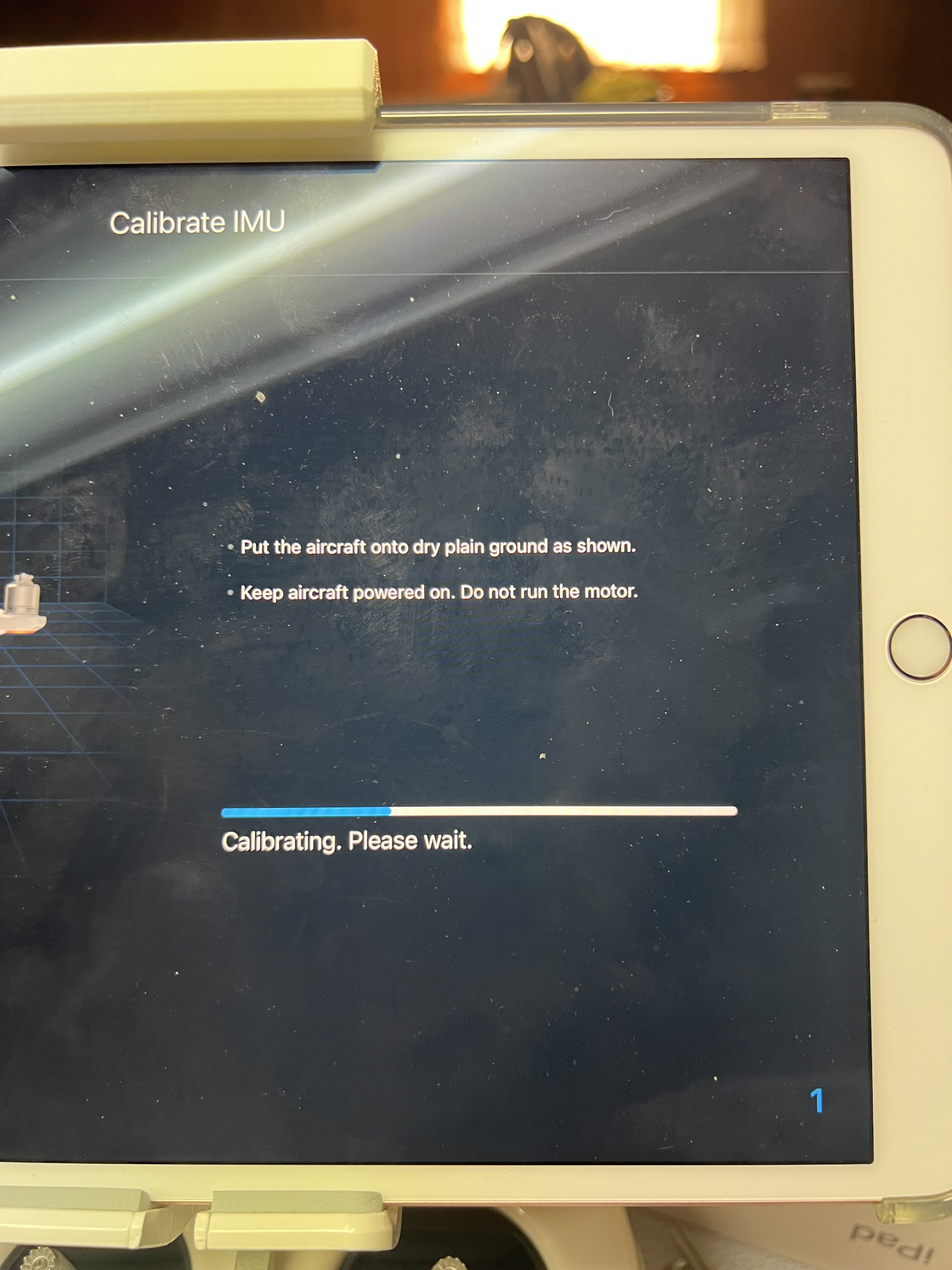

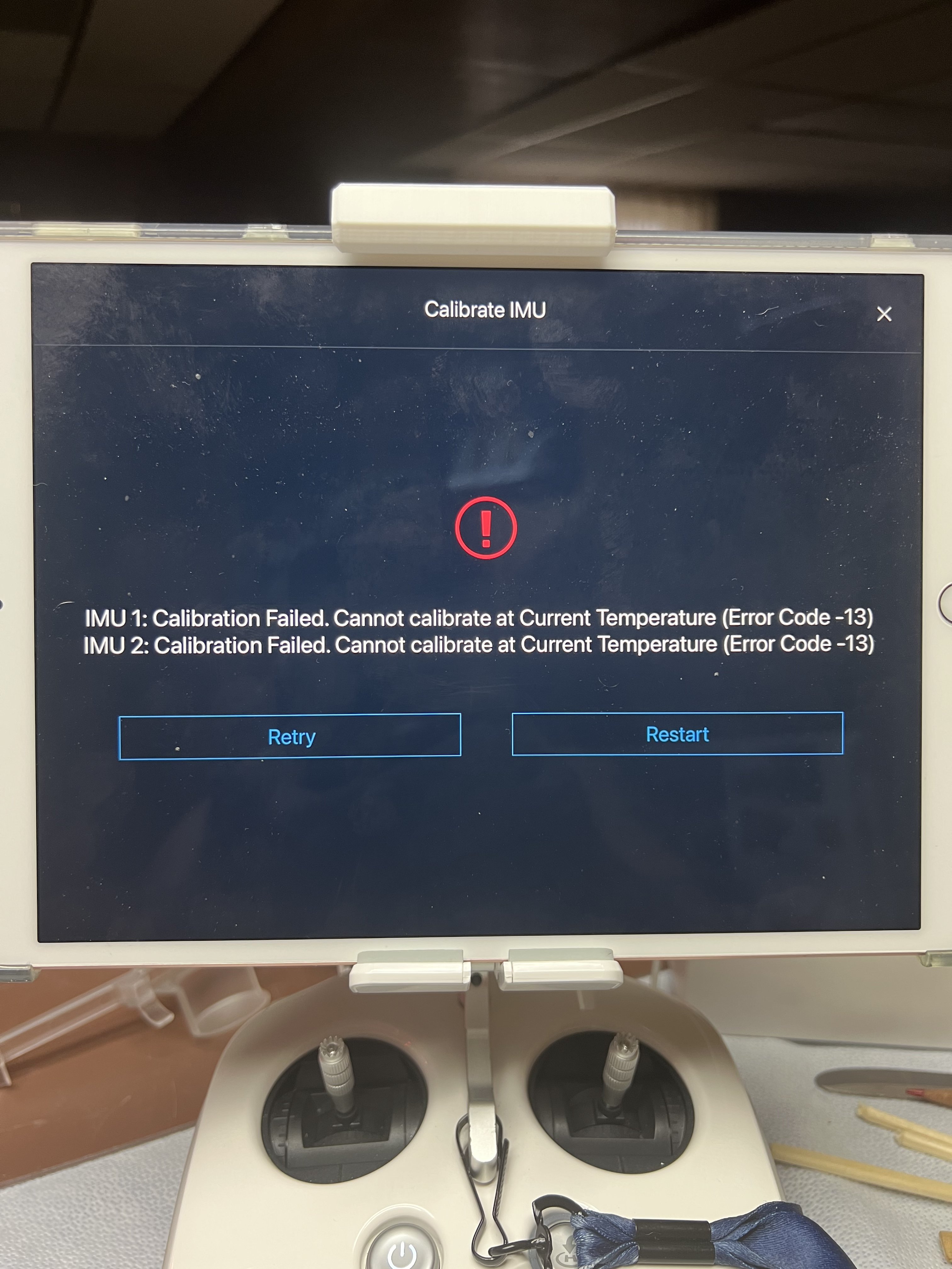

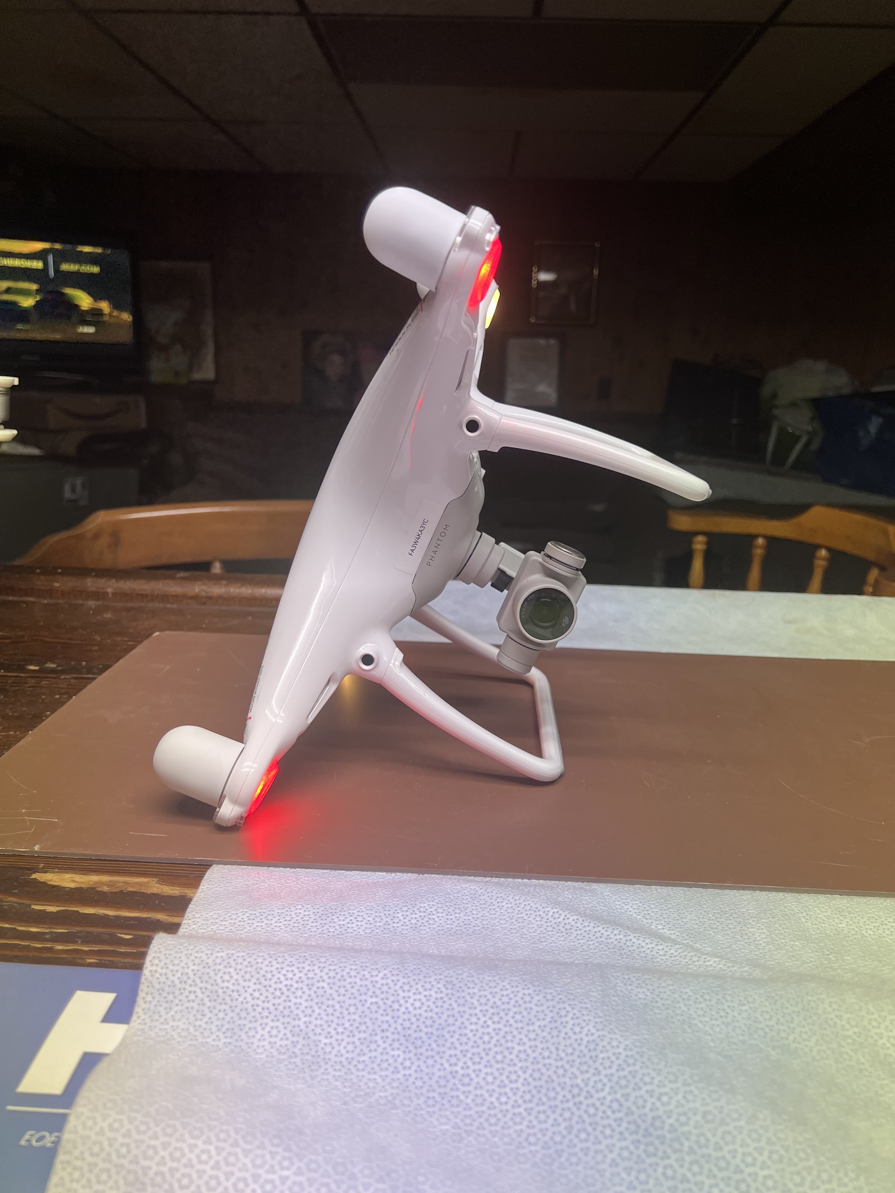

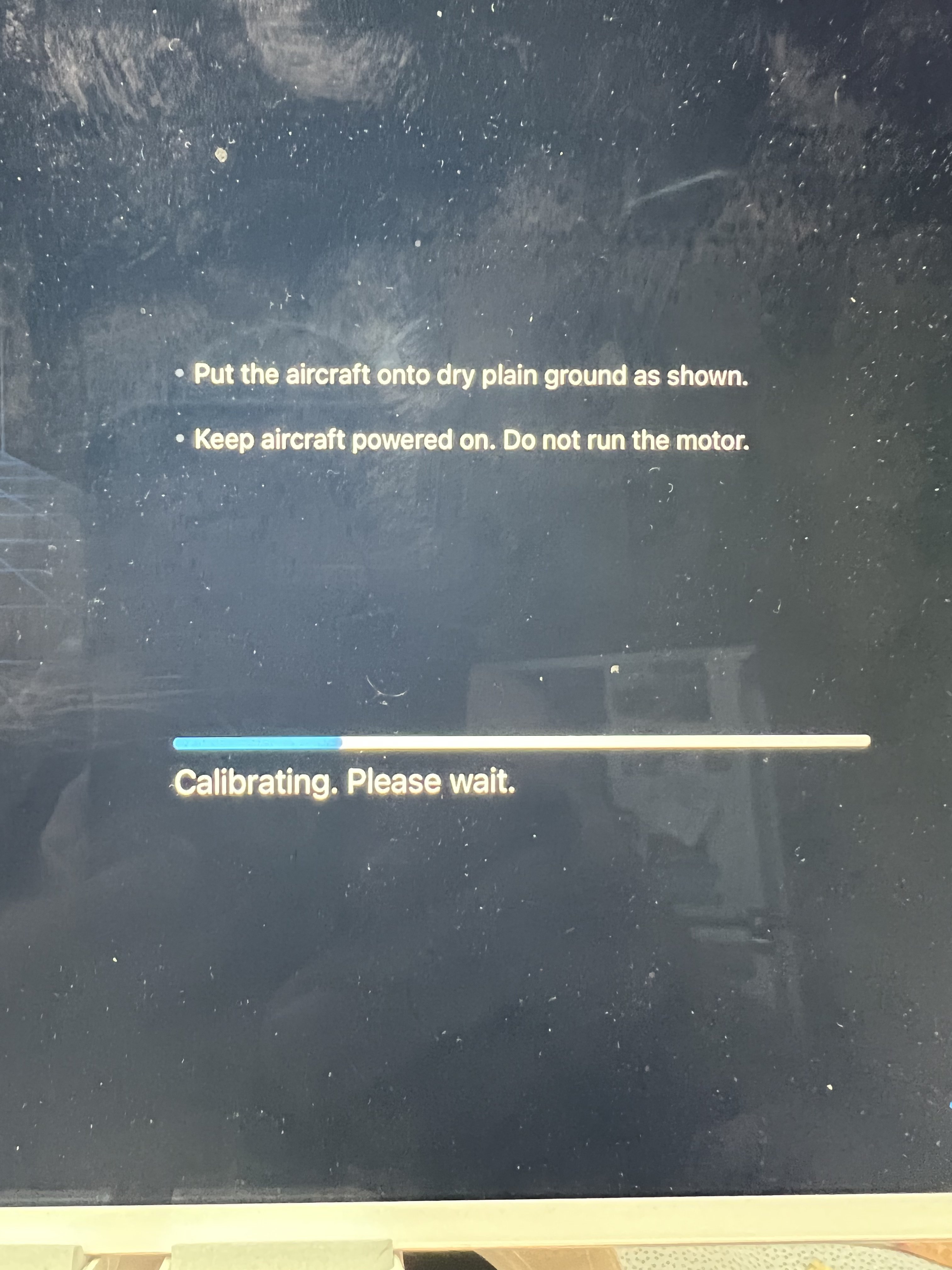

This is as far as i got with the calibration with cold method and room temperature. I need major guidance with anyone who has gone threw this nightmare…

When doin IMU, the drone indicator lights flash fast green to show it's ready for next step,is that happen,can move to next step as soon as this happens instead of waiting for app steps to change position if that part bit slow,waiting can cause a fail from what I just read ,,Its strange how the 2 FC boards are doin this fail,,

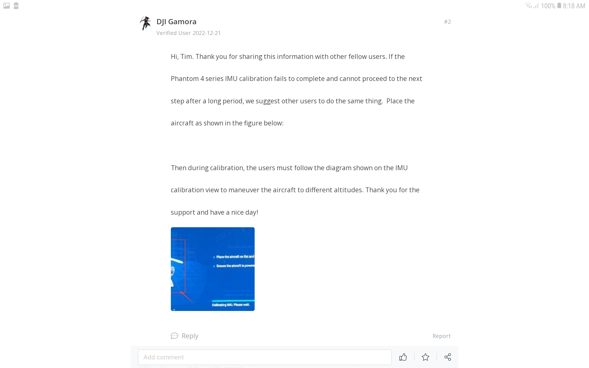

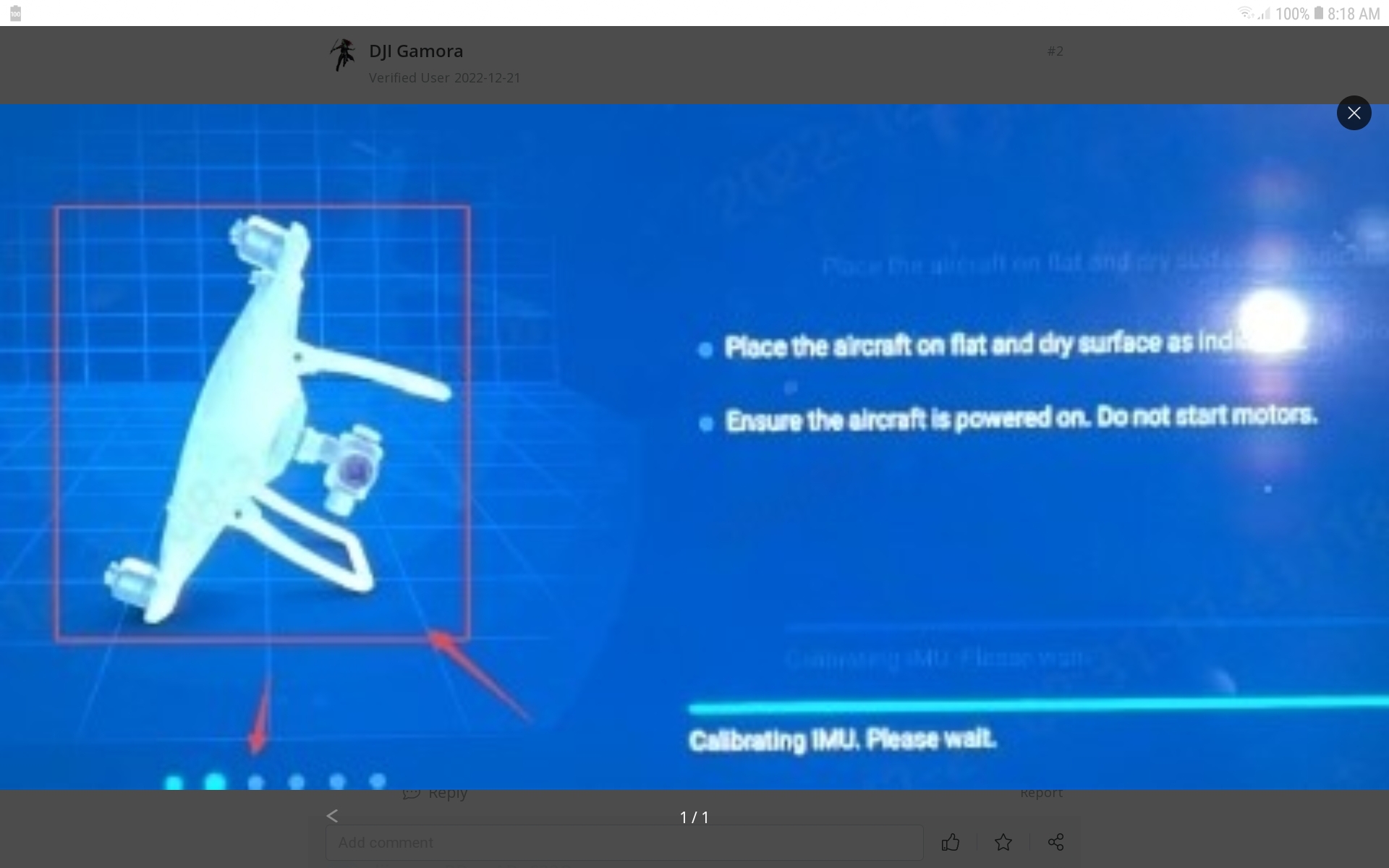

This screenshot of a post with same symptoms show the start of the 6 step with drone on its side to start ,,,try this crazy method,has worked for some,
I know we not had this before since the error 13 was gone and it was stuck warming up but IMU calibration has to be done,,that fail severely piss's me off also ,not sure if gimble board has anything to do with it but seems shock of the fall has done something,,,,
Try that crazy calibration method with drone on side at start and see what happens ,doin nothing today do looks like I'm searching to fix this,

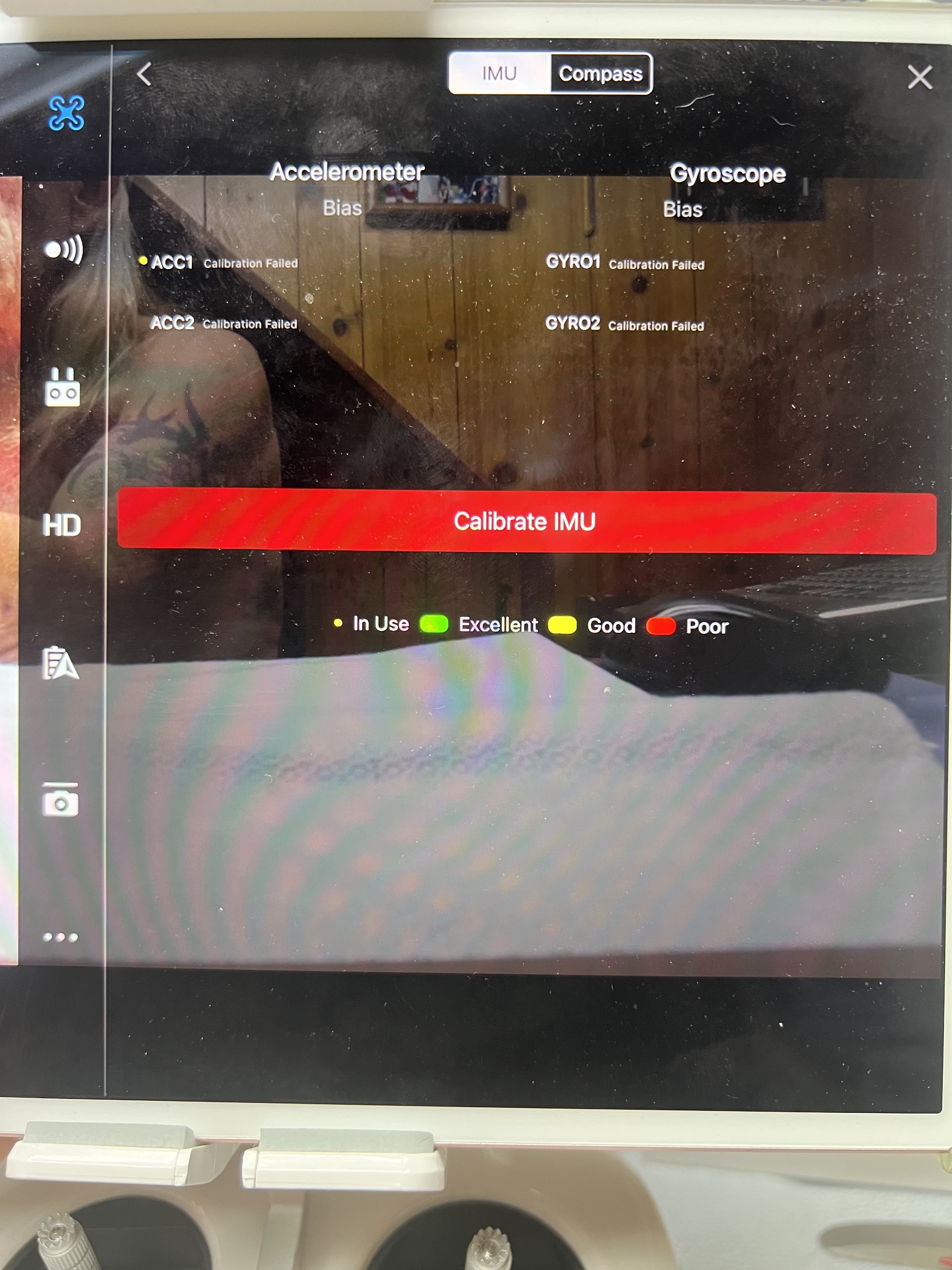

Sorry again for going backwards on this but could mean something else ain't right if both boards give same error 13,,,,,what's aircraft status say,,What does sensors page show,,IMU ,is it working ?

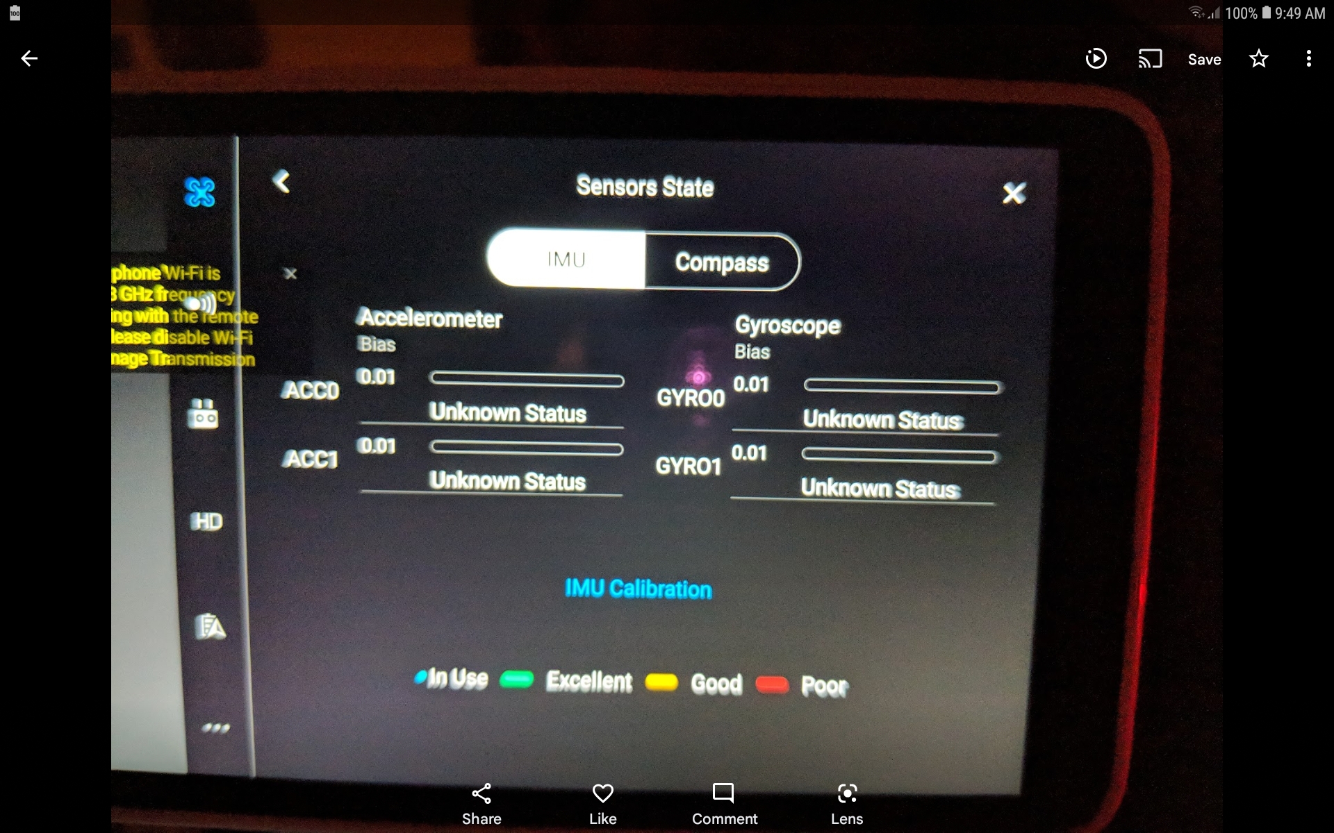

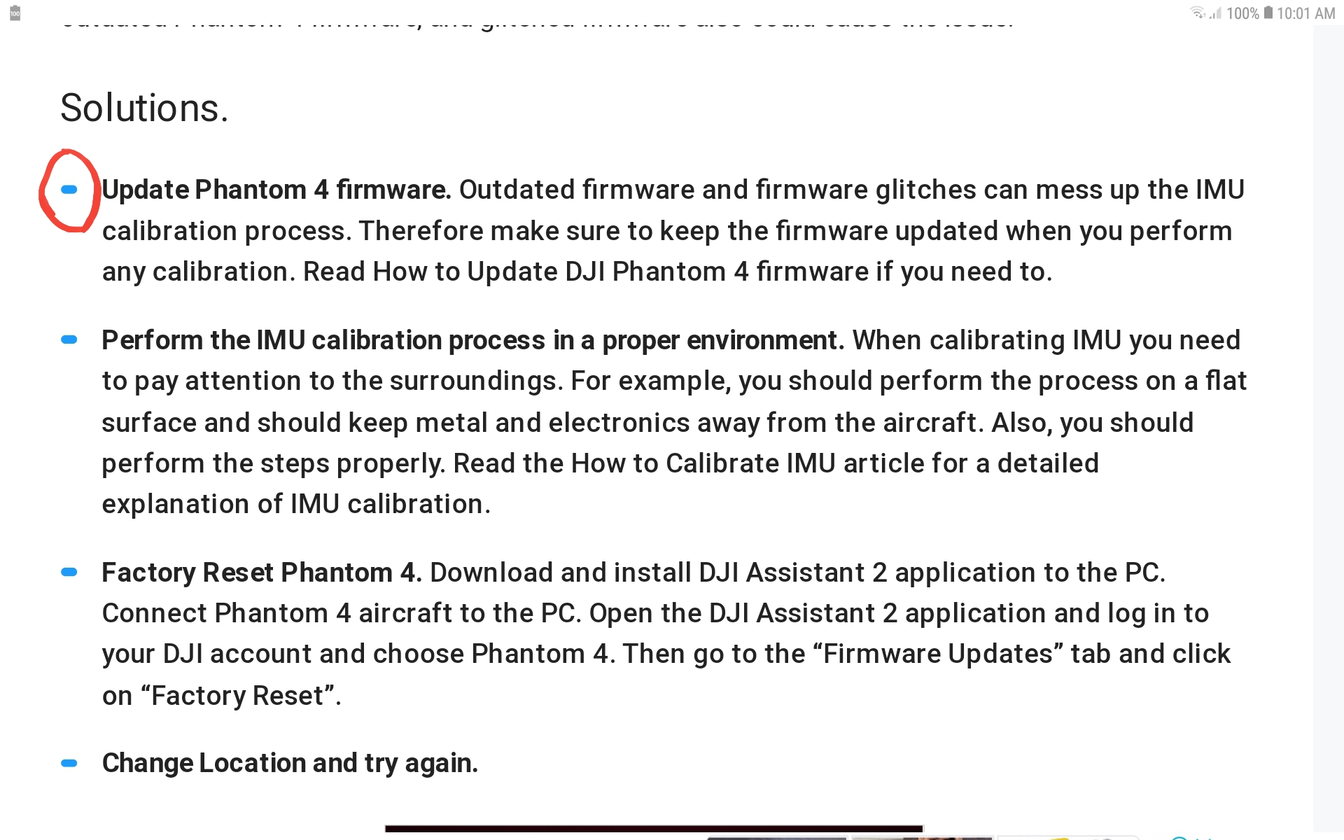

What do you see when in sensors page ? Does it show IMU working ?picture example
How's firmware? You mention that in early post ,,this too can cause IMU fails

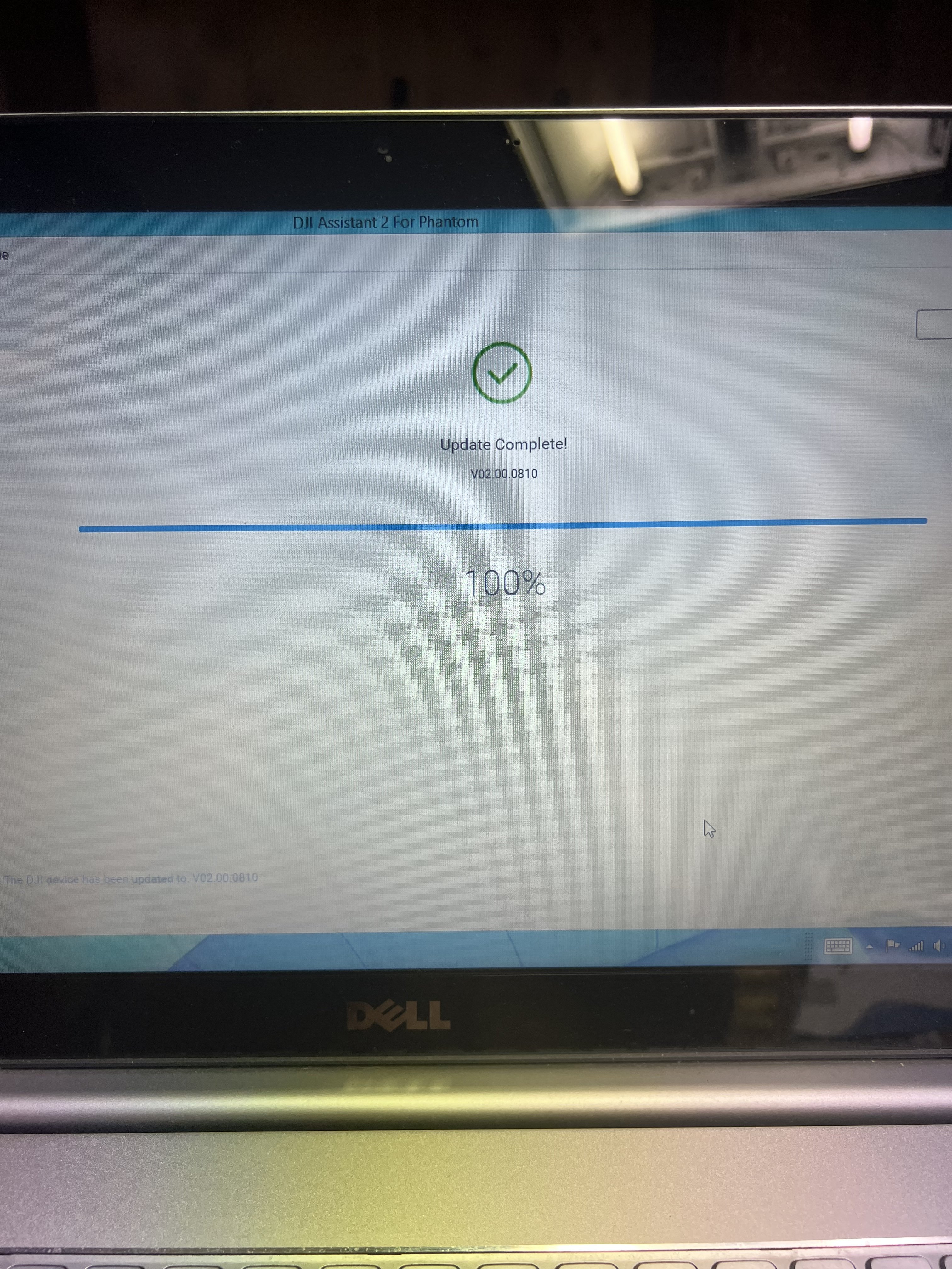

Tried again and failed. I just ran update, so gonna let it cool down a half hour or so and give it another try. This is freaking me out….The calibrate progress quit where i took the picture of it. Cant seem to get past that point in all attempts.

yeh during each step in calibration the drone lights should fast flash green to show that step complete, your picture of IMU show its yellow which ok but not green where they normally are but it is working but telling you to do IMU but failing before it starts,,,same results with different cam ,sorta guides me back to digging deeper into those ribbon cables that go to the FC board,and I know reopening shell gets old pretty quick

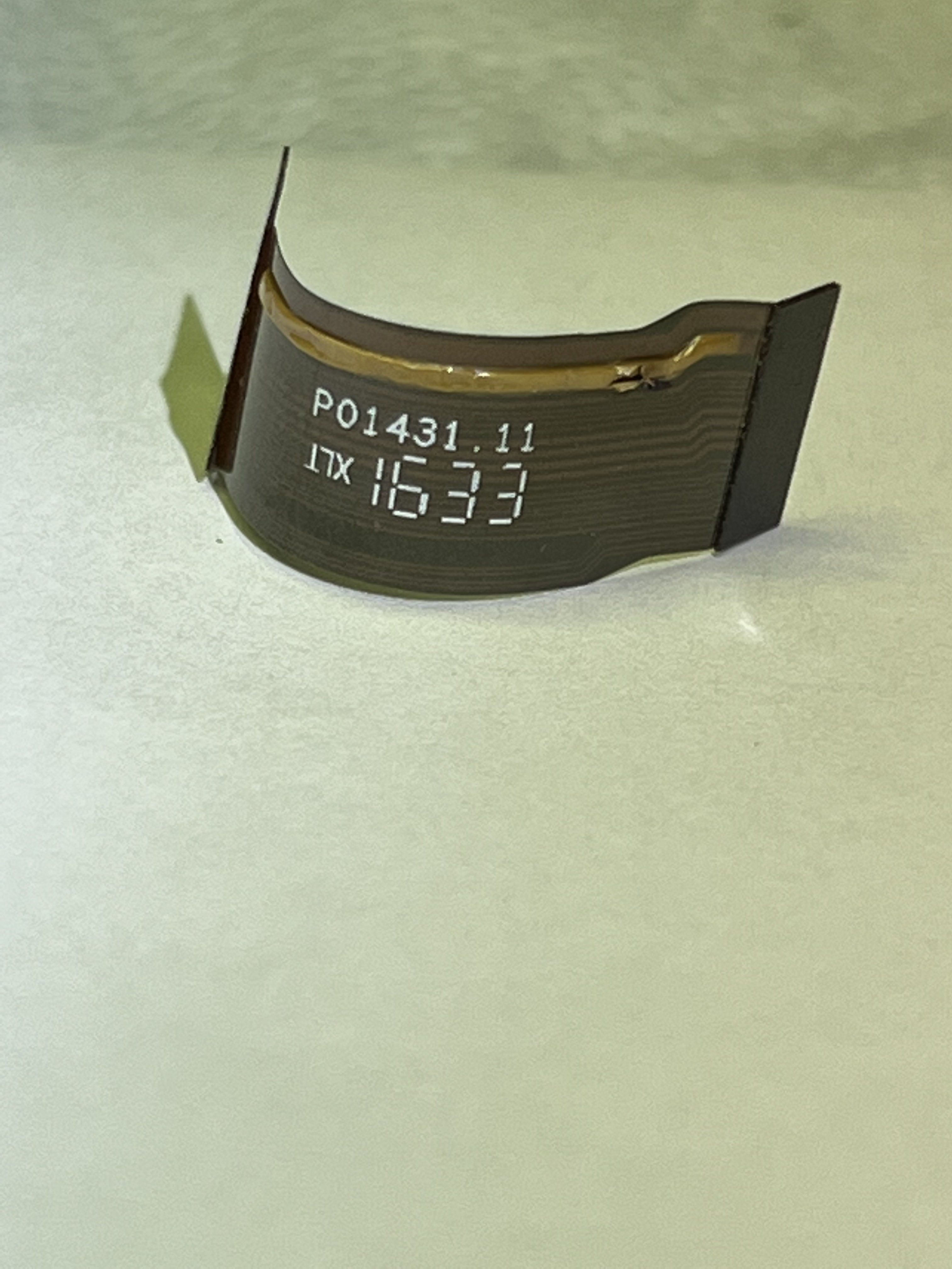

Once again, Ianzone has come through in flying colors. You were absolutely right to have me split the shell and check the power ribbon to the FC. I don't know how but i missed this very important ribbon that was damaged in the crash. It appears to be burnt along the slim power line inside the ribbon. Can't figure out for the life of me how this happened. You have helped me sooooo much and this forum is lucky to have pilots like you with your knowledge on here for newbies like me. Thank you..Thank you… Thank you. I dont know if would have been able to go through another IMU failure without loosing my marbles…Please continue to post and help people like myself who need support for things we just don't quite understand the complexity of these Aircraft. Now im ready to tear anyones apart and fix them up…he he.
Thank you sir for kind words,ha yep I'm persistent in getting to the bottom of things and just come back to check on this
SO the big question ☆ does everything work now ? ☆
