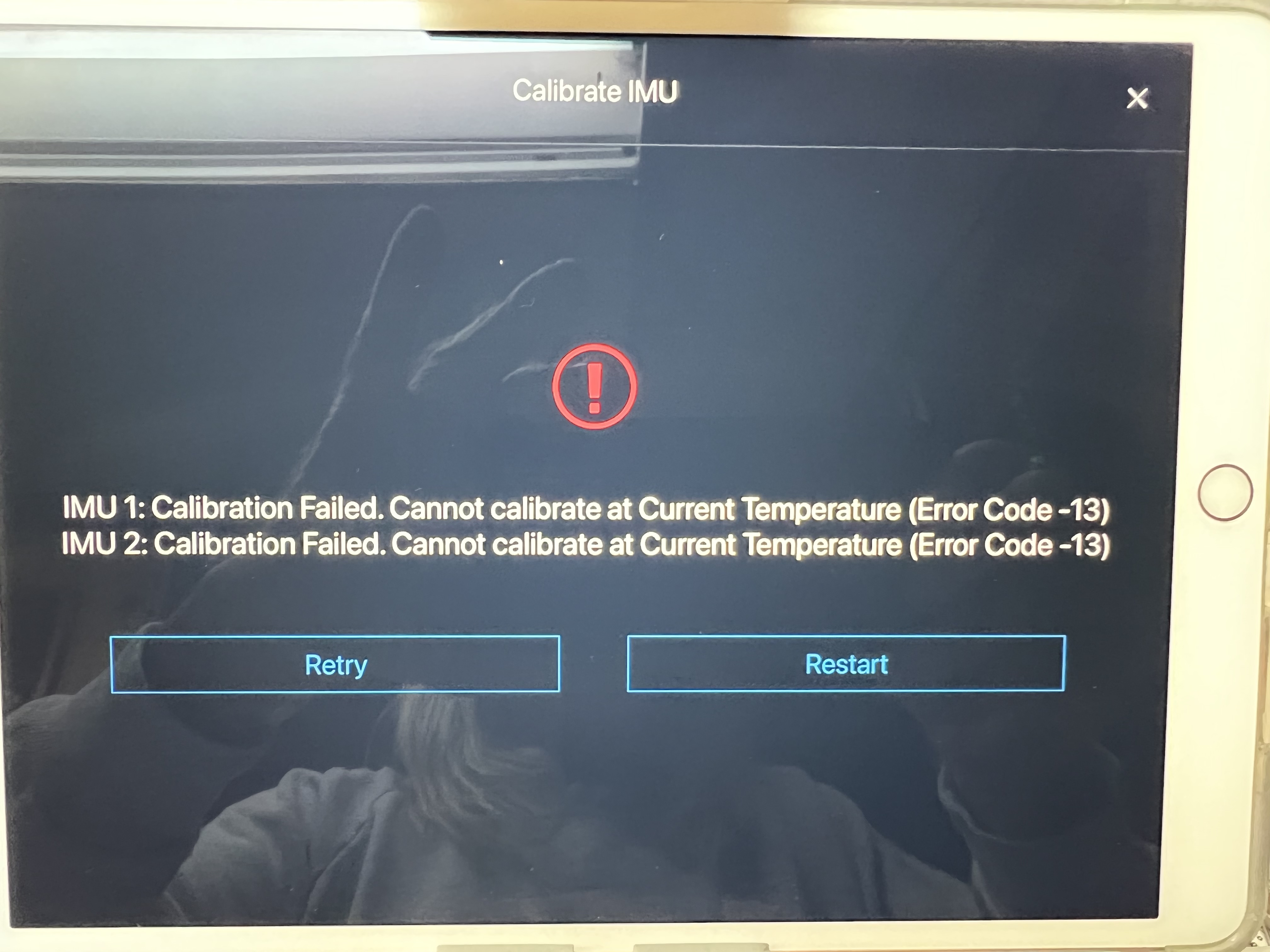

OK, Trying to calibrate the IMU. After about 4 mins. it flashes error (IMU 1: IMU 2: Calibration failed. Cannot calibrate at current temperature (error code -13). This has been the status for about a whole week now in ice cold temp, room temp, and all the other poster's tricks and idea's. All i did to the drone was replace the camera gimbal power ribbon and i did use an OEM DJI ribbon. Im so frustrated and stumped that i can't figure this out?

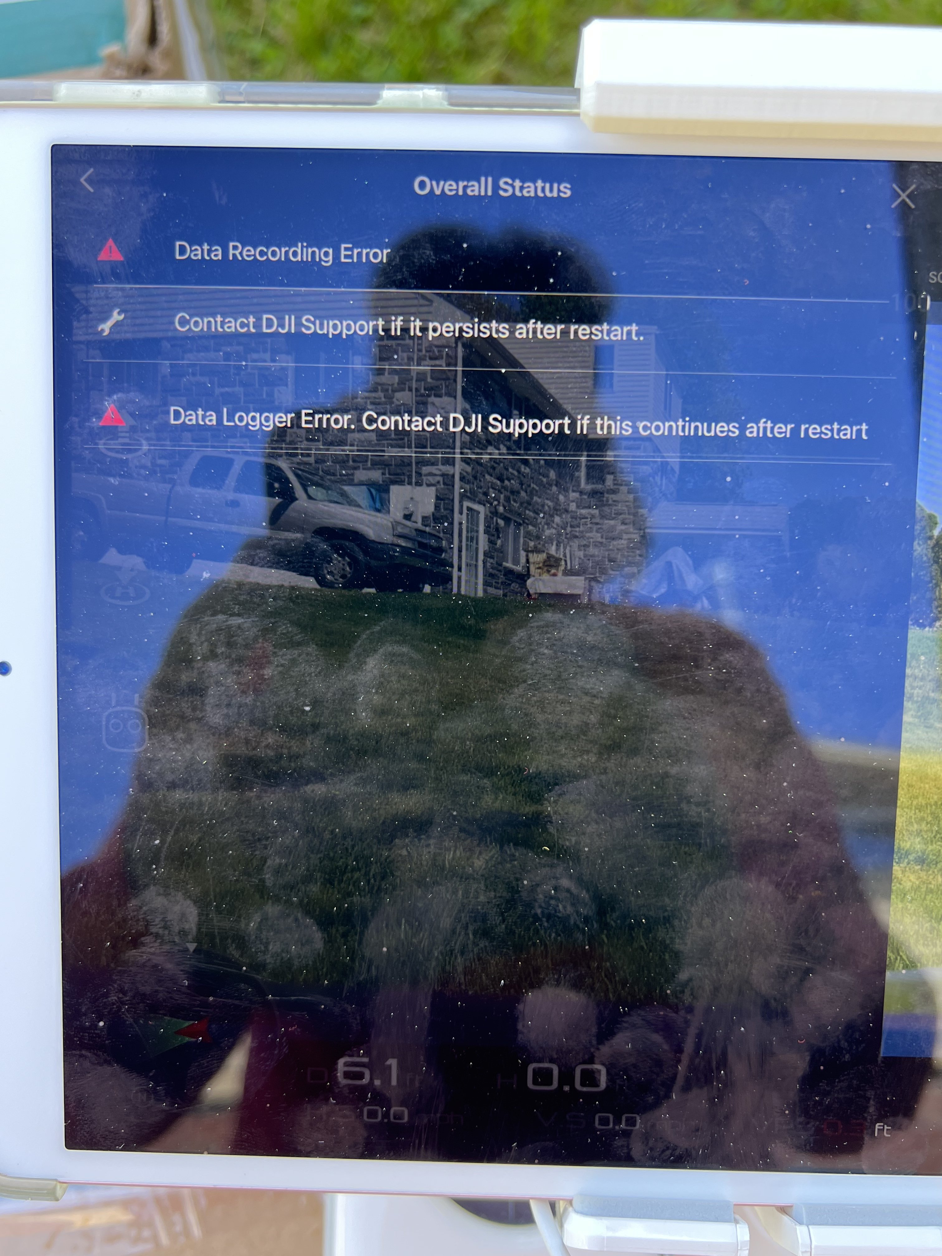

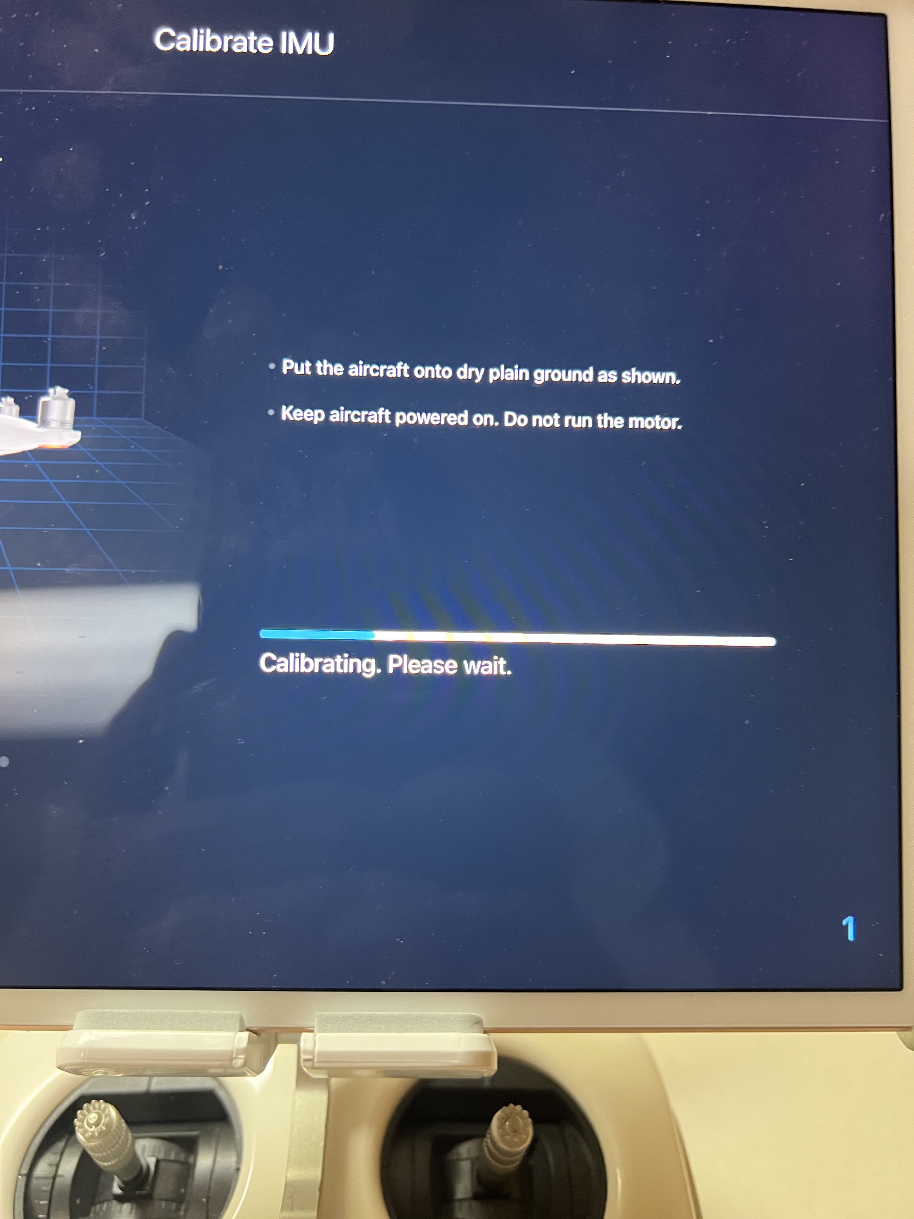

I got rid of the first two errors..(Main controller data error and Data recording error) by replacing the 4 gb card on the board. Now trying to get the IMU to calibrate but this is as far as i am getting with the error popping up after running for about 4 mins.

Battery fell out at about 80ft in air and free fell to the ground. This was a brand new unit I bought last year that someone never used. The camera hit against gimbal top and pushed it up breaking the screws that hold the dampner. I repaired that and bought a new OEM gimbal flex cable and repaired that. Once i powered it up it was giving me the first two errors. Data logger error and data recording error. I replaced the 4 gb card in the board and it actually let me take off and fly with no problems. I changed battery and turned it on a got the IMU needs calibrating warning. Thats where im at now. Cant seem to get it to Calibrate.

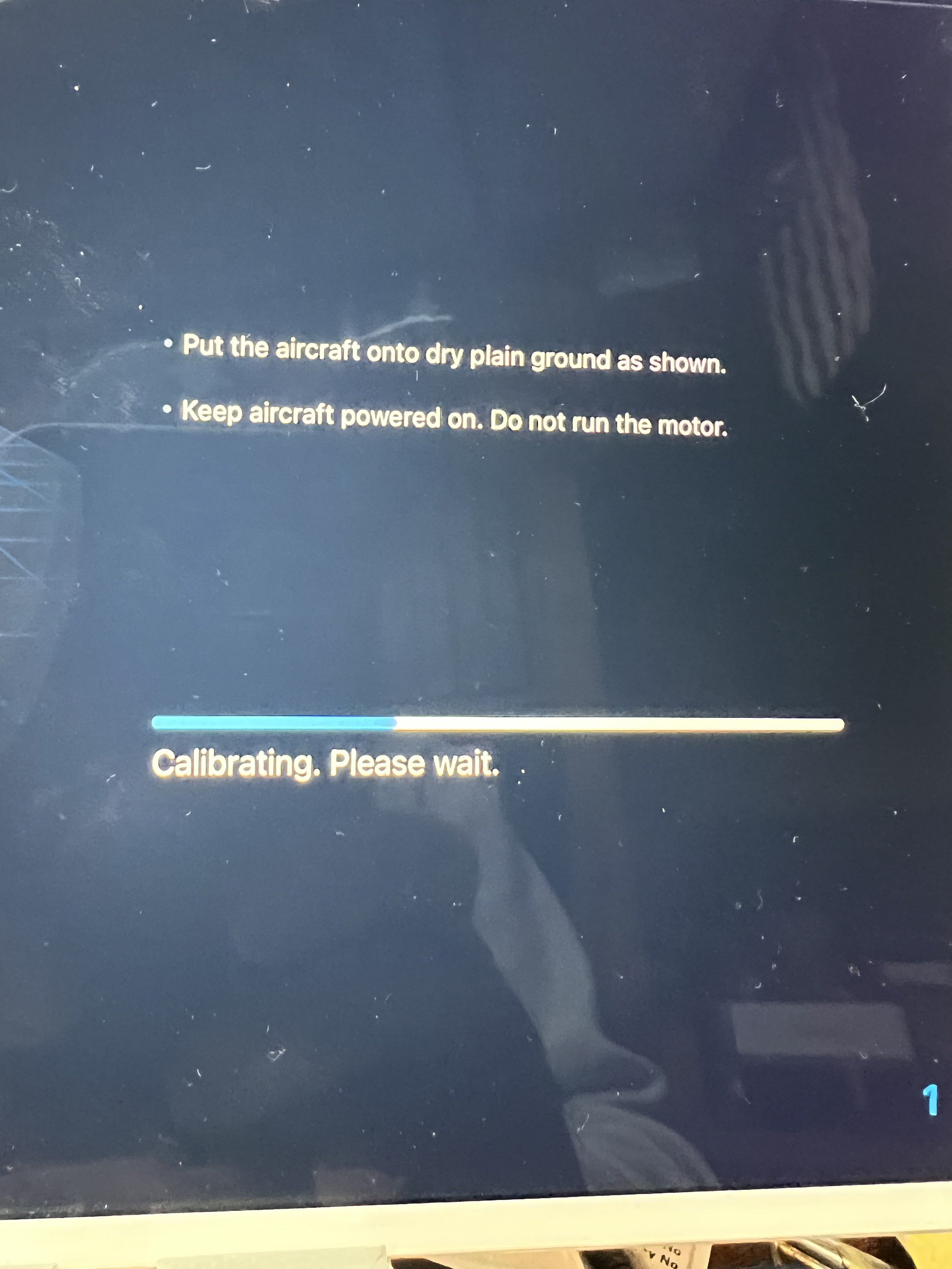

So I took the camera down and inspected all the power cables and everything looked fine. I tried the recalibrate again without the camera installed and it got allot further than the previous try before it failed again?
