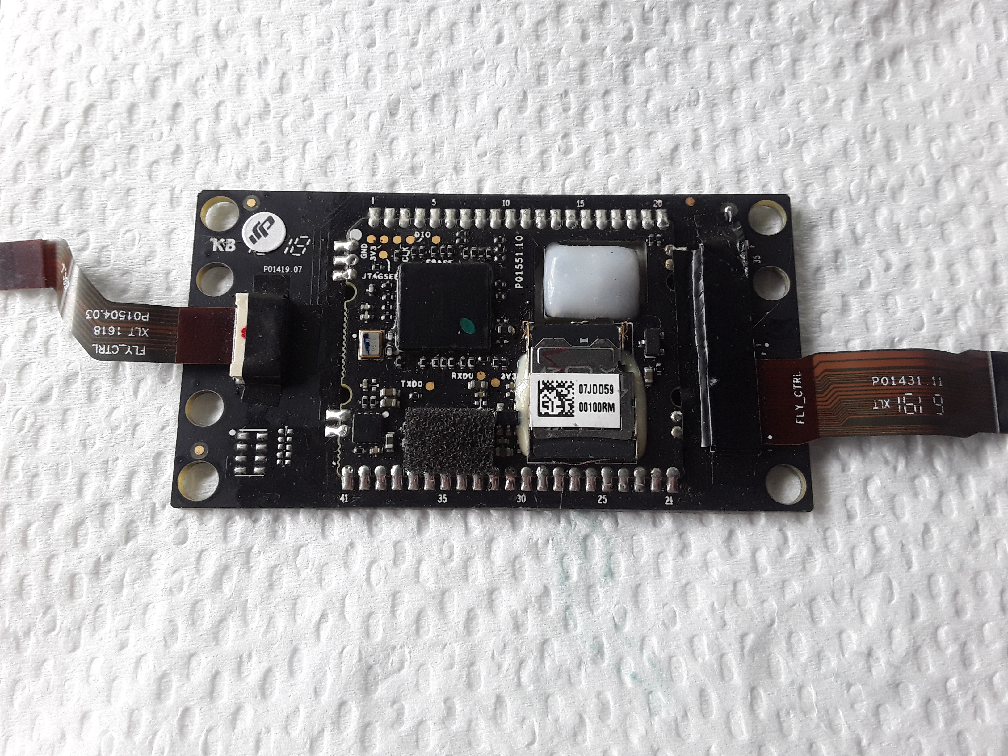

It does suck not having another board to try or do you,me learn can guess all day long and get no where without changing and eliminating,,not sure what board worth but I do have a p4s one sitting here with a fan,,,Not 100% sure its compatible with Advanced,,looks same but different number code,,probably fit your ribbons,,,If you cant purchase one for reasons and if there no one closer that can help I might send you these to try,,,,probably no charge ,,Better if someone can use it,,
Someone might chime in yet with a fix but if you get stuck stuck,chuck me a message and I'll send them out 2 you...View attachment 125036
That looks exactly like mine. Im not sure if numbers not matching mean anything. I do know that P4’s will only fit P4’s.. every other Phantom model is different in the ribbon connections. When i did the gimbal ribbon cable it was a different number but the exact fit. My camera and all its motors work perfectly now. This is so nice of you to offer your board to me. How can we work this out?
P4S will take all the P4 ribbons.
I'll send you a message ,,just add you delivery details,,
Up 2 you ,,if you want ,, reply to conversation message I sent,,no charge,,happy to help if you want

I thought the Advanced and up only had two connectors on the board?

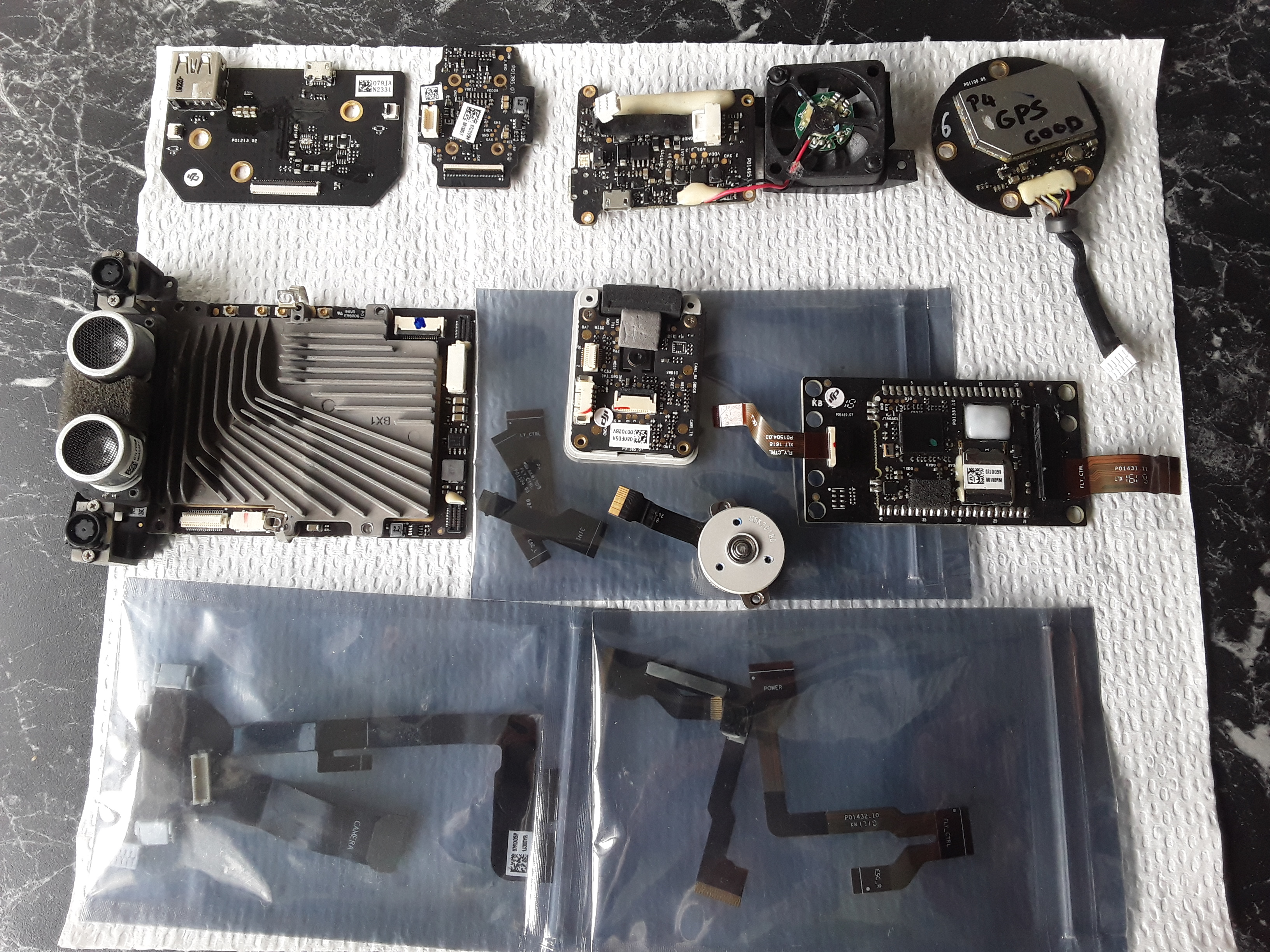

Found more bits,,,these are all p4s ,,,yours if you want it,unfortunately I cant use for anything
