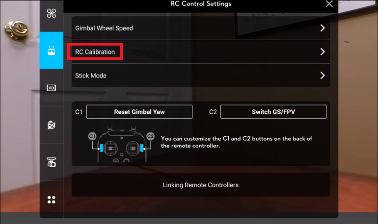

    Calibrate the remote controller (RC)? Please tell me how that's done.

  6. JimBir
    Sep 19, 2015
    46
    5
    Western NY
    Thanks. Followed all the steps above. All went well. Bird still flying great.
