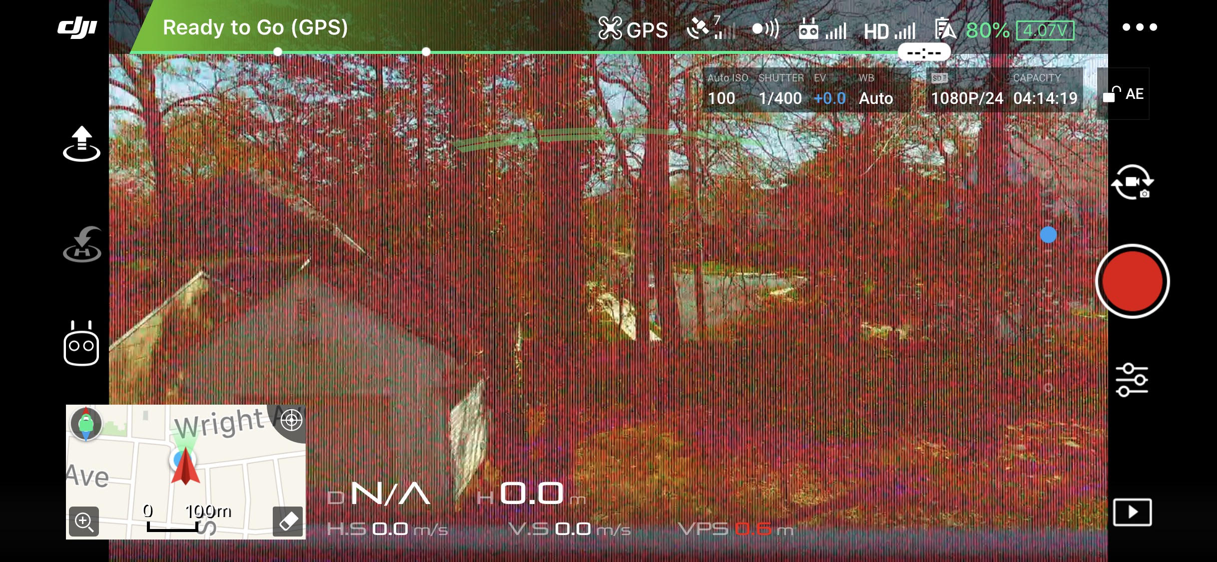

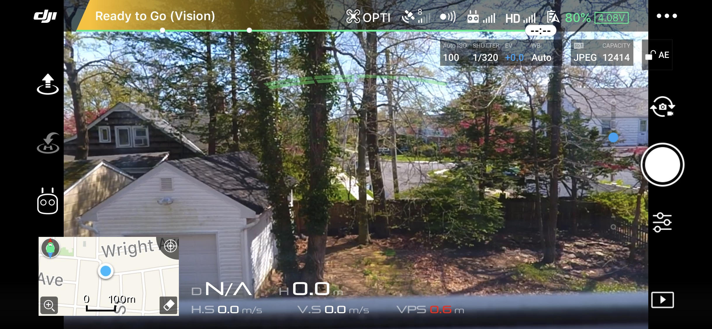

Hello, i have a Phantom 4 that i stopped using for about a year, i just charged the batteries and downloaded new firmware on the aircraft, remote & cell (iphone X plus and Iphone 11 pro) the drone flies perfect the problem is when i have the Camera to take PICTURES it looks great but when i switch it to take VIDEOS the image looks really BAD! anyone has any idea what could be the problem? i attached both pics for reference thank you in advance!

Ok , maybe you forgot tap to focus on the first picture and definitely the red demon spider on the second. :(
I was experiencing black and green flashes on the display. Tried re calibrating everything to no avail. I tried switching the channel frequency from auto to manual, then selected a channel that seemed stable and the image and video was perfect.
