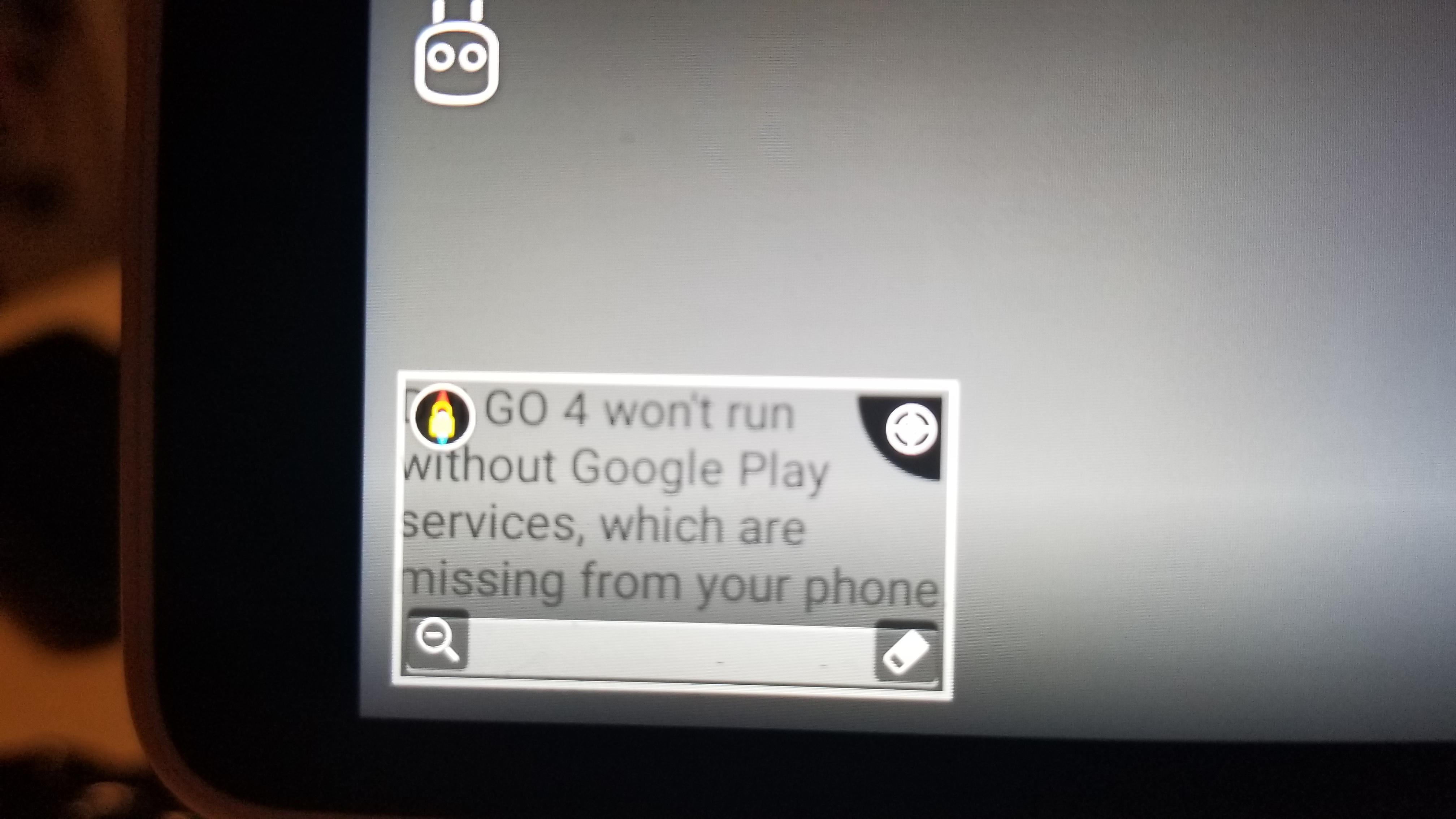

[/GALLERY] I haven't seen much on the p4a plus and I am beginning to understand why no one buys one. I have been struggling with every step of getting this thing working, and after a day, I am about ready to box it up and throw it in the lake or return it.
Here is my current issue.
I have downloaded and updated all the firmware, controller and drone.

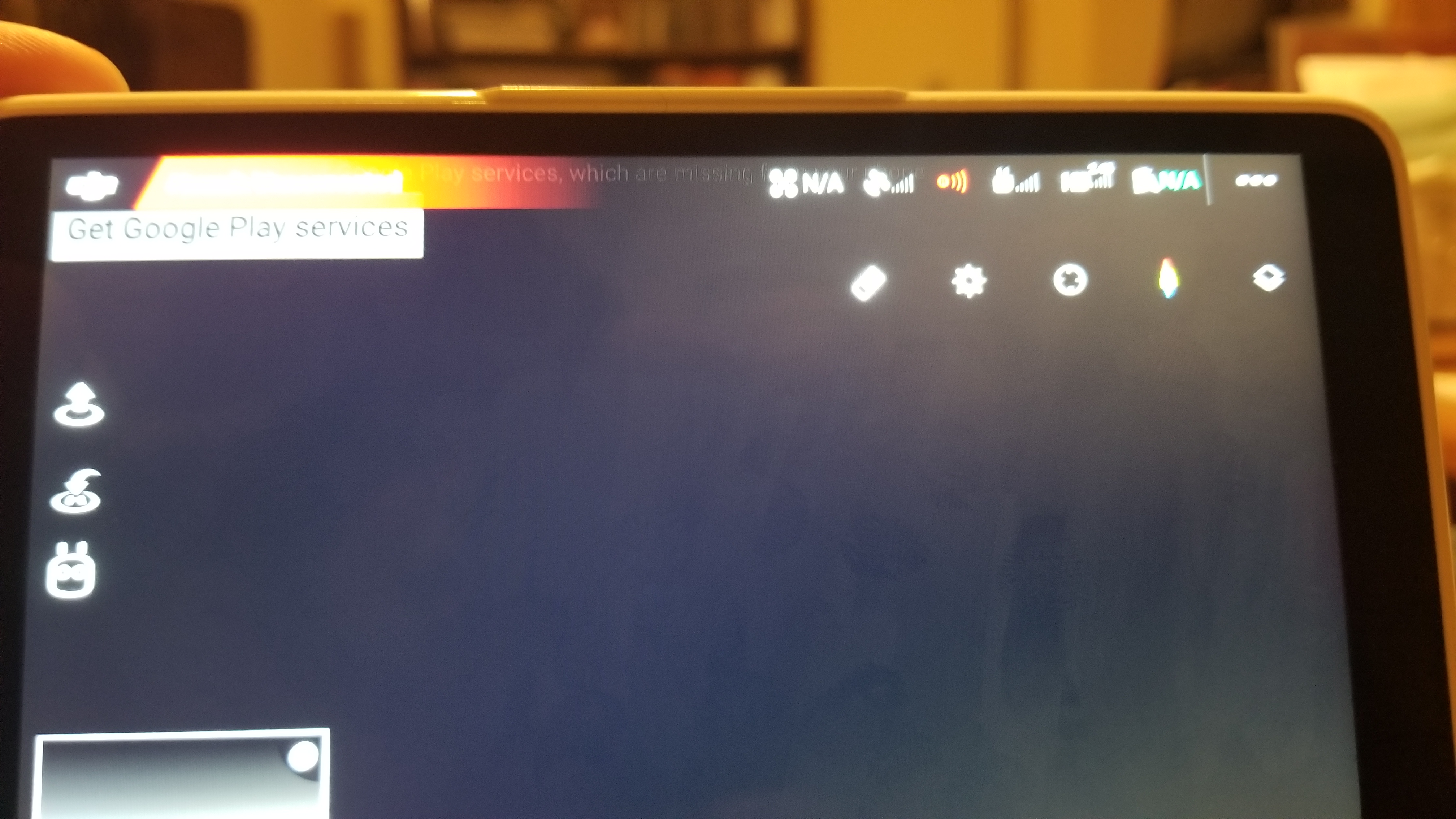

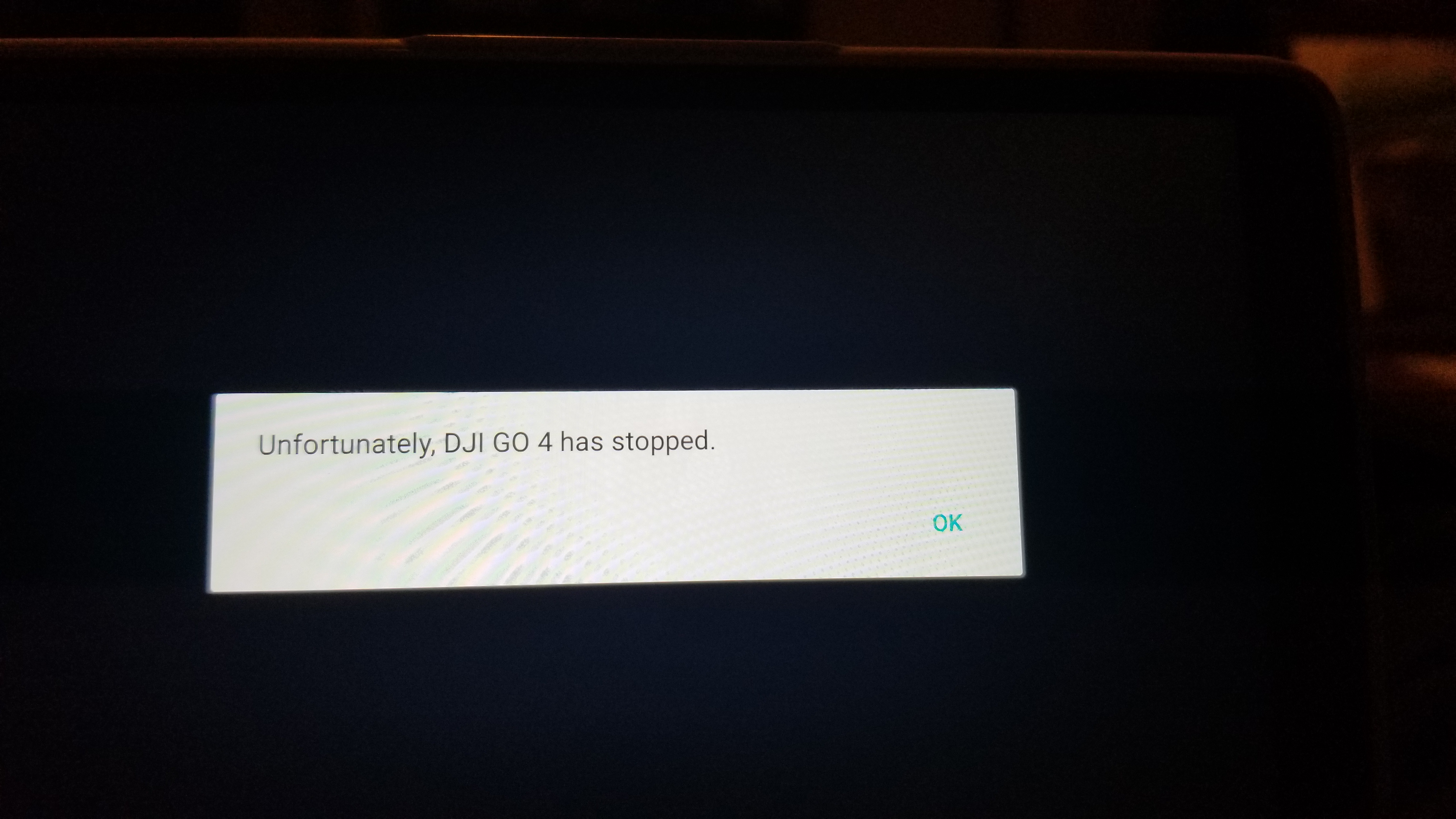

When I connect to my drone, where my map is, it says I need Google play on my droid to access the maps. When I click on it, it says "get Google play" so I click on it and everything crashes. When I try to download Google play from the internet, it says it can't because this device is not linked to Google.
Here are some photos.
Please help
I haven't seen much on the p4a and I am beginning to understand why no one buys one. I have been struggling with every step of getting this thing working, and after a day, I am about ready to box it up and throw it in the lake or return it.

Without opening the app open google play and d/l google play services
As I stated above, Google will not allow me to download it. When I search on the internet for 'Google play services ' every link I have found takes me to a generic Google play store on the web browser, not through the Google play app. Google will not allow me to download because the device is not linked to a 'Android ' device.
If you know of a link that will allow me to bypass this, please share.

Did you try going into the remote controller settings and doing a factory reset?
Just did a factory reset.
All is working perfect.
Thank you for helping me out.
I have no idea what is up with this thing, but after the reset, everything is working the way it should be.
Thank you again.

So, last night I ran the factory rest. All was good. I got up this morning and went to use it, and it told me I had an upgrade for the dji go 4 app to upgrade to version 4.1.15.
After running the update, I lost my map again. It gave me the same message that Google play is not installed.
So I ran the factory rest again. I am just going to avoid version 4.1.15 for now.
