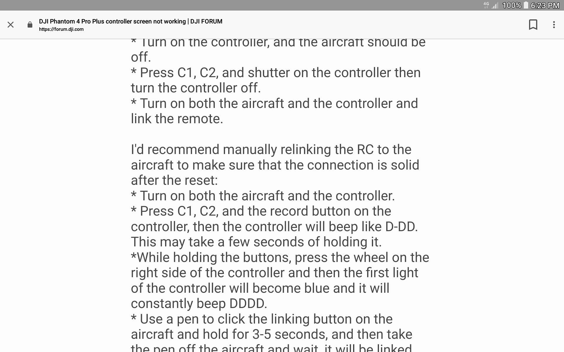

how are you trying to link ,with the app under rc linking ill attach a manual link aswell that not need app to link

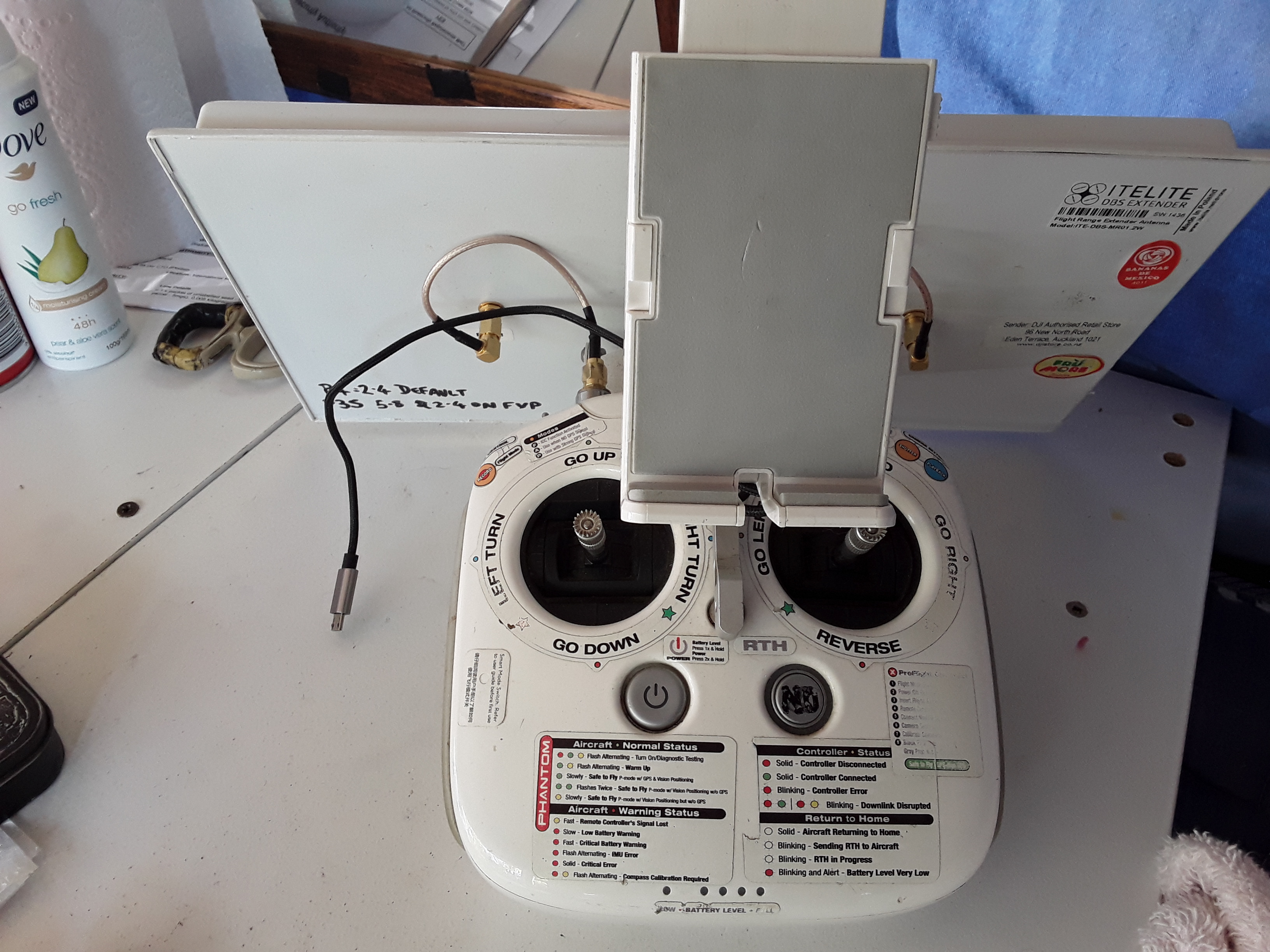

That antenna thing is HUGE! you also have a lot of stickers on that thing! Are they helpful? I honestly just memorized what everything does on mine. And also how much extra range do you get with the behemoth antenna?
I have never tried long range but it fly way out off my sight very easy but I do keep it close nowadays,I hated to 2 antenna that poke out the top,my device used to sit on top of them,this panel was best thing I did,,my device Samsung 10/1 so you know you holding remote,I do you neck brace for it just cause the weight,,the main purpose was to have transmission free problems and no disconnects and works flawless,,can get amps to boost them but not needed,heavy now,,I do keep a new stock remote working so I can just link either but can see that getting treatment too
