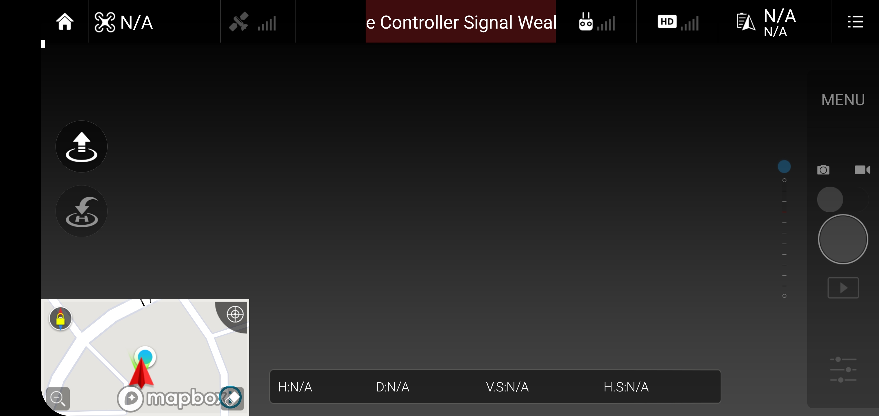

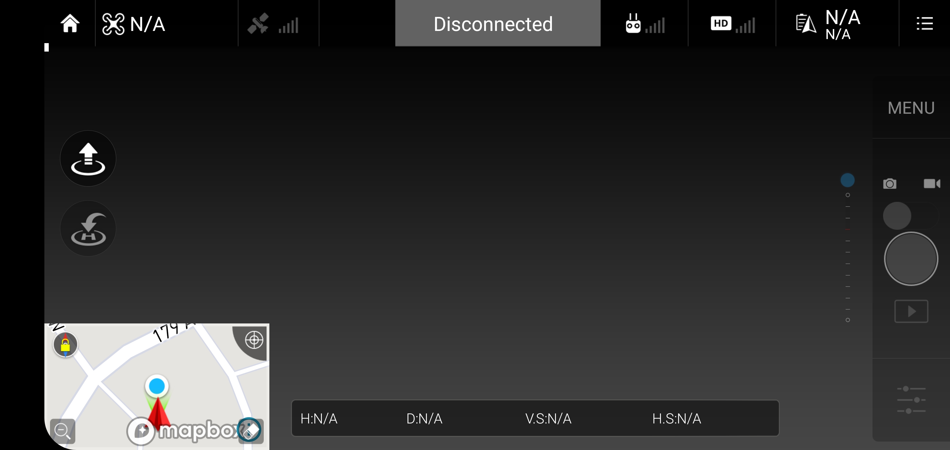

If you see this screen then the remote is NOT communicating with your phone/tablet. You will need to solve the USB issue before you can go any further.

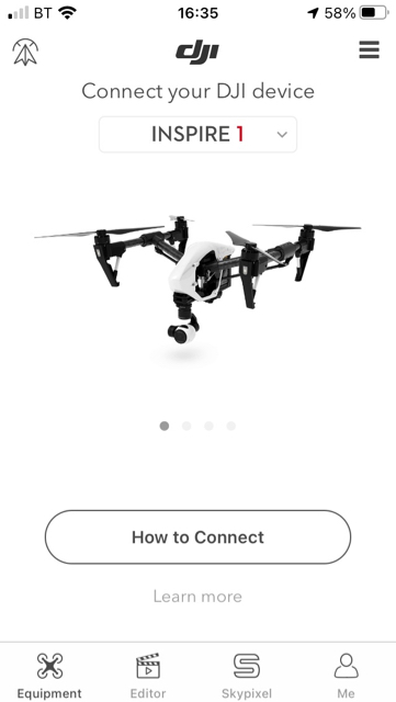

Have you loaded the DJI GO App (NOT the GO4) onto your iPhone, the 8 should work OK, can you open the program? You will get this screen:
When you turn on the remote, do you get 1-4 white battery lights and a RED left hand light. If you do that's all OK.
Reactions: JoBe
If you see this screen then your USB connection is working properly, this screen means there is no connection between the remote and aircraft.

Have you loaded the DJI GO App (NOT the GO4) onto your iPhone, the 8 should work OK, can you open the program? You will get this screen:View attachment 121163
Batteries all up to 90 or better. app is up and How to Connect is only option. Tried the long push on upper rt corner to display firmware current and downgrade option. it pops up with no options just long code. tried getting files from itunes tranfer from GoApp and Litchi all are encrypted or empty.
