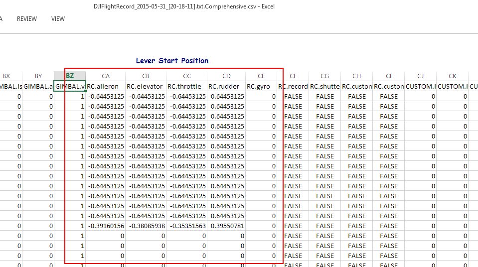

Thanks flyNfrank, but I don't have of those fields in my CSV file. Maybe I've done something wrong - I've taken the flight data TXT file from the app on my IPhone and have run it through the log converter at flylitchi.com. The output only has about a dozen fields in it, lon/lat, altitude, speed, distance etc. Nothing relating to the controller etc.
Am I doing something wrong?
The flylitchi website currently only focuses on the common data categories for dashware, and mirrors Flytrex's data profile. There are other websites that convert the files in greater detail. However, most all of them have a ways to go to being dialed in with displaying data correctly in each column.
