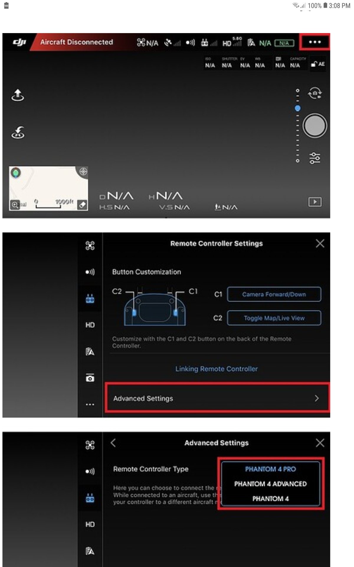

Make sure in app that p4p has been selected under " RC" then try link,,, if no luck do hard reset on remote then try linking again....
I can't get to what your showing me. "Remote controller Linking" in blue is my last option on that screen. I don't have the "advanced Settings" in my controller for some reason. I'll try the hard reset. Thank you! I even tried a different connection board, checked connection on the ribon cable. I'm reaching! hahaha Edit... I did find the Advanced settings. I had to agree with my device to hook to "inspire 1" when this device is being used. Once I agreed with it, Advanced settings showed up. And "Phantom 4 Pro" is selected.
Reactions: RodPad and IANZONE
Ok, I now have drone linked and camera on screen. For some weird reason, When I plug my phone into the controller a little screen pops up stating something like" Do you want to use this App for inspire 1" I have to click "ok" for the stuff to work. If I try to change the app to "Phantom 4 Pro..." it won't work! Hahaha I just tried a take off with no props and the motors fired up. I also have a "No fly one" warning since i'm less than a mile from an airport. And I have errors, but it was crashed so that's expected! Thanks guys!! I at least have progress now!
