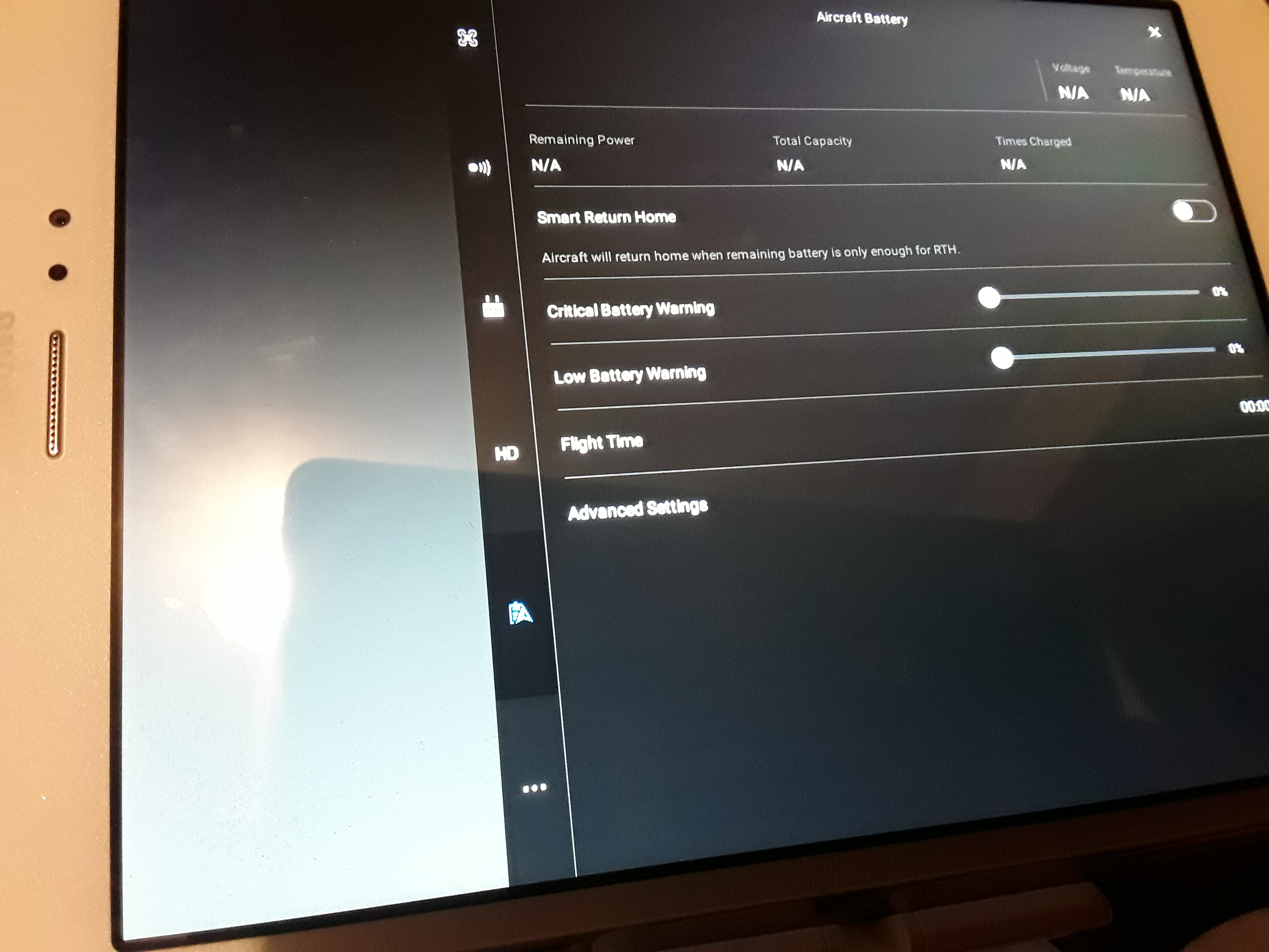

DJI has done away with the option.

Unbelievable [emoji31]. Brian I see mention of 'firmware' being the problem (change). However from what I have read, and your info - it's the App that's changed (resulting in loss of option for Smart RTH) <not firmware> correct?
I ask constructively as saying its firmware problem appears to be incorrect, it's an app problem that needs correction, mis-describing it may just make things worse with DJI whom appear to struggle with specifics anyhow.
Added: I mean no disrespect but firmware and software are quite different, but broadly similar things cheers.
if I roll the app back to 4.05 it's still in there - right up to the point I start the aircraft and then it disappears which suggests it's firmware not app related - does that help anyone?
The ability to turn off Smart RTH has been removed on the P4Pro.
This essentially prevents any waypoint missions from completion and also halves the flight time
If I understand correctly, this change does not "prevent any waypoint mission from completion", nor does it cut the flight time in half. Yes, Smart RTH can kick in when the remaining battery is 55% or higher, but that only happens when you are a very long distance from home. In those situations, your flight plan would probably have you returning home somewhere near that point anyway.
I agree that this change will certainly compromise waypoint mission range by perhaps 20% or so, but that doesn't mean that "any waypoint mission is prevented from completion". Based on the instances when I had Smart Return to Home engage in the past, I'd say that I still got almost all the the range I had planned anyway. I don't like the change, because that means I have to plan somewhat shorter waypoint missions, but the change doesn't cut flight time in half; probably only about 10 to 20% reduction.
