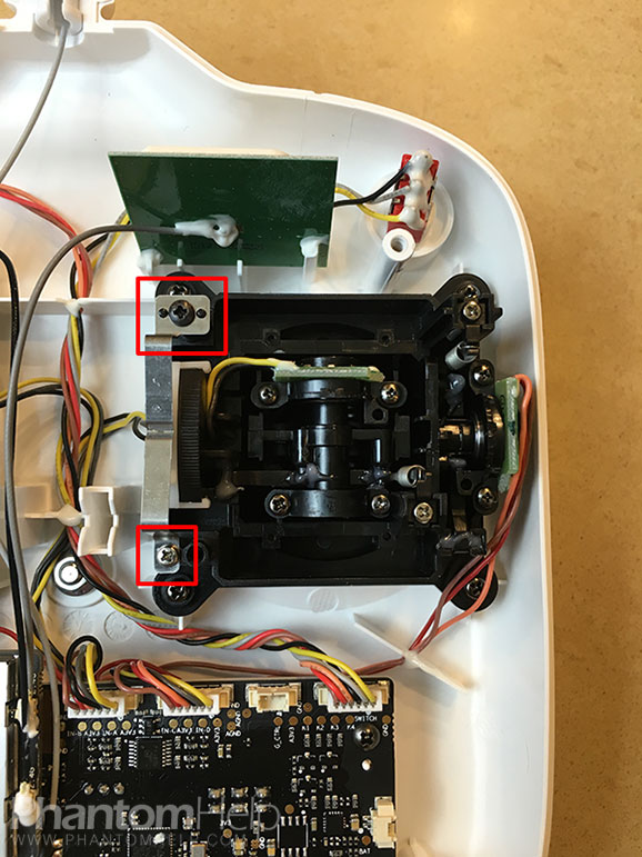

Step 3: Remove the throttle lock mechanism
Use a Phillips screwdriver to remove the two screws that are holding the throttle lock to the remote controller.
Keep the throttle lock and screws in a safe place -- in case you decide to reinstall them in the future.
