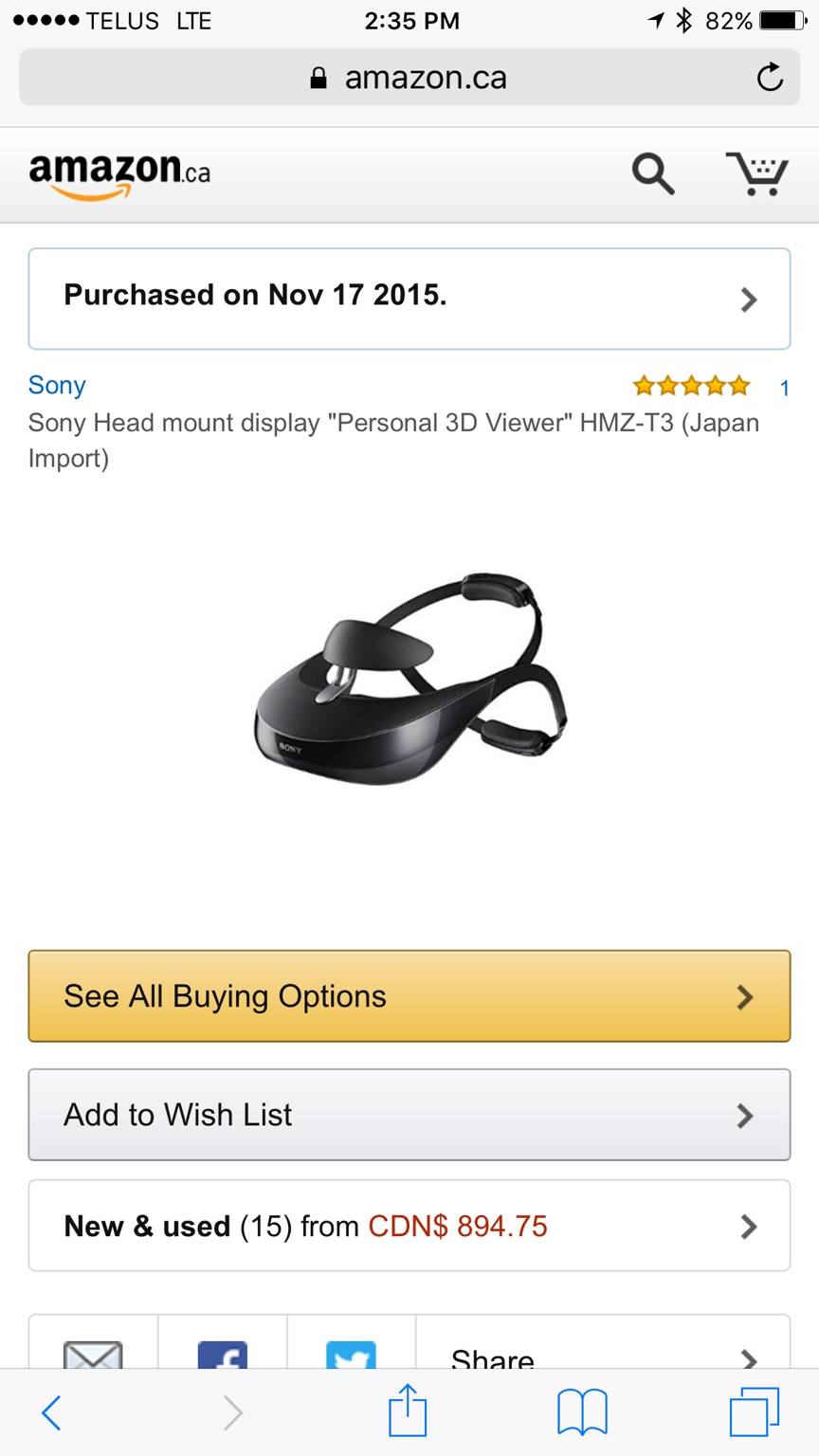

I upgraded to the P3P about 3 months ago, but for the 6 months prior to that I had a P3A and I do have the HDMI board an have flown FPV with both this,
and this,
and having nothing to compare it to - I thought both were amazing...
But now that I have the P3P, I realize that there were dropped frames in the P3A feed and there are almost none from the P3P. It really wasn't something I noticed at the take though. I think you'll find it very useable!

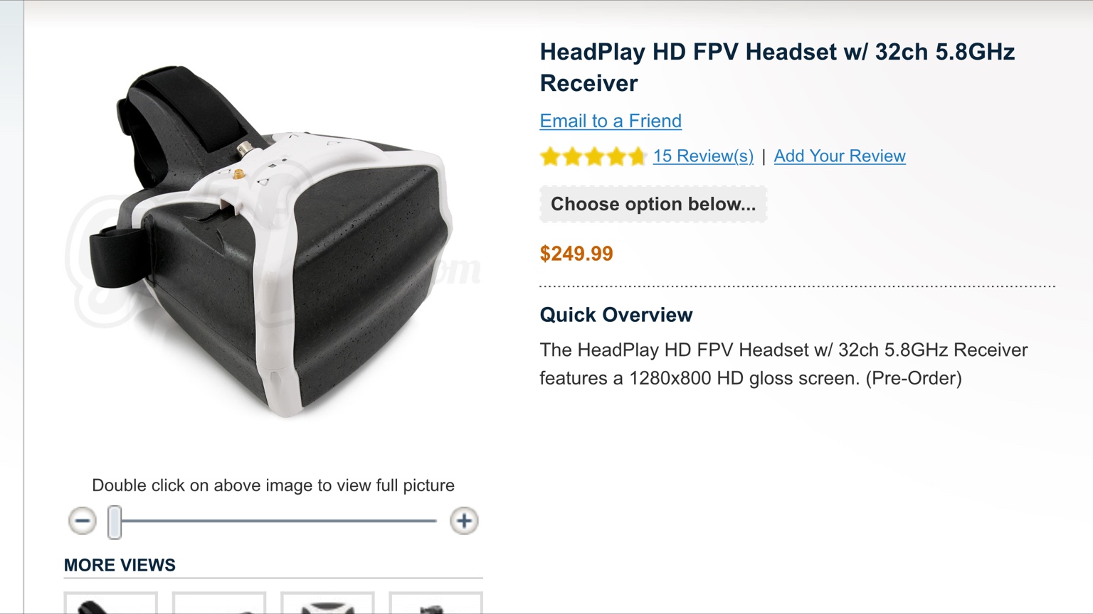

and this,
Nice FPV headsets! :cool: I only have the latter... The first costs as much as a P3P! The latter took 4 months to be delivered, after my CC was charged! :eek: Very popular!
Well, I got the first one for a very good price ($899 CAD) brand new from Amazon and right after I bought it, the price on the next one jumped to $1299 CAD and then a month later to $1399. (Haven't checked recently).
At the time I bought it (last November) I didn't even realize I could use it for FPV flying. I bought it for watching movies on long flights overseas. I sold my house last October privately - instead of using a real estate agent - and put the $15,000 CAD I saved directly into a budget I could buy toys with - so last November was an awesome month for me! Amazon was at my house nearly every day and it felt like the entire month was one Christmas day after another!
