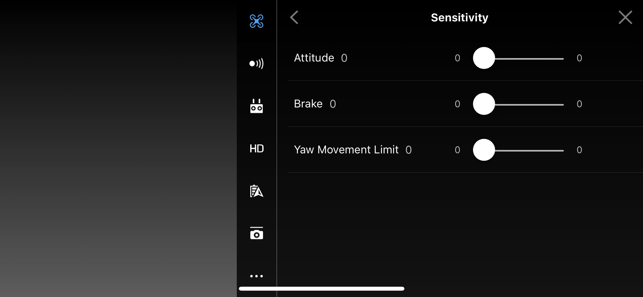

Yes, you can adjust your braking in this menu:
You could also ease off the stick slowly to make your Phantom stop smoothly.
