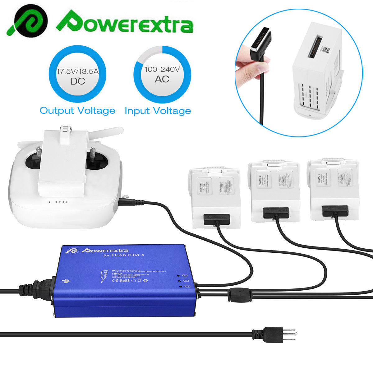

I have a Goal Zero Yeti 400 power pak. It is very versatile with a built in 400 watt full sine wave inverter, 12 vdc ports, solar panel ports, and anderson connectors for extra batteries. I have one extra AGM battery for it and if I am at the vehicle I can plug in there too. I have a dual port 12 vdc charger plugged into two P4P triple charging trays. I can Charge 6 P4 batteries in 3.5 hours. This is not using the inverter on the Yeti, just the 12 VDC cig port. I use the inverter for my 19" monitor to have a larger view screen.
If you are driving from location to location, then an inverter makes sense, as you can charge while driving and not run your starting battery down.
I have a 90 amp alternator in my Civic. No amount of drone battery charging will drain that battery while the car idles. I have a digital volt meter that reads to the 1/10th decimal point. If I'm suffering a current deficit, I will know immediately. That said, I generally don't drive around from location to location. If I'm doing a large job in the 2,000 acre range, we MAY mobilize once or twice the entire day. Even then, changing location happens fairly quickly - usually under 20 minutes. That's not enough "down time" to warrant hardware that allows us to charge while driving. That said, my business partner DOES have a 1500 watt inverter installed in his truck. So, when he's with me, we''re in good shape. I'm still getting my work flow down for large jobs that's just me, but when my business partner is with me, we have no battery issues.
In my Sportsmobile, I have an AMG 4D house battery (huge) and a Tripplite 2000w inverter. I'm covered but I still prefer to save charging to when I'm driving, when I can. I use this charger.

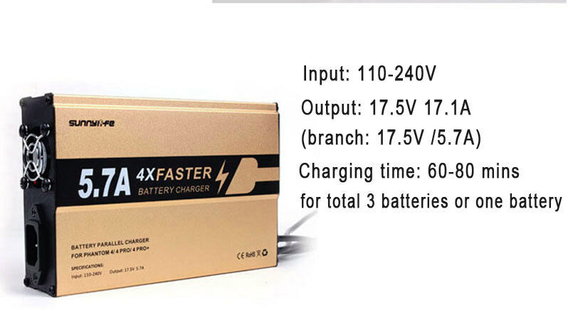

I have that same charger, but shelved it after I found this one:
Not only does it charge faster, but it runs cooler. MUCH cooler. I don't know about your blue charger, but my charger used to get SUPER hot. That tells me it's not engineered very well. The Sunny charger stays cool to the touch. Too bad it doesn't have a DC-in port. It would be perfect if it did.
