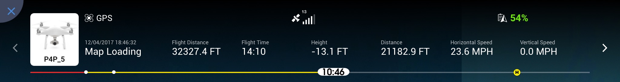

When I am 4 miles away, with only 54% battery remaining, on a flight that has already flown 6 miles total, it's time to head home because of the battery!

When I am 4 miles away, with only 55% battery remaining, on a flight that has already flown 6 miles total, it's time to head home because of the battery!
