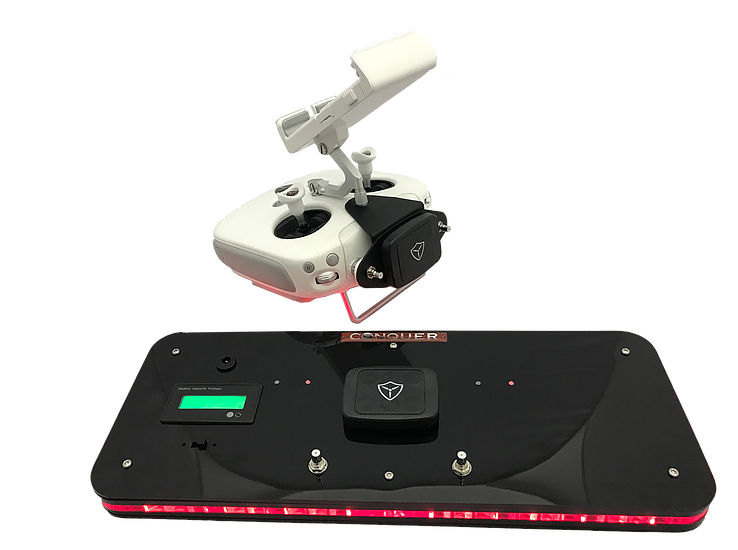

If you want real distance you could consider one of these, built in twin 3 watt amplifiers, 14 dbi panels with voltmeter , inbuilt 3000 milli amp hour battery. Conquer range extender.
Reactions: On_Bail_Cuz

Yep it will all depend on where you are, what loads there are on either frequency and objects in the foreground. There must be a hundred threads on this, 5.8 ghz vs 2.4ghz and everyone ive read says that the 2.4 ghz band will give you further distance. DJI techs also have said this. But each to his own, Brimba yes it does fit the p4p, but you will need to set your drone to 2.4 ghz, as it works only on 2.4 ghz not dual band. I have this installed on my P4P
It's there for looks, the "Halo" lights do not provide any features except when your around people and want to look badass lol, you can toggle them off or on. 99% of the time i have them off to save battery life, but when I wanna look like Johny Dangerous around people to show of my sick set up then I'll turn them on lol.
It has its own built in battery and doesn't drain the controller
Reactions: Boz
