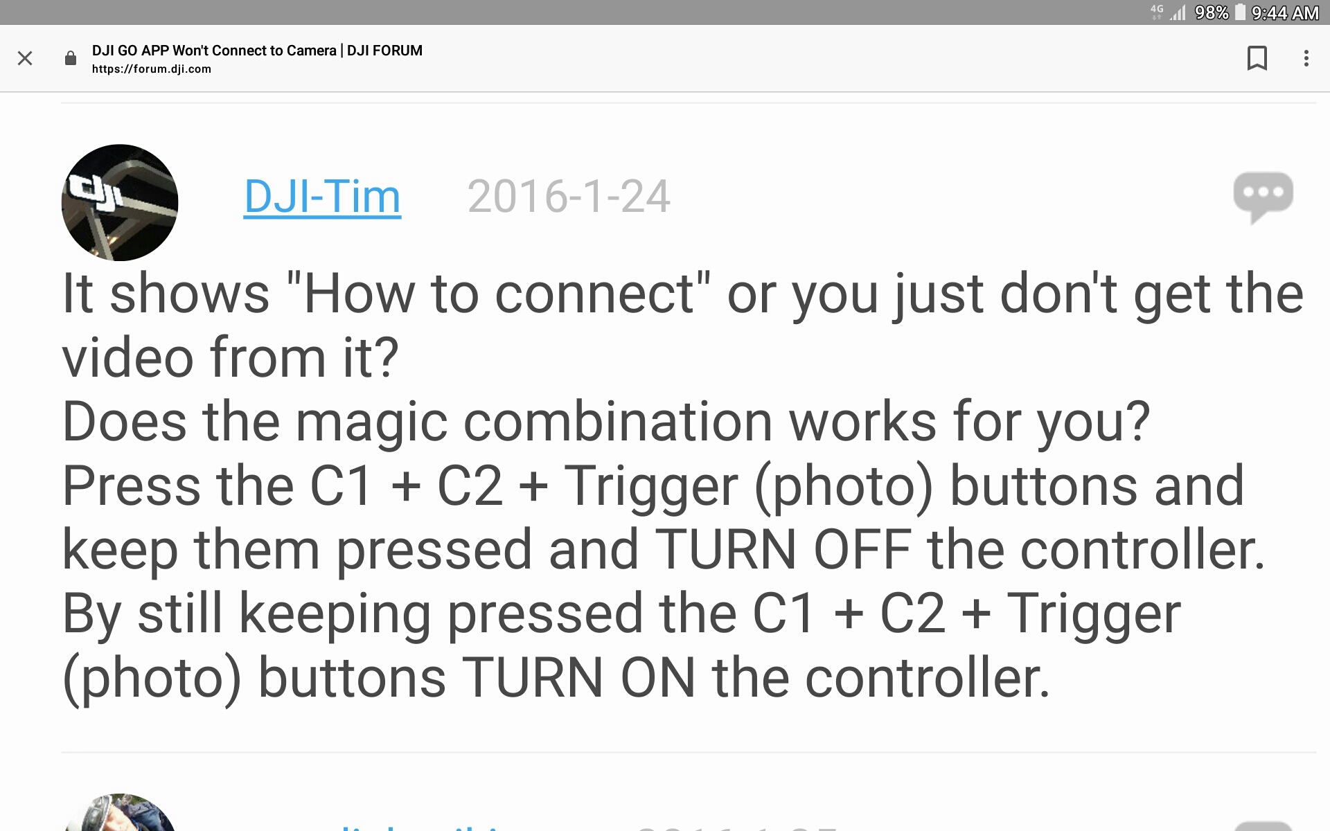

Found this post from no transmission signal,,worth a tryOh right ill have to look for new gimble board try that if not it's good spair for my other but thanks fir all your help
