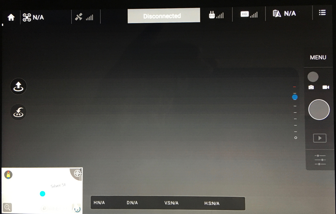

Right Lenj - what does your home screen look like? This is DJI GO 3.1.59 so just about the same as yours.

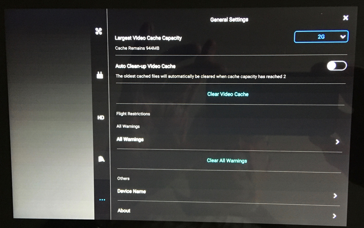

Press the three lines at top right and you should get this screen...................

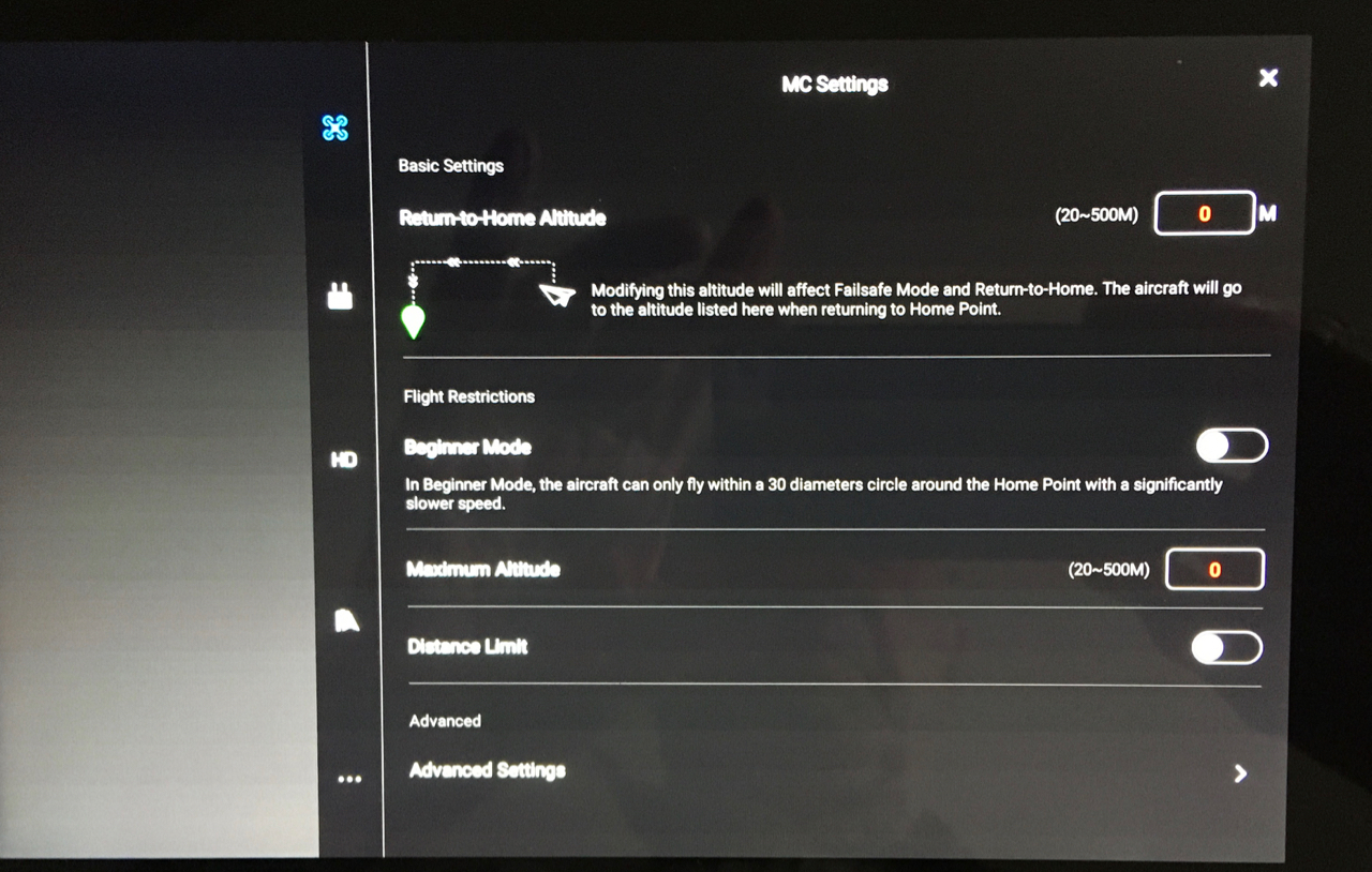

Press the little propeller shaped thing top left, to the left of "Largest Video Cache.... and you should get this screen............

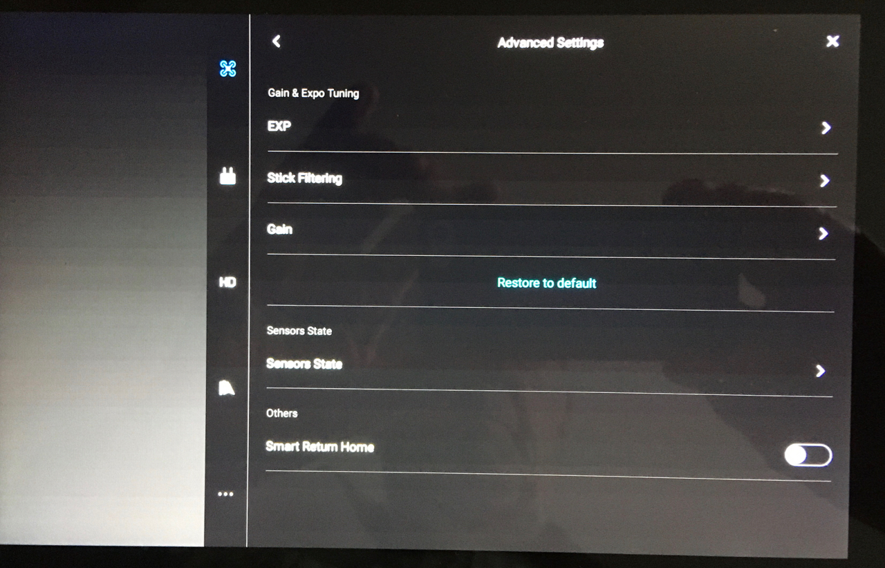

Press "Advanced Settings and this screen will appear....................

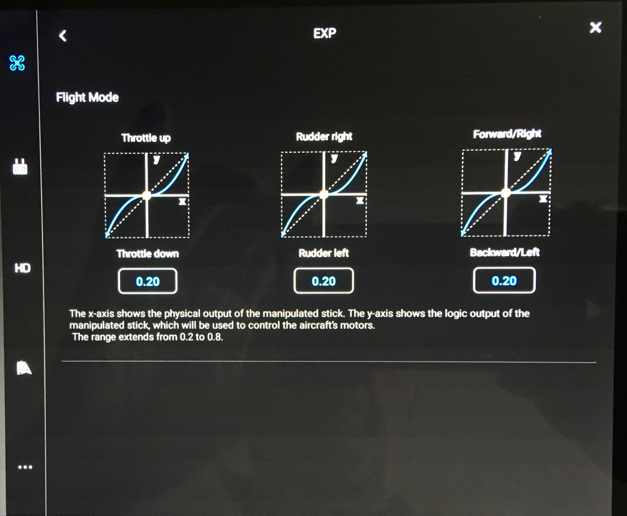

Now press the EXP and you are in the exponential screen where you can adjust the sensitivity of the sticks................
How to adjust the EXP fully explained here...... you need to adjust Rudder Right/Rudder Left.

Yes that's the one..and I have mine set to 0.30 and it works better than before not that quick snatch get away .What is yours set to?? I was a tad worried going down to far...
Thanks again - Len

No you can't go down too far as far as I'm concerned, mines set to 0.20 which I presume is the smallest yaw for the largest stick movement.
