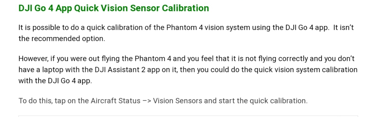

My p4 always had this,I turned them off,problem solved,,when using computer it should go through certain steps as you know but it shouldn't advance until you have completed that step ,
In dji app ,,I've never done this method either so unsure on its process but if having computer problems try this way,no computer needed,,,,it could just be a matter of quick clean on the lenses,,.....there a few clips on utube which show process ,,then you might be able to start off without getting a error,good luck

here are the instructions from DJI. Notice how he tilts the drone to follow the square. You may be moving the drone incorrectly .
