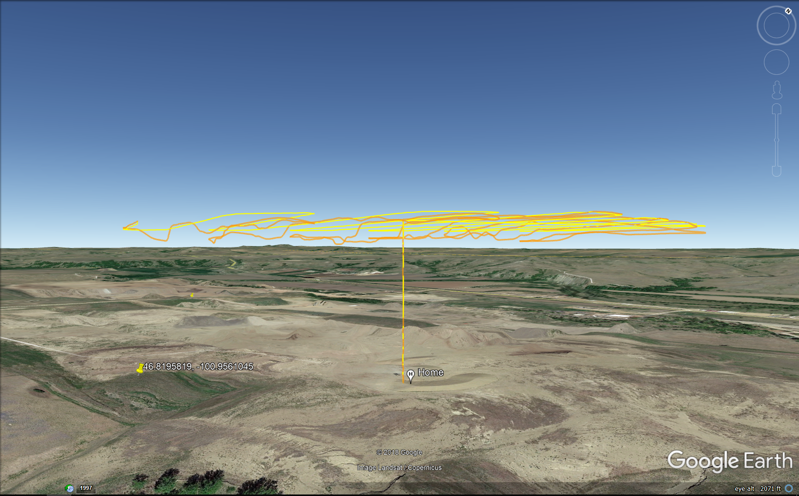

There is nothing abnormal in this flight data. There was no "battery" warning at 30% ( according to this file ). The battery was at 28% when you apparently lost signal. Also, there is no RTH in this file. The last transmitted co-ordinace was 46.8195819,-100.9561045. On another note, I do not see in this file where the home point was ever established at any time during the flight which is odd. Since I know nothing about how Map Pilot operates, I can only assume that the aircraft used a previous home point from a different mission, being that I do not see the establishment of one. If the aircraft did indeed initiate RTH, it is not noted in the file and all indications are of a normal flight, other than the oddity of no home point. Bottom line is, personally I really do not know where to direct you with this very limited data set. On a side note, is it possible that you have a device .dat file? As opposed to the synced .csv? That may provide additional information.

I also just compared the AirData .kml flight lines (yellow) to those provided by Map Pilot (orange). And it looks like it was having a hard time holding its elevation, but I don't see that shown on the CSV.

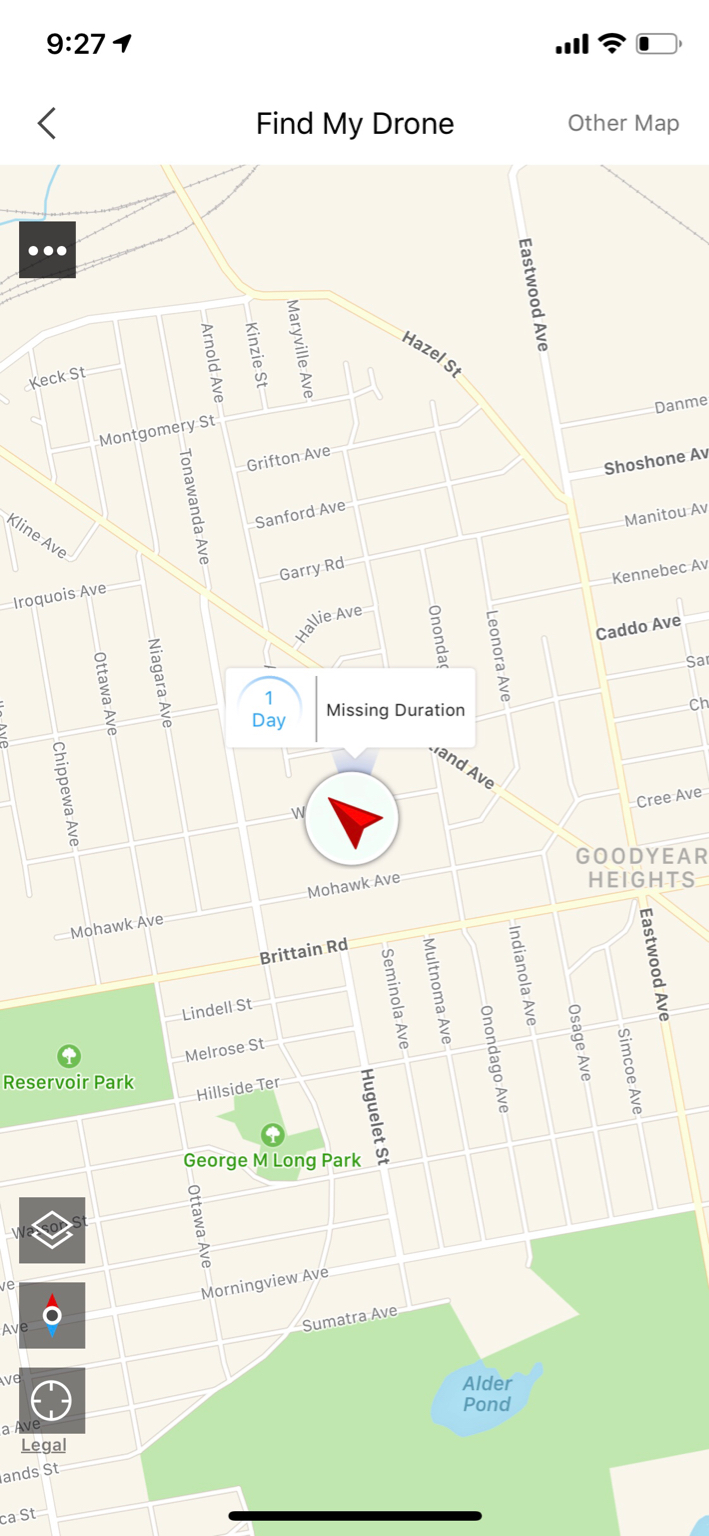

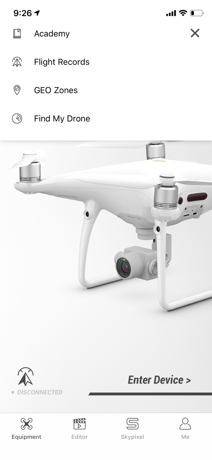

Open the DJI go app and click on the three bars in the top right corner and a drop down menu will appear. Select find my drone and it will show you the last location of your drone. You can also used maps on the iPhone to take you directly to it.
No - it won't do that if the GO app was not used for the flight in question.
Is this anywhere near the Bermuda Triangle, this could explain it? Merry Christmas Everyone
We did try using the find my drone function, and if I remember correctly it either showed the last location recorded in the flight log, or the home point in the gravel pit. I’m starting to wonder if maybe it landed at those last known coordinates, but we were focused on looking for it to the South and missed it. Merry Christmas everyone!
